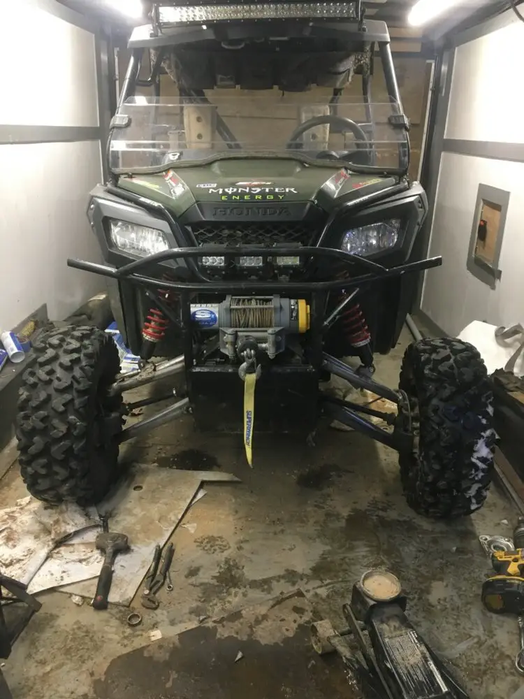

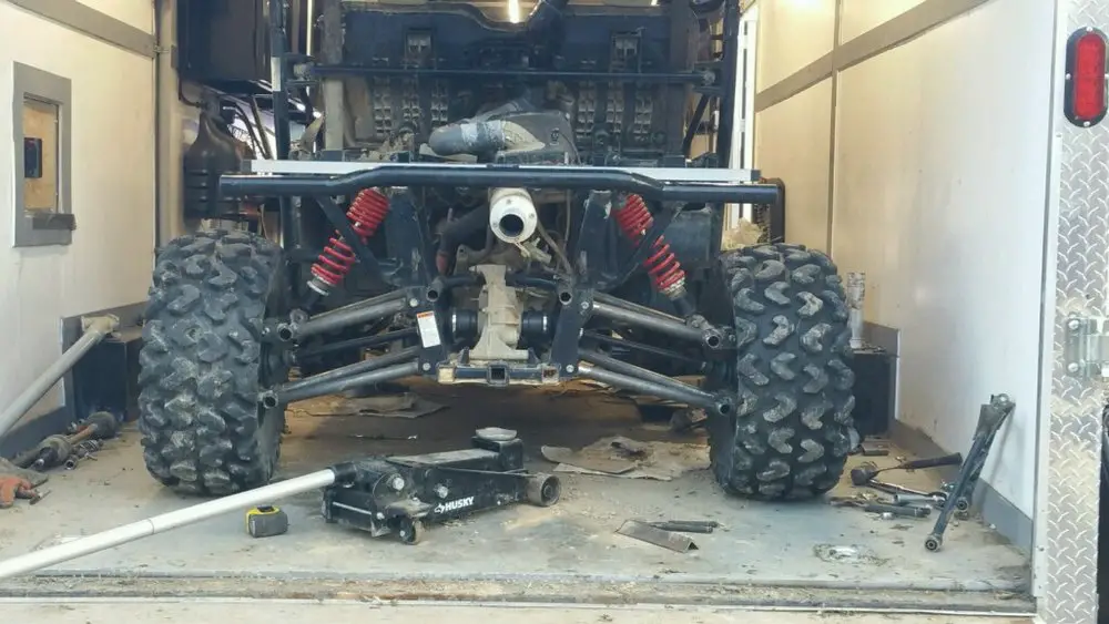

60" outside to out side and the kit will be front and back
And it looks like you are running some increased offset wheels? So on stock wheels we might be looking at 56-58 inches? Looking forward to this!
the lower ball joints will not clear stock rims without a spacer

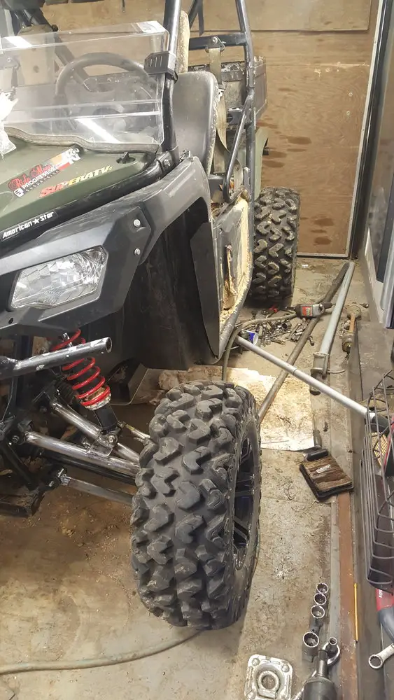

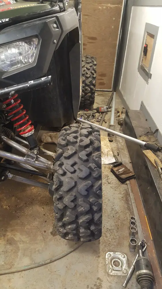

new tierods cuts and threaded and longer brakelines
