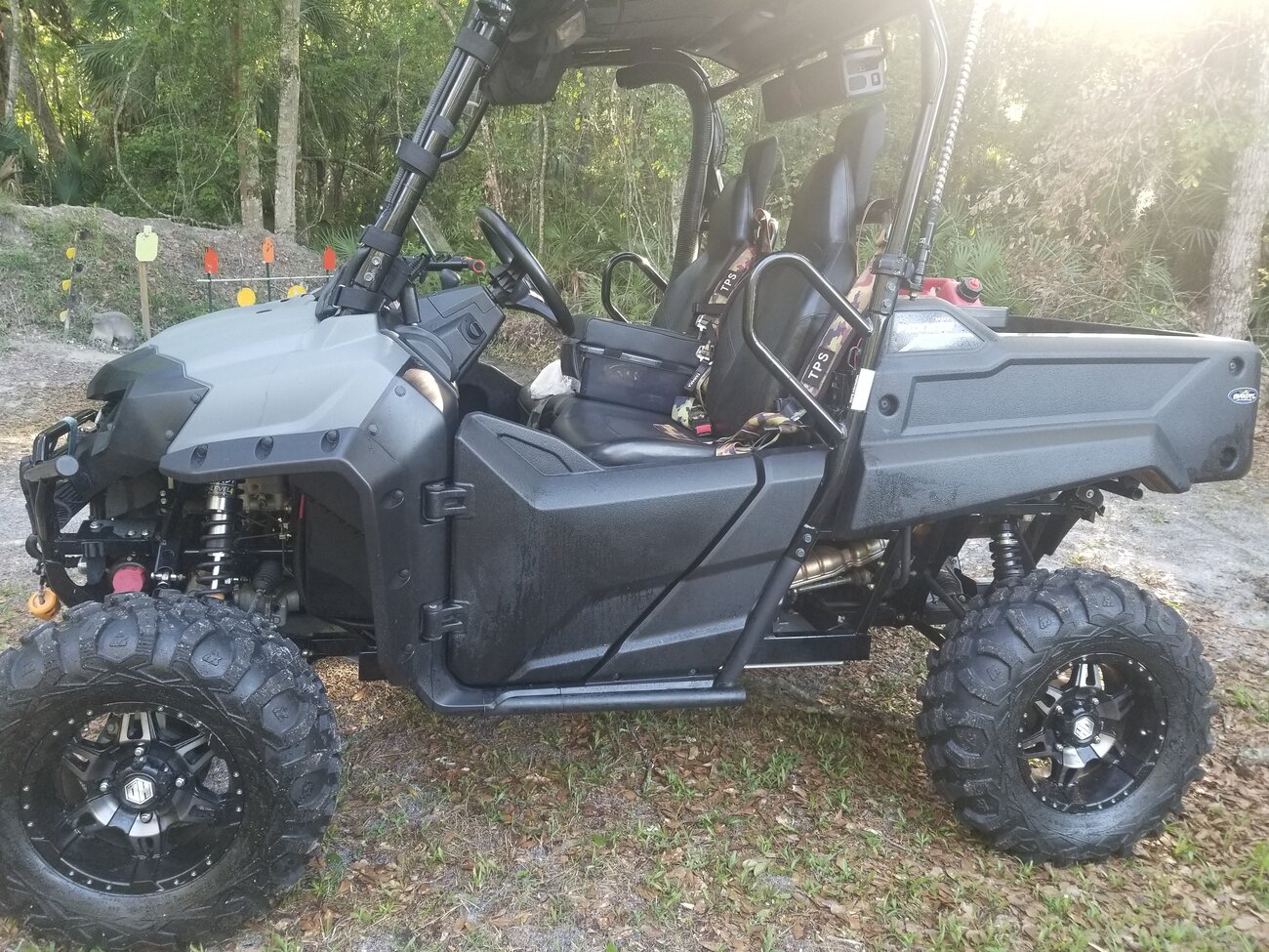

Well got it all put together wasn’t too hard. Here’s the list -
-Moorhead racing forward arching A arms
- wheels 14 inch tires Vampire 2 27” very aggressive heavy though
- Fox podium 1.5 shocks adjustable very nice shocks well made great ride 3 different setting. Got about 2 inches of lift.
- lower Keller ball joints. I returned the uppers. Should have just left stock but they’re well made and serviceable
- instead of the rhino axle I took apart and cleaned out the cv and put the oem Honda boot kit on a collapsed outboard boot needed a pair of Oetiker boot clamp pliers good tool to keep or lend to a friend
- super Atv rear high clearance a arms.
I learned a lot from this forum. Made some mistakes but that’s how you learn. Very happy with my P7 got about 13.5” of clearance at the lowest point. It can keep up with the Rubicon and the outlander now without getting stuck( not in speed lol ) . I own a large tract of land in the Adirondacks upstate NY and ride old logging trails skidders used to ride on with huge boulders in the middle of the trail. Cut down about 30 small trees this weekend and dragged them with the P7 to the burn pile . Didn’t use the winch once. In the past I’d use the winch 2 times a day easy.
