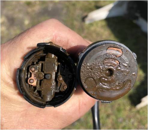

With it being a 2014, check the ignition switch.
MANY older 700's had a switch problem.
The design would let water/condensation in, with no way for it to get out.
"But Mark, I've never had it that deep."
Notice, I also said condensation. I don't think the one below was in water either.
This one would start and run with no key in the ignition.
He came out to his garage, and it was running, no key.
Bad switch
The link is to another forum website, but that is the original story.
If the link doesn't show up, google "2016 700 started by itself"
Read his story, very similar to yours.
Post back what you find, maybe it will help the next guy.
Have a good day
Have a good day
