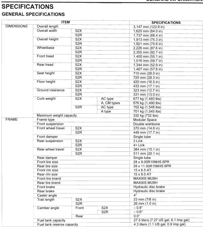

Here are the specs from my manual.
It’s 11 feet. From what I looked at in the brochure the R just fits, but that was a drawing that I wasn’t too sure about.

Stock is 10'4" That will be tight!

Their both the same length according to Honda. My GM has a 12 foot garage on his toy hauler and it fit pretty easily length wise. It was just short enough to fit with 32" tires rubbed the porch netting hanging from to ceiling.
Hes running stock bumpers for now, no accessories except for some underside protection stuff.

My 1000X has the Honda optional steel bumpers on the front and back. I have personally measured the vehicle, bumper to bumper, at 10' 8" (128"). The book specifications probably apply to the vehicle sans bumpers. Hope that helps.
Steve
20,249
115,738
