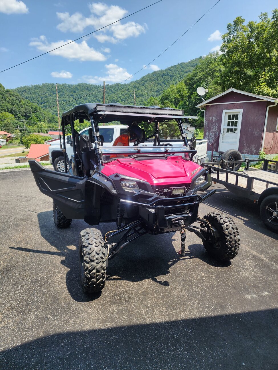

I live in Florida and primarily ride in mud. I have a 6" SATV big lift kit with the longer arched A=Arms, Rhino 2.0 longer axles, HD Ball joints, the bracket lift it comes with, etc... I have also added dual idler 4" billet portals & frame stiffener and run 35" outlaw 3 tires on my 2016 1000-5 EPS.
I was hoping someone knows of a way to be able to remove the brackets for the shock mounts on the SATV 6" lift and keep the long arms/axles. I believe if I remove the brackets and try to connect the shocks to the stock mounts up top on the bike they will #1 be too short and #2 possibly hit the cross support on the arms in the rear. is there a way to circumvent this and turn the big lift kit into a long travel kit by modifying either the location of the top shock mount or modifying the arms? Also, what shocks would you recommend trying if there is a way to make it work and the stock shocks won't cut it... Every since I added the brackets with the 6" lift kit, it rides like a horse drawn carriage, I was thinking that removing them would really help the ride.
We went on a trip to the hatfield mccoy trails last week and I threw on my 27" tires to avoid destroying my 35" Outlaw 3 tires and lower the center of gravity but the gearing was so far off for the smaller tires. I'd like to be able to lose the brackets and increase the tire size to improve the ride and ratio with the portals. The width was awesome and helped considerably. Right now with all my mods, I think my width is about 81" If I could keep that and lower the lift, I'd be stoked. I'd like to keep the portals for the gear reduction and ability to run bigger tires... like a 35" XCR 350 when we do those types of trips.

You got any up close pics of the suspension set up?

Never really had a reason to modify the shocks or care much for the ride. We slow crawl around through the mud down here in Florida. Articulation and riding for miles on end hasn't been a concern. Riding the trails up there and riding 70 plus miles in a day opened a can of worms for me. I'll grab some close up pictures of the suspension but as someone else just said with the bracket lift that came with the SATV 6" lift, they are straight up and down almost. You can sort of see it from the picture I posted above. If I can just order custom shocks to be able to remove the brackets in front and back and keep my existing arms and axles I'm all about it. My buddy bought 814 shocks and loves them. he has the same lift as me but running 40's and 6" portals vs. 4" portals. He still has the brackets installed though. My other friends have WE on their polaris and like them as well. Quite frankly, the ride can't be much worse on my buggy, so whoever makes the right shock and length I need, I'm all ears! Any ideas? I'm sure someone has done the mod before....
Here's the picture of my normal setup (my avatar pic)

I think you're going to end up moving the lower shock mount out to make a longer shock work but there's a good chance you can find a longer yxz or RZR shock that will fit. You'll probably need a stiffer spring a but just about any shock would be an improvement over stock.
For the front, I'd measure from the stock upper shock mount to the lower a-arm mount and see what it looks like at your current ride height. I'd guess its 21-22". This might not be a cheap adventure but I think you'll end up with a 300-325lb/in spring and a shock about 3" longer than stock
in the rear you're going to have some clearance issues. But a better pic would help
