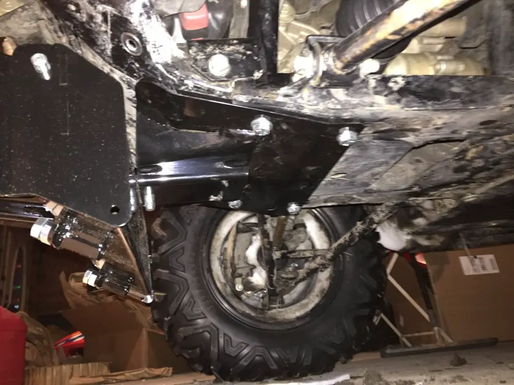

Got the parts in I ordered....so was able to put it together and get er mounted...
IMG 6075
Mount was simple to install 4 bolts with washers and two spacers...
IMG 6071

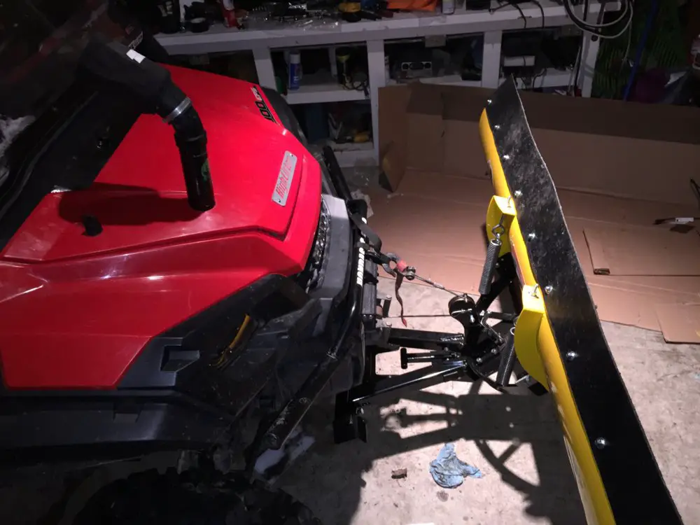

She squats the front end when lifted...IMG 6073

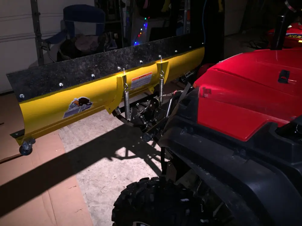

Got to test her out today with the Moose RM4 snowplow system
Reactions: CumminsPusher
322,957
She pushes nicely! That's almost cheating lol
Reactions: Eltobgi
