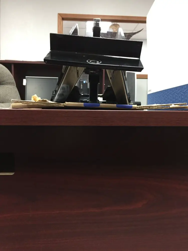

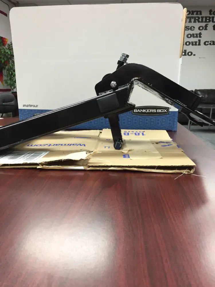

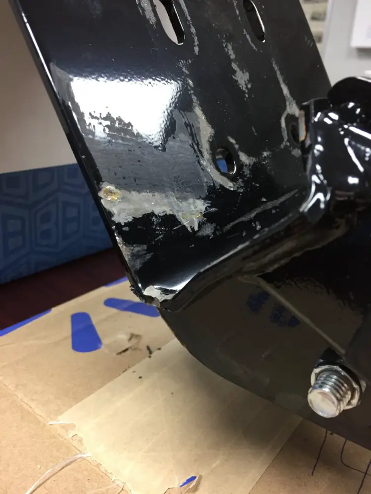

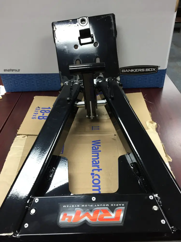

Quick Update on the Moose RM4 quick attach plow system for the 1000-5:( The 1000 is too much machine and has too much power for this plow system (per customer service @ Dennis Kirk). Pushing as recommended with the blade angled puts too much force on both the frame mount and the push tube structure at the pivot point. These are photos of the disassembled push tube...
View attachment 30347 View attachment 30346
Notice the flat part...it should be parallel with the desk top.
Dennis Kirk's customer service is second to none. They didn't try to get out of the warranty and offered to replace with en exact match at no cost, but explained the Honda 1000 is too much machine! They did state it is fine for the 500 or possibly the 700. They stated however that they could not replace it if it happened again after sharing this fact with me! They continued on to recommend the HD Push Tubes and Bottom Frame mount as a better fit for the 999cc powerhouse 1000;).
I boxed it up and have sent it back at no cost to me and will receive the new set up next week. Hope this helps someone from going through the same thin I have!
