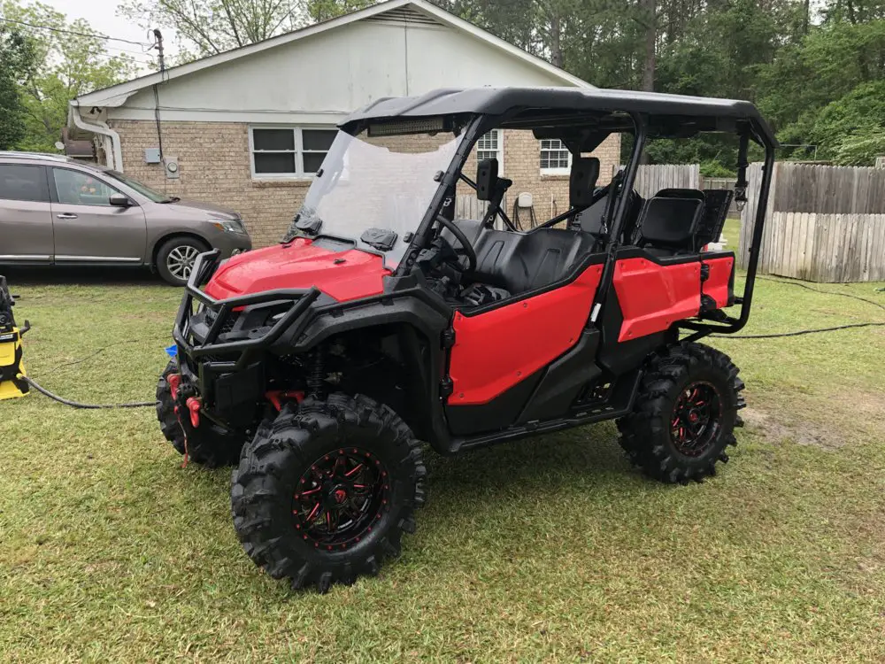

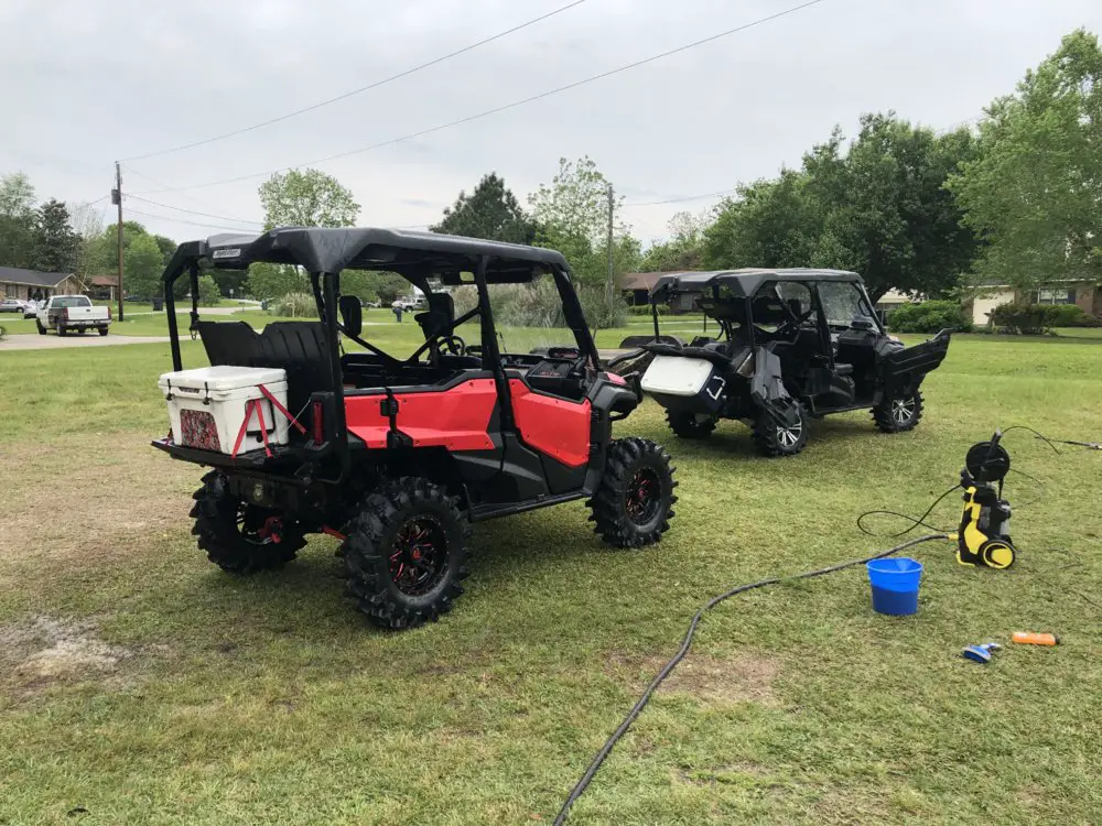

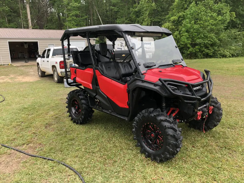

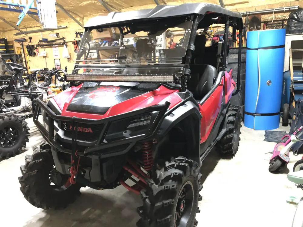

Update on my 1000-5.

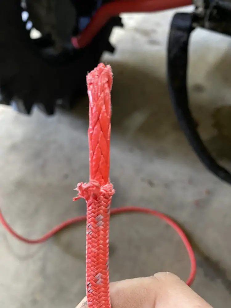

PCV is removed and Pioneer has been doing good. Broke another winch cable at last ride. Had 1/4” x 65’ so went up to 5/16” x 50’ to see if it holds up. Definitely full spool and took some work to get on there but i think it’s a stout cable.

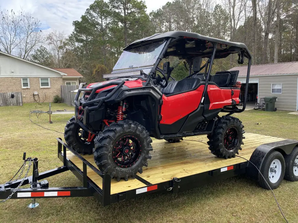

Also got me a new trailer finally. 7x20 car hauler big enough to fit mine and my buddies 1000’s if needed. Love the setup and I don’t even have to use the ramps, just drive it up the dovetail. And the stake pocket inserts with D rings are awesome. Switched to wheel straps too and love that setup.
Everything else is about the same. Few pics from our last ride.

Is that the one that I broke too? It looks like it. I went with Amsteel and haven't had any issues since. Looks like yall had a good time :D
yep same one you broke. I went up to 5/16” one with 20k break strength vs the 7k if the other. If this one breaks I’m definitely going Amsteel but this one looks very good
