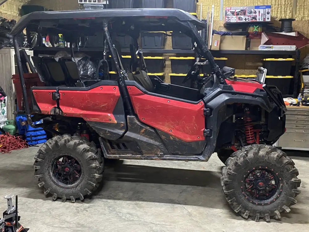

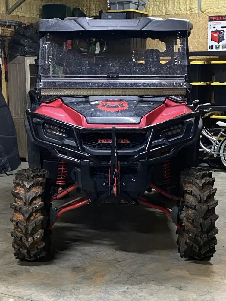

Another good weekend at the lake with the Pioneer.

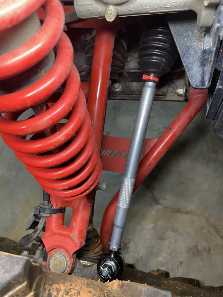

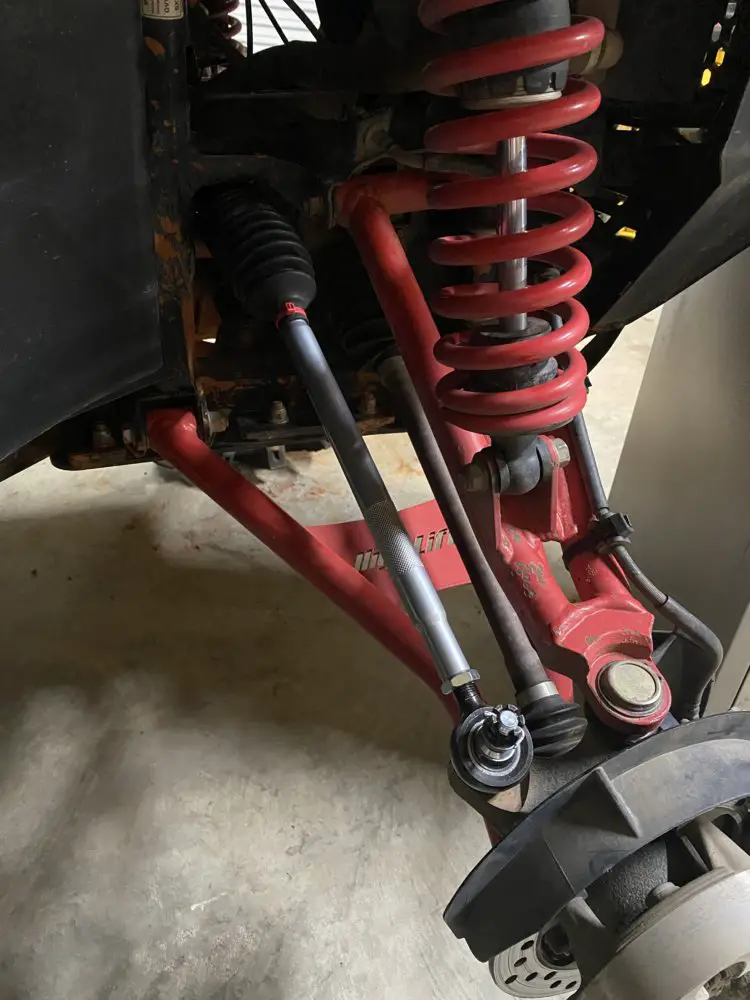

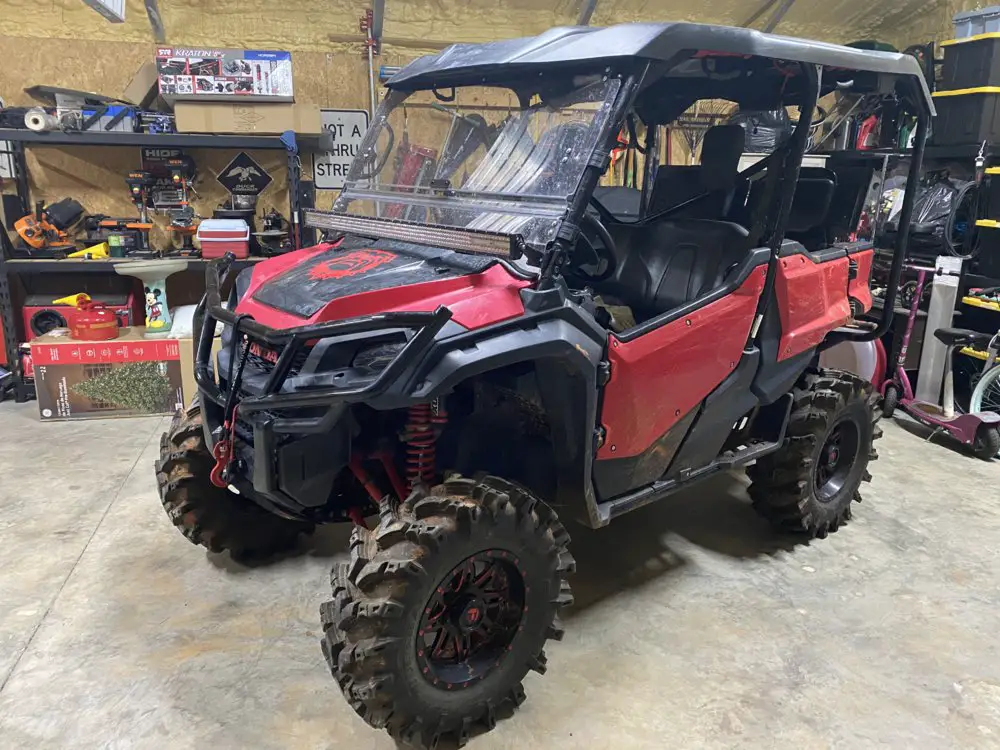

SATV HD tie rods in finally. Yeah I know I need to clean it from last weekend, just haven’t had time
D2CE0E86 D766 4F11 8D7E BA9A871E7EC9 529000A9 F000 45E5 A256 358B989E486C 29724028 A7D7 4170 9D0B 6A498C990A16 3F7B05DD 5748 4A2B B90E 86FDB5DFD849
aauman88
aauman88
Feb 19, 2019
1,091
2,846
So far yes I love them. Seem very well built and fit is great. Haven’t tested them yet but if I have any issues I will report back

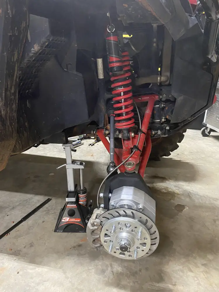

Not sure if will notice difference or not but I upgraded exhaust so figured I would do all I could to let more air in too. Smallest point of stock plastic is 40mm and smallest point of billet one is 48mm. Can’t hurt I guess 🤷🏻‍♂️

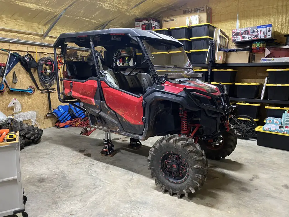

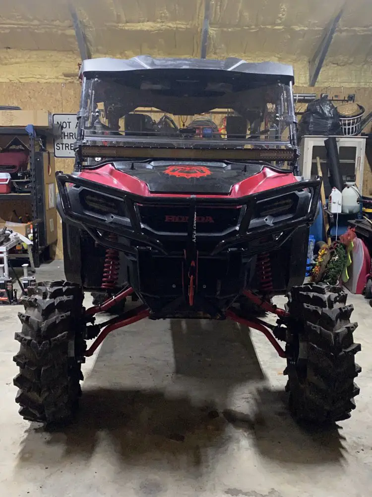

Found deal couldn’t pass up on the portals so they are ordered and on the way. 4” 30% so will remove bracket lift when installing. Should be a whole new beast

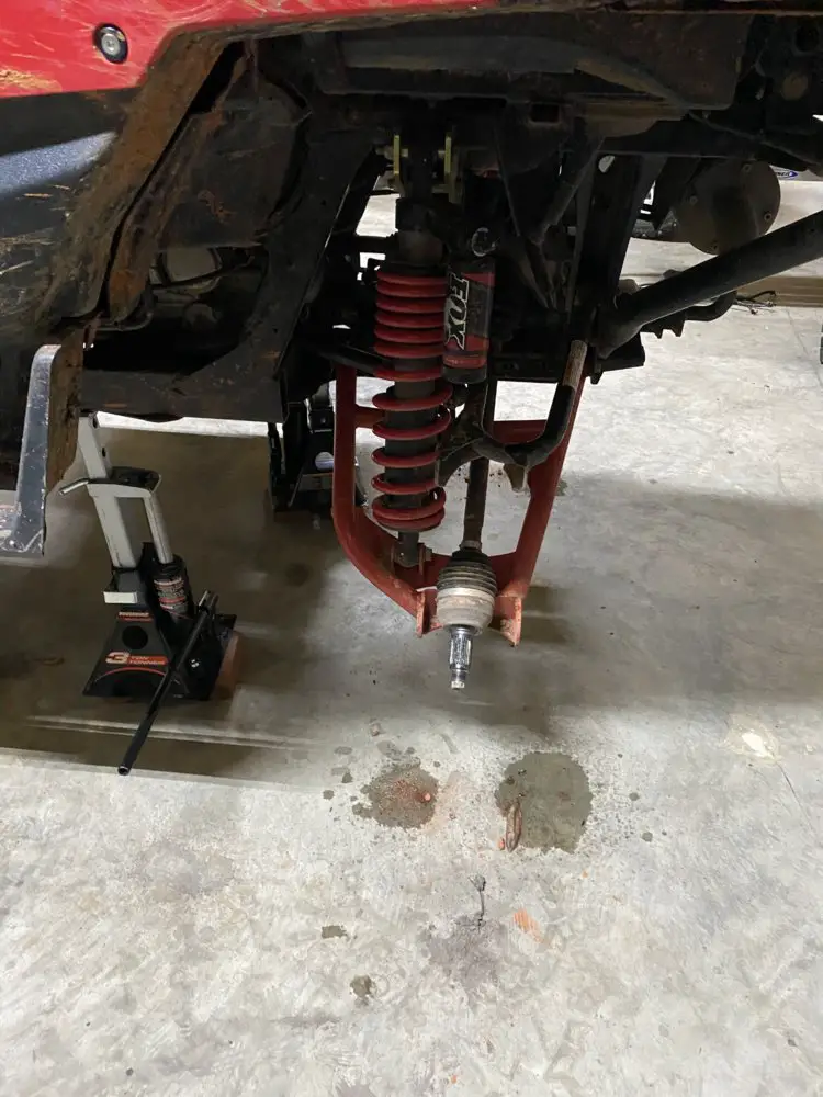

Front is done and haven’t touched rear. I didn’t want this much height so I will be adjusting my shocks or removing the bracket lift. Going to get rear done and decide. Just need to do rear, fill all portals and get brakes bled

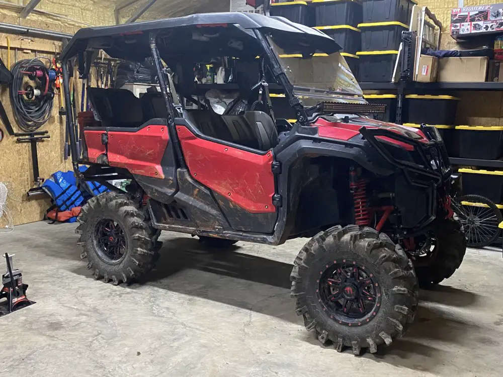

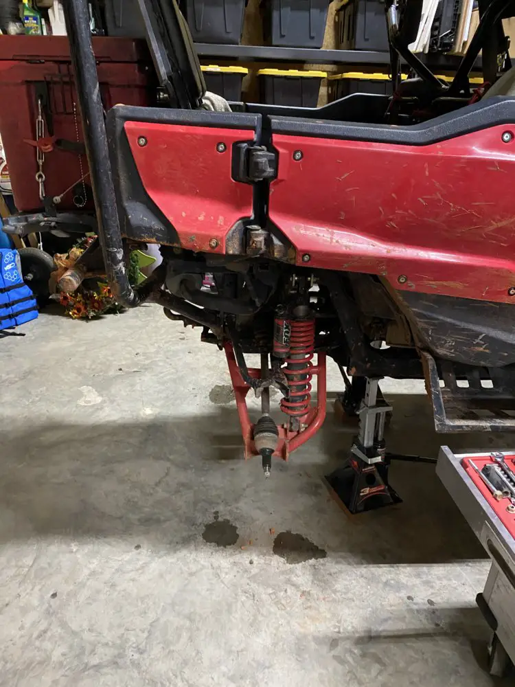

Like the new dash plates that came today from guy on FB. Rode around for a few to check operation and everything is operating fine. Turning radius sucks but I have new steering brackets to install that will help because then I can remove steering stops. 22” clearance now
