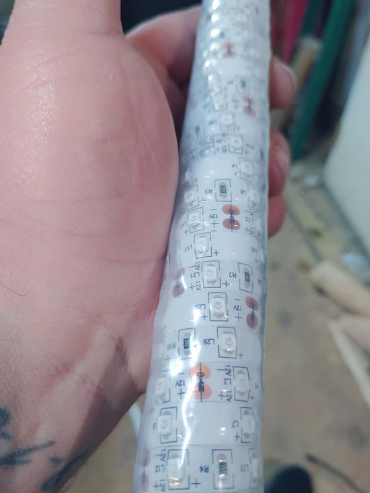

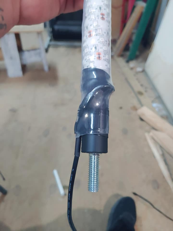

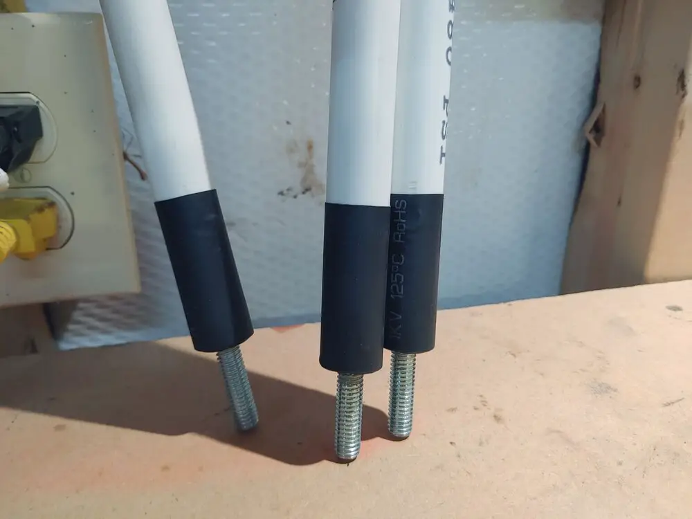

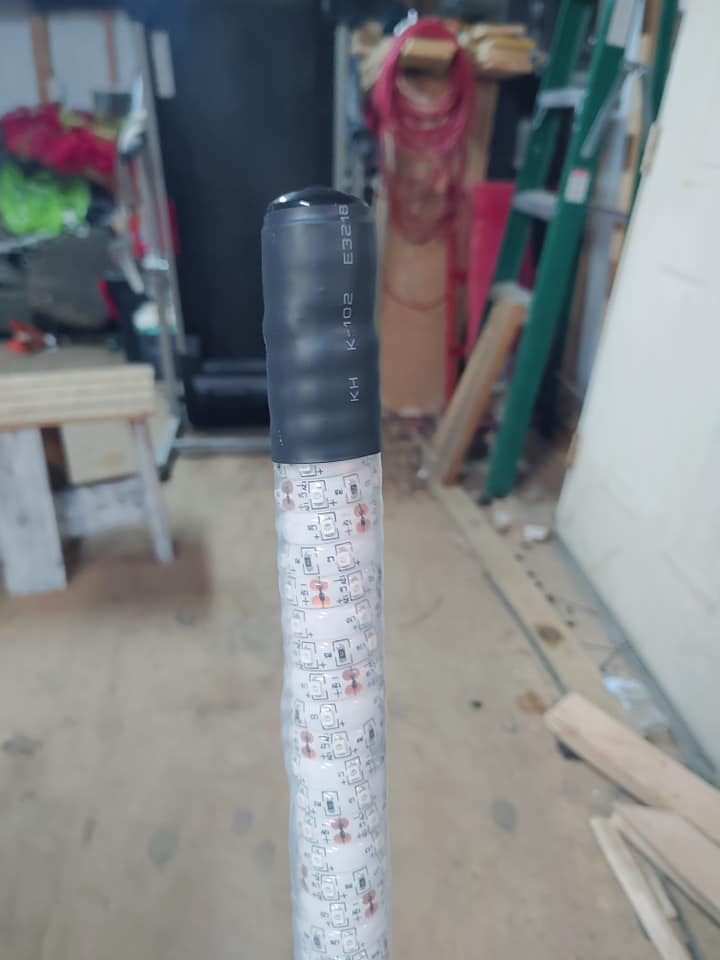

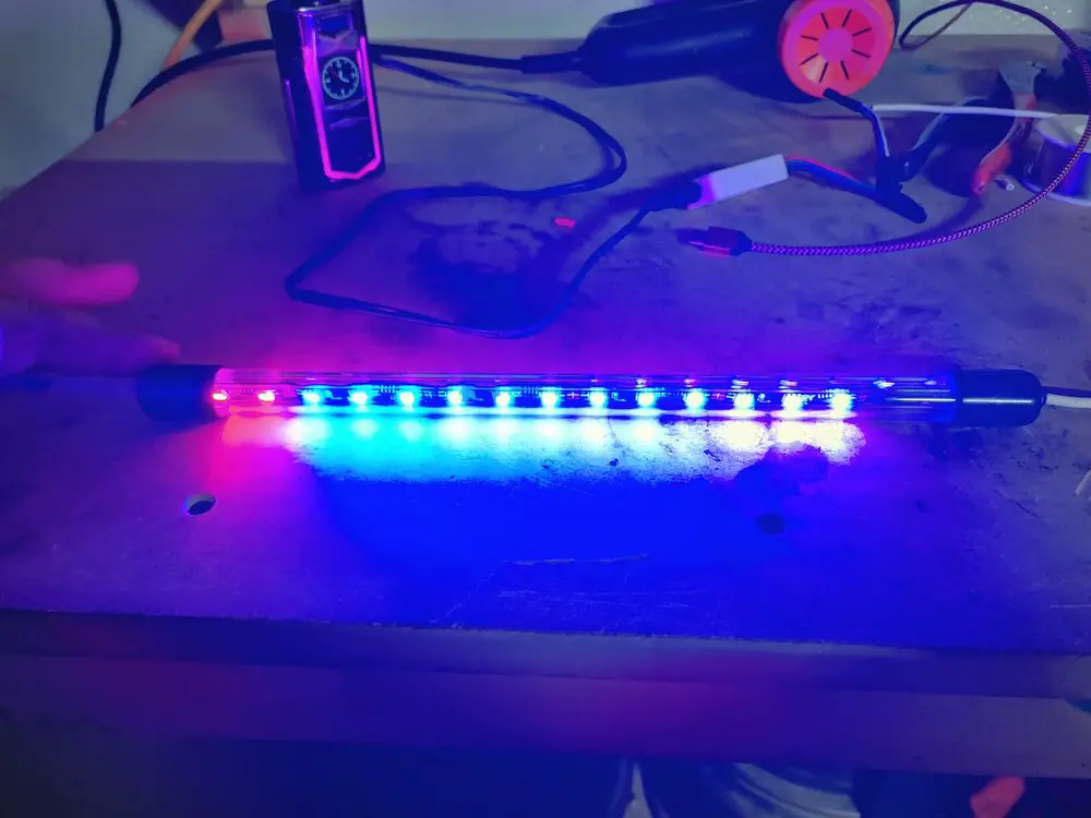

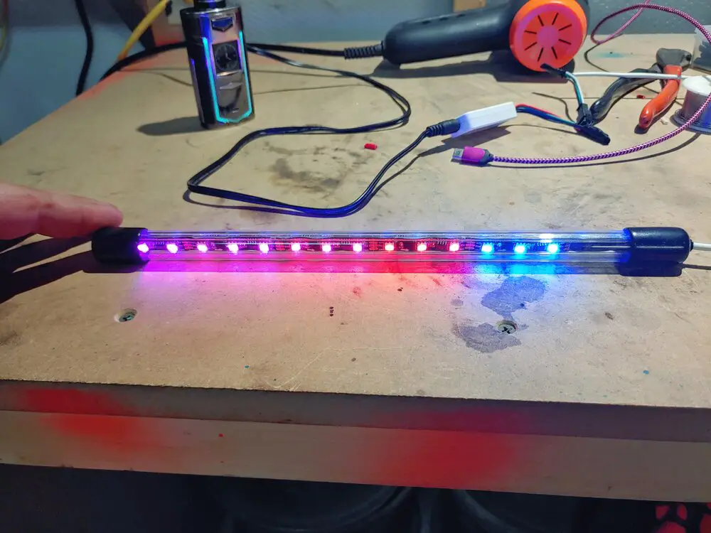

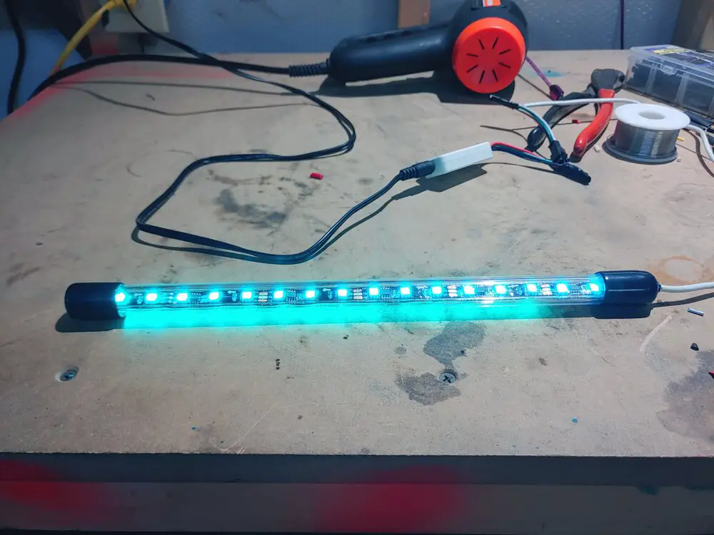

I tried some different things with the blacklight whips i made last night
These caps fit 1/2 sch 40 pvc perfectly
I got this to test the larger sizes and learned that 30mm heat shrink wraps over the wiring nicely and seals up around the top cap/top of the clear heatshrink, and 20mm fits the bare pvc nicely to hide the white at the bottom better than painting it if you put it on first.
If using ip65 waterproof led strips this 35mm crazy thick heavy duty heat shrink did a pretty solid job
View attachment 232707 View attachment 232708 View attachment 232709 View attachment 232710 View attachment 232711 View attachment 232712

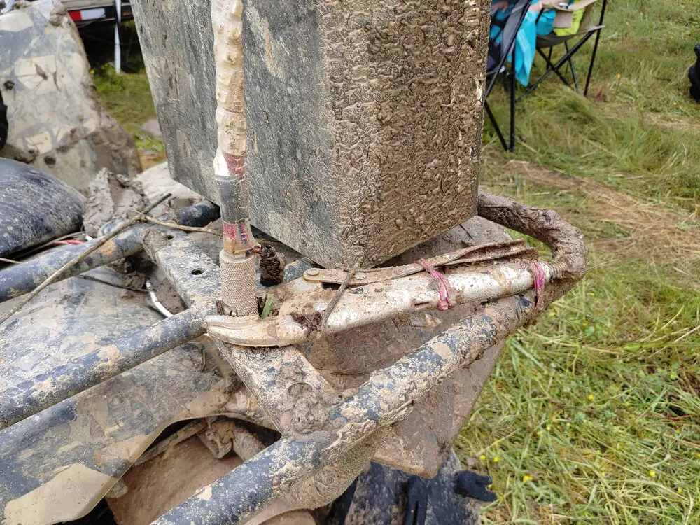

NOOOOOOOOOOOOOOOOOO I totally missed this link, DO NOT USE THAT QUICK RELEASE!!!
The external wings bend if any force gets applied to it... I left those vise grips holding it like that for 6 months before i just recently took it off and bolted my whip straight to the rack.

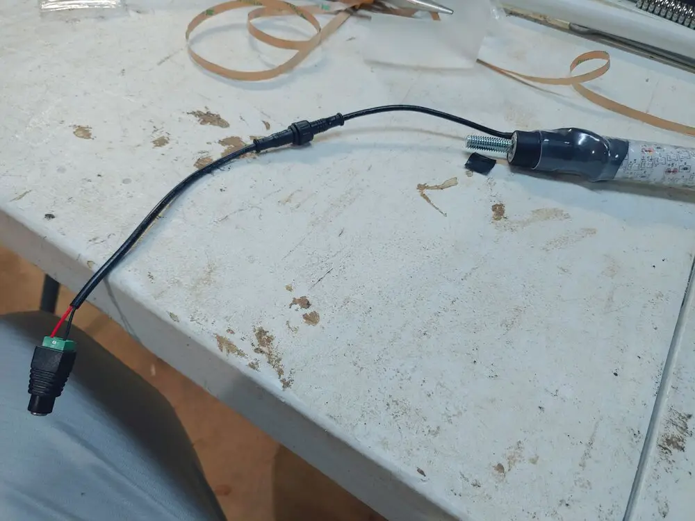

Try this one instead
I just ordered the bases you recommended. I will return the tram bases to Amazon. Do you know of a better mount than the nilight mounts? Mine seem like they still move under load like they bounce on the bolts and I feel they will break again.

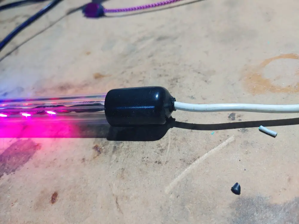

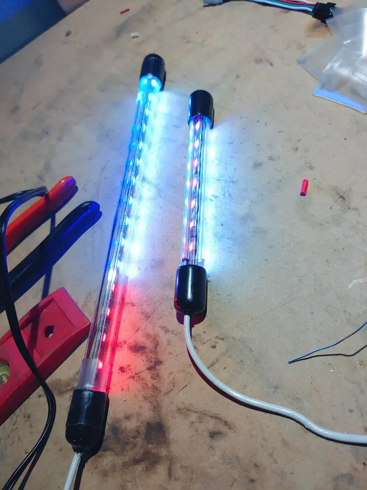

Where did you find the clear tube for the rock lights? Do you have a picture of them installed to see how bright they are compared to like the single led mounts.
These i made inside a tube i already had from a few years ago. We bought some cheap ebay whips for our 3 4 wheelers we were running at the time. Just to be a bit flashier than a bike flag the park required for entry.
End caps
I have this tube coming in today to see if it will work too for another set
I had one of these extension cables from the original whips i built so using 3 of the 4 wires it slips right through my end cap by burning a hole in the center with the soldering iron. Filled both end caps with clear silicone before putting them on to seal everything up
I have no clue how bright they will be on my wheeler yet as i finished making them at 1:30am last night and haven't got to install em yet

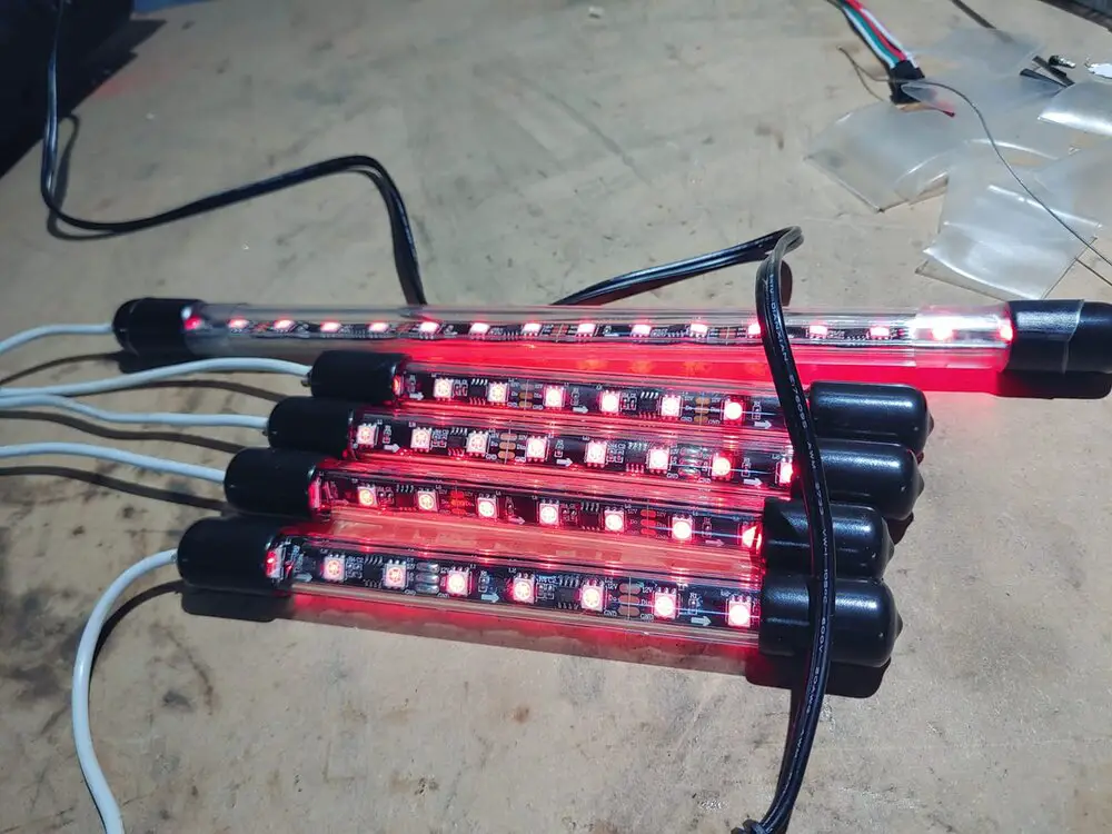

Finished up my rock light project. These are all WS2811 12v led's. Not as bright and crisp as the 5v WS2812B strips but i made the rock lights out of garbage scraps just to see how it would do before throwing them away. 123255899 3719116421431787 5278974667594434484 o 123528570 3716718695004893 6788303154308997290 o

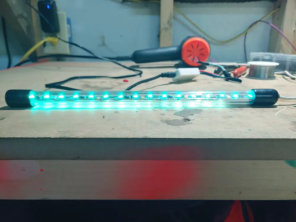

Amazon strikes again, new delivery today for the next set to come off my work bench. 35mm Fishing rod grip heat shrink is awesome to add a little texture to the top and bottom and seal everything up.
IP65 waterproof WS2812B Eco strip
35mm Clear Heat Shrink
Running it on a 5v 6amp converter. Seems to do alright so far.
123508337 3724876747522421 2147943894946474870 n 123544805 3724876940855735 8705419239173230143 n 123773624 3724876870855742 5688043562732805663 n 123799691 3724876690855760 4995200894794292576 n
