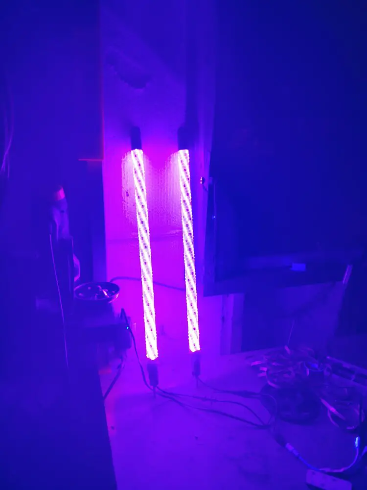

Almost finished wiring up my DIY whips. They look really good so far except for the base. If we could find a good base solution on the cheap I think these would look every bit as good as any of the pricier prebuilt options out there. I've been thinking of using quick disconnect air fittings, but that'll be for the next set. Taking my time wiring these guys up.
PXL 20201027 225438362
In researching all the LEDs and pieces and parts, I came across some nice prebuilt 3' pairs with RF and Bluetooth app control for a good deal. I'll be testing them out soon and hopefully be able to offer them for sale.
DIY on right, prebuilt on left.

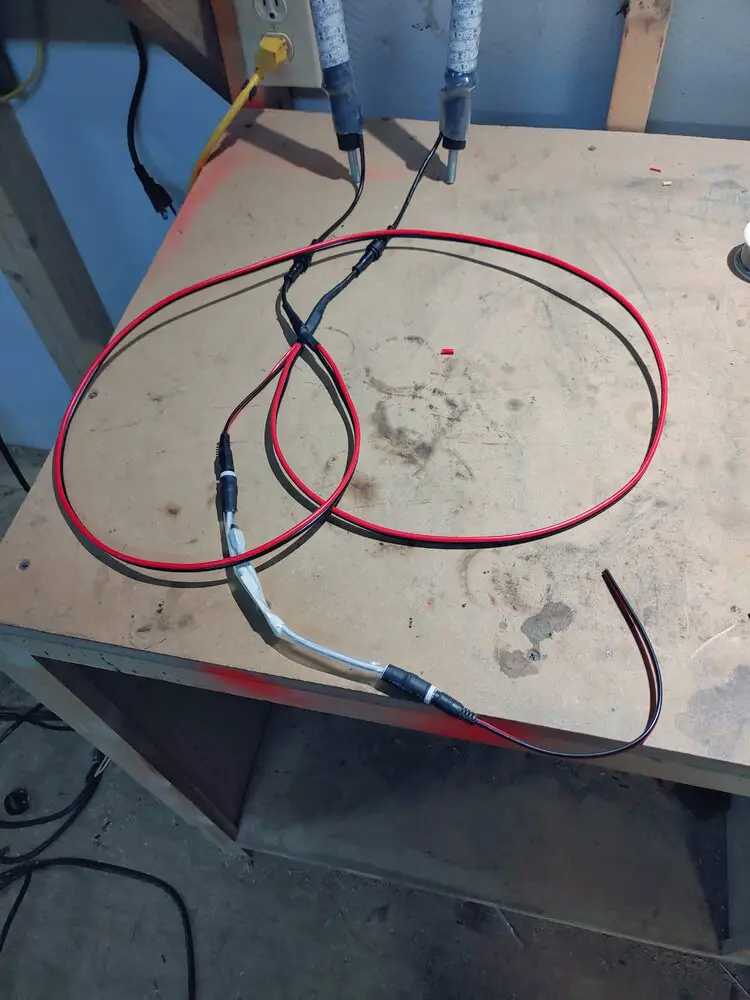

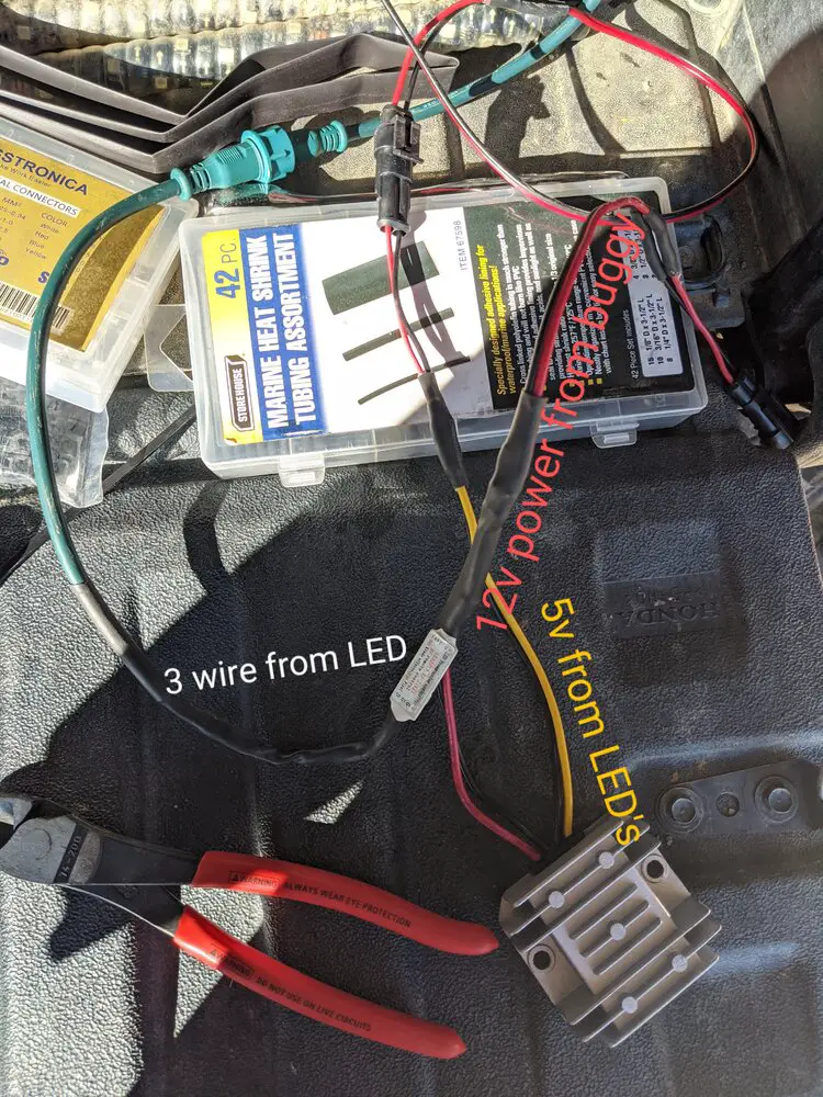

@SuperMidget - I finally got all my wires run and everything hooked up. Flipped the switch and only one whip lights up? Then as I was playing with the remote I noticed that the wires coming from the controller to the 12v power were so hot I couldn't touch it. Unplugged everything...
Does the controller need to be on the 5v side? I have it wired into the input side of the converter. After wiring in a new controller into the 5v side I got nothing. Checked and it's only putting out 1.85v on the 5v side. Guess I fried it? Thought I may have a short but everything was wired correctly and solid. Maybe I just got a dud converter? It gets super hot.
Battery into 5v transformer, then transformer output out to controller.

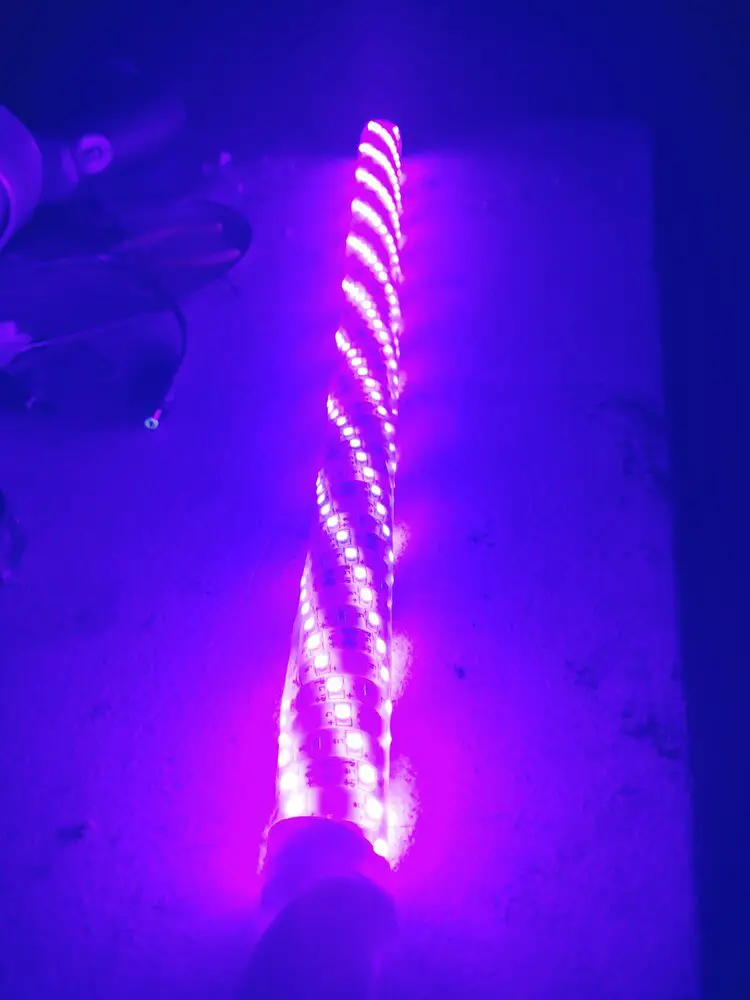

Knocked out a blacklight set tonight for a friend. Should look pretty sweet once installed. Going on a rzr along with 8 blacklight rock lights.

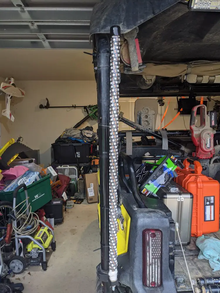

NOOOOOOOOOOOOOOOOOO I totally missed this link, DO NOT USE THAT QUICK RELEASE!!!
The external wings bend if any force gets applied to it... I left those vise grips holding it like that for 6 months before i just recently took it off and bolted my whip straight to the rack.
Try this one instead

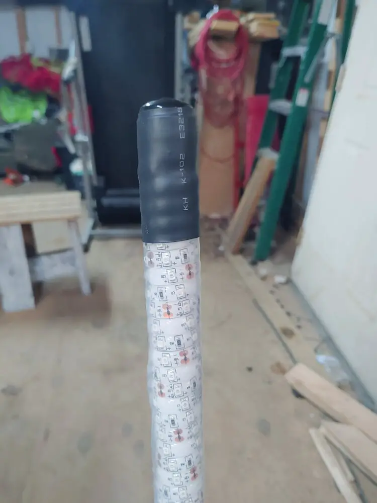

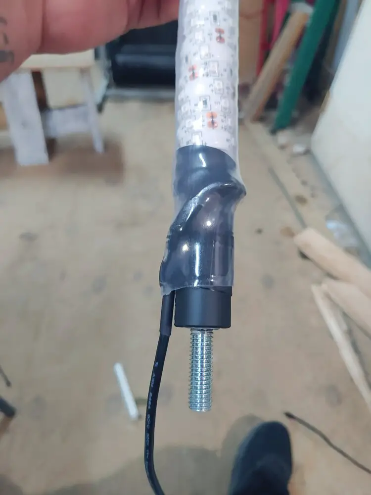

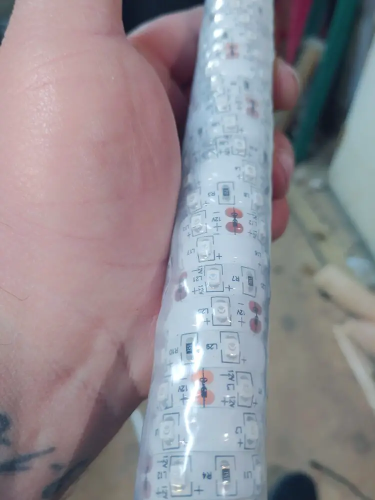

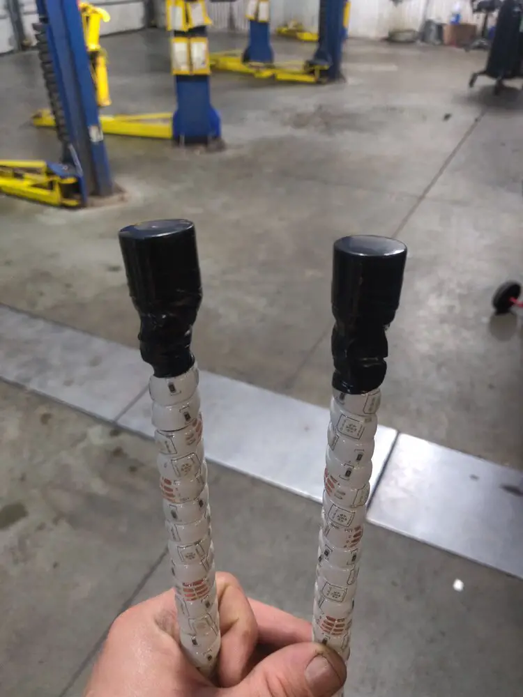

I tried some different things with the blacklight whips i made last night
These caps fit 1/2 sch 40 pvc perfectly
I got this to test the larger sizes and learned that 30mm heat shrink wraps over the wiring nicely and seals up around the top cap/top of the clear heatshrink, and 20mm fits the bare pvc nicely to hide the white at the bottom better than painting it if you put it on first.
If using ip65 waterproof led strips this 35mm crazy thick heavy duty heat shrink did a pretty solid job
