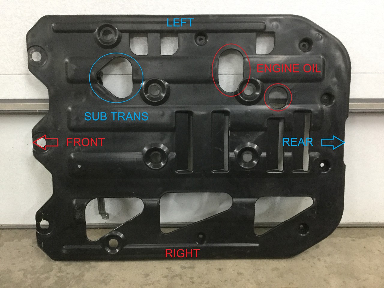

1 - How long have you let it set? 10 minutes should be fine. I assume longer by now.
2 - when you drained the oil. Which drain plugs did you drain? There are 3 total, depending on what your goal was.
---- Most forward is sub-transmission.
---- Middle is the engine.
---- Most Rear is the oil tank.
Adding to this - if you didn't drain both the engine and oil tank, and you still added 6.1 qts. - you're over full.
Also, if you didn't change the filters and didn't drain the oil behind them, you're over full by about 3 cups.
This is a Talon skid but the locations are the same -
I D3ddQQF X2
Reactions: Hondasxs

Under the front seat you're talking about, correct
Okay yes I only drained the engine. I did not drain the sub transmission. It is a different size. And I did remove the filters and change them. All said and done, both tanks dumped and both filters changed. Should it be a total of eight?
Eight what? Oil change capacity is 6.1 qts. when including a filter change.
