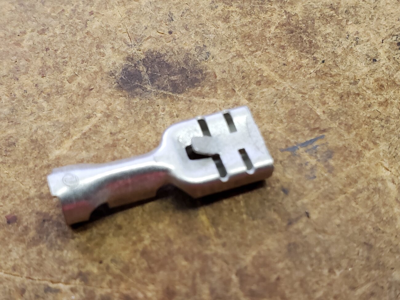

From the harness, sometimes you have to slide along the connector to push in a little tang to release the connector.

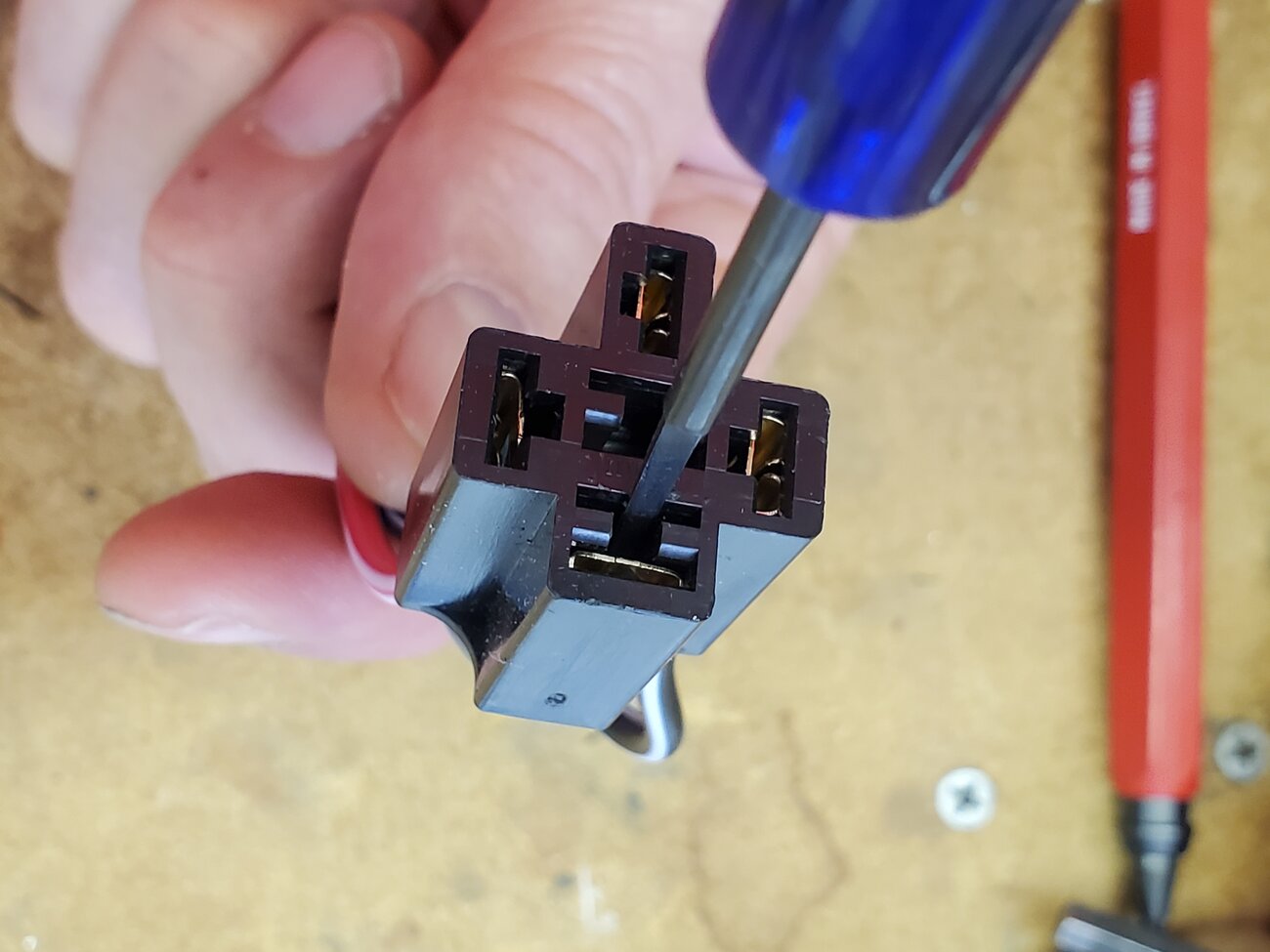

The process....

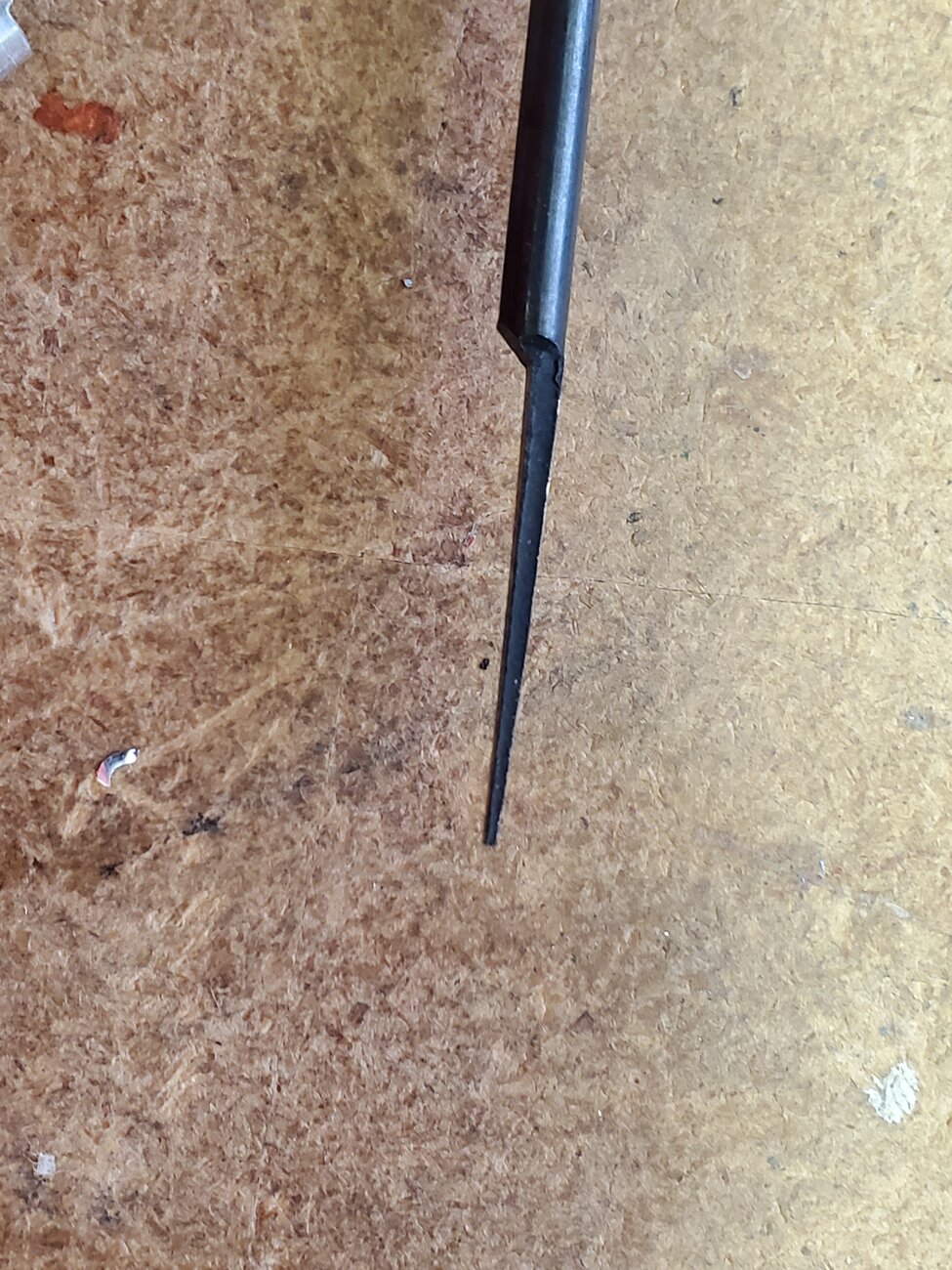

I've tried that but I can't give to move. I just about screwed up untill I quit and bent it back so I could get the relay back in. Don't know what I'm doning wrong. I worked on it for an hout and couldn't get is to move.

In trying to remove the female connector from the "relay base plug", you'll need to apply inward pressure from the wired end, while pushing the tool in to release the little bent tab. Otherwise, the little tab will just dig in to the plastic and you won't get it to release.
Pictures going in would help us determine exactly what you're up against.
