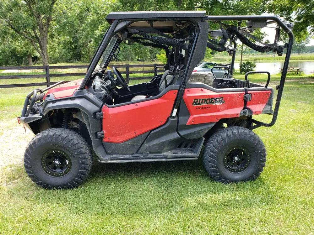

Finally finished up installing new tires, beadlocks, and rear spacers. With pressure at 10# each, all tires sit at full 28". I haven't noticed any rubbing after trimming the skidplate, but have not been anywhere to push the suspension to the limit.View attachment 133176

Just realized I never 'finalized' the info on this thread, reference the tire clearance. After installing the 814 shocks the clearance was no problem. Pretty sure I could have gotten by without even trimming the skidplates if I had installed the shocks first.
It’s been a few months, how are you likening the Berzerkers and shocks? Ive got the STI 12x7 wheels ordered and will be ordering the tires soon.
No problems at all BUT since coming back from Coalmont, I have not been on a REAL ride. Only mild riding around home and hunting. But in about a week I will be going back to MO. then back down to ARK to do some REAL riding.

I happened to check my tires today. First time in a while since the cold temps. They were all down to 6-6.5PSI and 27". I aired them up to max of 18psi and the height was only 27.75"?? It is strange since 8 months ago, they were a full 28" high at 10psi. I think I will let them sit at 18psi for a few days before lowering back to 10psi after it warms up and see if they 'stretch' back out.
