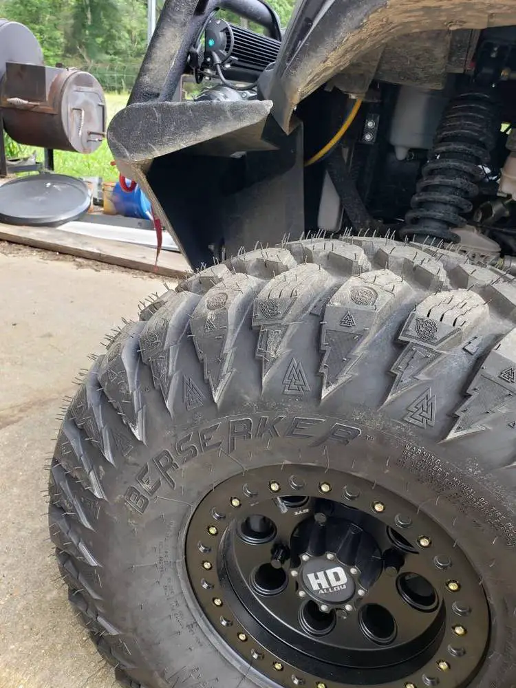

Finally finished up installing new tires, beadlocks, and rear spacers. With pressure at 10# each, all tires sit at full 28". I haven't noticed any rubbing after trimming the skidplate, but have not been anywhere to push the suspension to the limit.5a9244869fa36d6ee96f49113b4a4e2a
