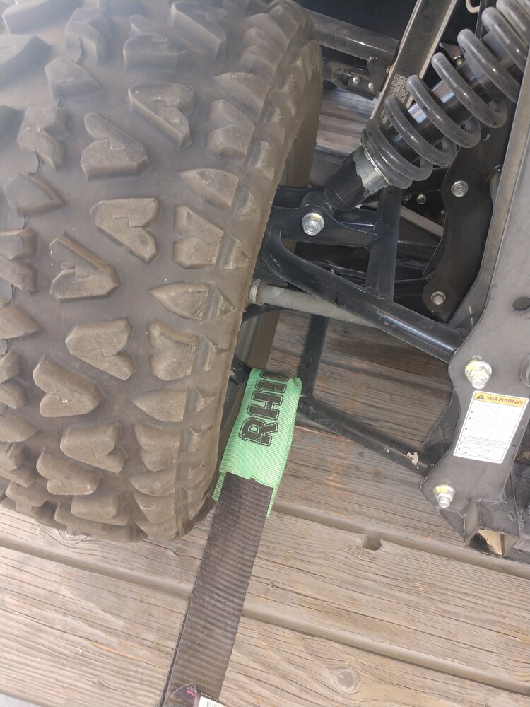

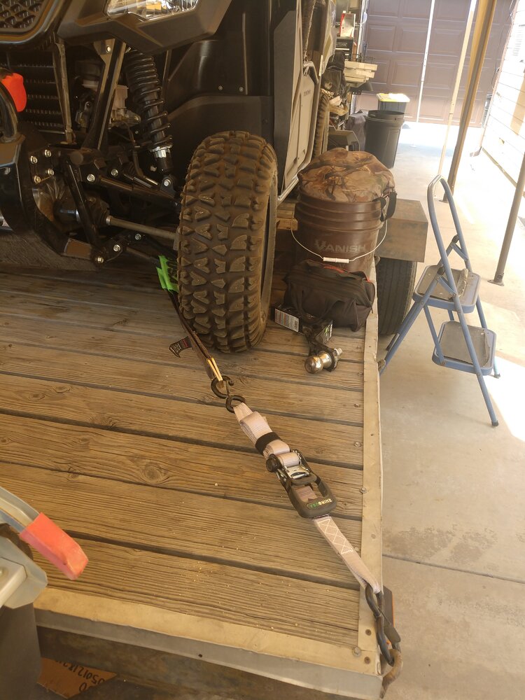

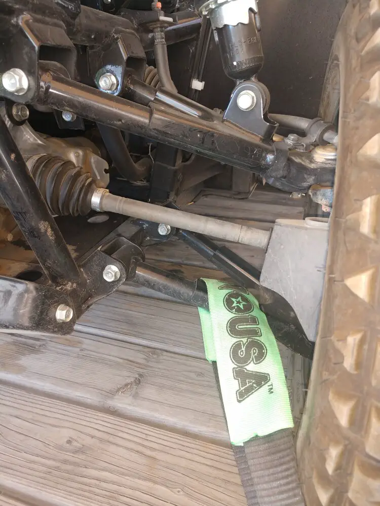

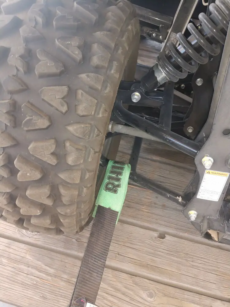

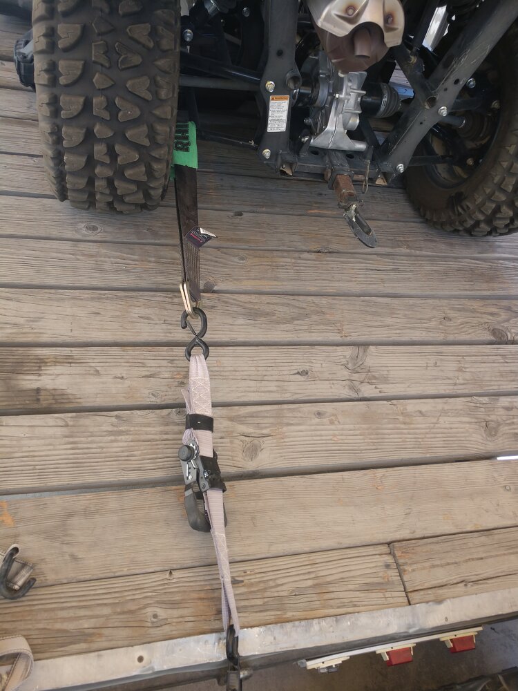

Yes sir. I need to add another attachment point to the front so the axle straps aren't against the wheel, but here is the front.
IMG 20210712 141506312
IMG 20210712 142356493
And here is the rear.
IMG 20210712 142212264
IMG 20210712 142218940
Don't get me wrong, I would love to strap just the tires, but since I only have one trailer and my gear thrown on the trailer changes every trip, I have to be able to shift weight accordingly. That means a different anchor point almost every time.
On another note, by not using the suspension I notice a major difference in how the trailer rides. The 520's suspension now acts as a great big dampener in the wind and on rough roads. Wish I had known about it years ago with the quads.

Thanks man, I was debating on strapping mine up with the A-arms, but just went with what the Honda manual said. I am gonna to go your route going forward to hopefully save some of the life of the suspension. Thanks for posting the pics!
Bisley
Bisley
Apr 14, 2021
154
737
West Covina, CA
No problem. You won't regret it. I know a lot of dirt bike owners that have blown out fork seals doing it too. That's why they make a brace for them.
