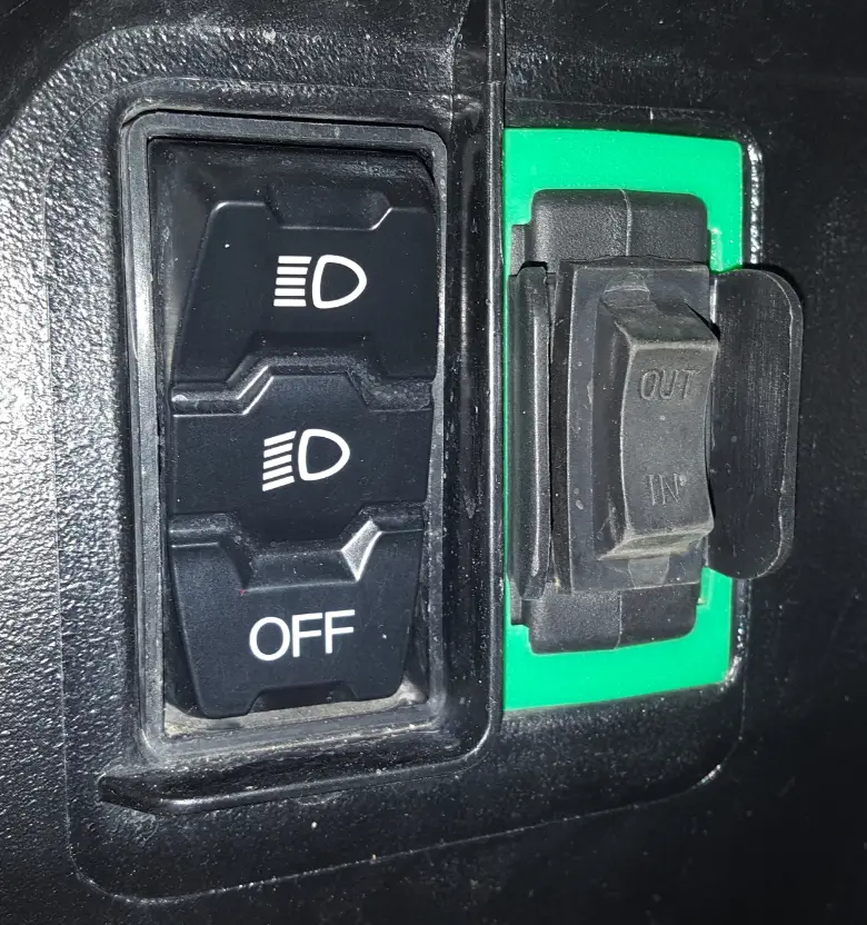

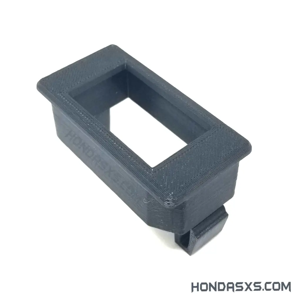

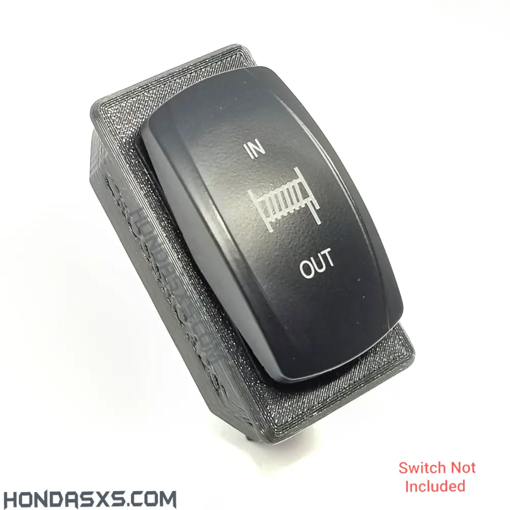

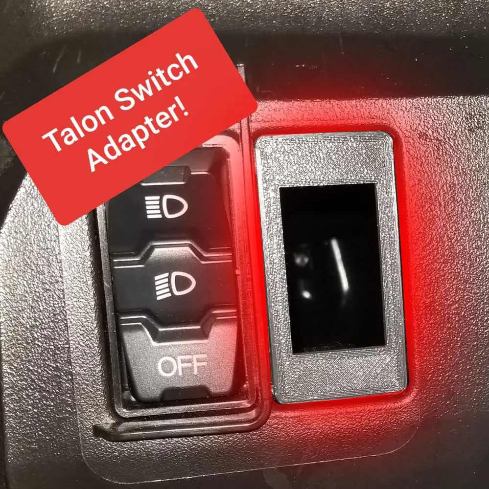

I have been sourcing the web for a switch to fit the blank slot by the headlights on the Honda Talon non Dlx models. Given up, I decided to make my own.
Introducing a Switch Adaptor for the OEM switches on the Honda Talon 1000!
Honda Talon 1000 Oversized Switch Adapter for Live Valve Blank! Talon 1000, X, R, X4
Easy to install and fit Carling style switches.

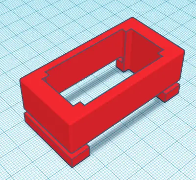

I designed this adapter for the Champion, HF, etc winches that holds the handlebar switch in the same hole. It has to be printed out of flexible TPU and acts like a grommet that you put in the hole then snugly slide the switch into from the front. Should fit all the Chinese winches as far as I know.
If you want to try to sell these too, I can donate the stl file to help the club....
Upload 2019 12 10 12 10 38
Pardon the green, it was the only color of TPU I had...

Is this the common atv rocker?
Sure. We can print a few and add them to the store. I'll contact you soon about this.
Yes, it is the real common one WITH the little wings on it. The wings keep it from pushing in. It must be printed using TPU flexible as it works like a square grommet. I've seen them with and without the waterproof coot over the rocker. You just remove the metal bracket and possible need to cut/grind the screws a little shorter if they are too long. Here is another example...
