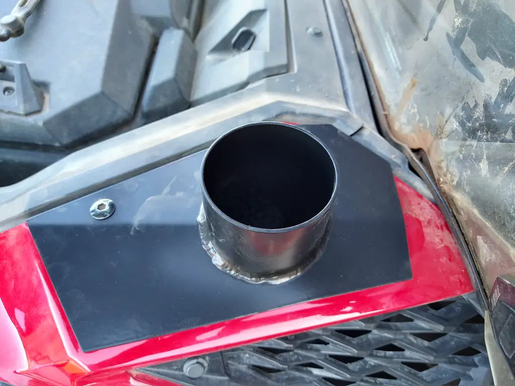

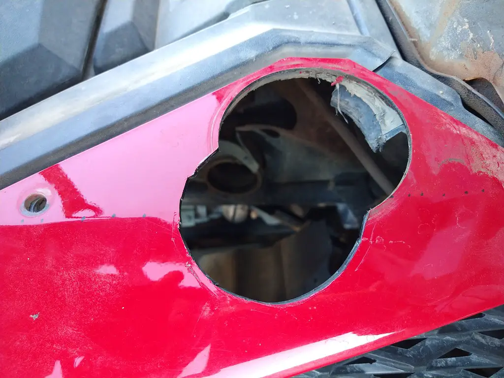

Back in 2019 I only knew of one snorkel kit readily available for the Talon, the Warrior riser kit. It was one of the first things I did to my Talon since my riding environment is very dusty. The Warrior kit is made of PVC pipe, and while it worked very well, I liked the design that @highpocket74 came up with better. I winged the holesaw location for the Warrior kit and took out the front bolt hole in the process, but since the 10-80 Dirt Sports kit has a built in plate, it covers up my mistake.
The top part of the hole is where I used a holesaw too close to the edge of the panel, the lower part of the hole is where I cut using the 10-80 kit's template.
I fQcWCmP XL
Now it's all covered up with a neater install.
I pMFmVdS XL
Ready for action, thanks for coming up with a better mousetrap!
I hBXWqD2 X2

This is exactly what the purpose of the cover plate is! It will cover a mangled hole cut and look more factory!!
When designing the tube I took into consideration the penetration point and didn’t want to cut any more plastic pieces than necessary (or wiring). Of course this meant a more complicated tube shape rather than a simple 90 degree bend. After several prototypes I finally got the tube down to the simplest shape to make and was VERY happy with the result!!

Since you are missing one screw, if you need extra fasteners to hold the cover plate in place, you can drill one or two 5/16" holes on the outside edge of the cover plate and add typical honda push rivets.
I thought about doing that or adding a clip nut but I'm satisfied with how secure it is with just the one screw. Great kit, every Talon should have one!
