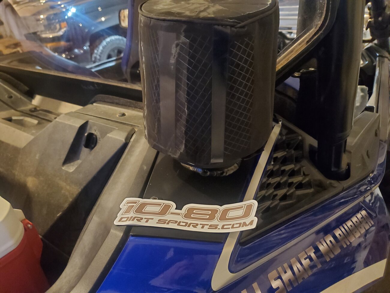

Occurred to me this morning that I neglected to post pics of my install. Of course, it looks pretty much like everyone else's. I'm pleased with the install and the look. Time will tell whether I'm pleased with the results, but I have no reason to think it won't be a vast improvement over the stock filter alone.

Got mine done today, fit & finish is awesome, wish the OEM accessories fit this well. Thanks @highpocket74
