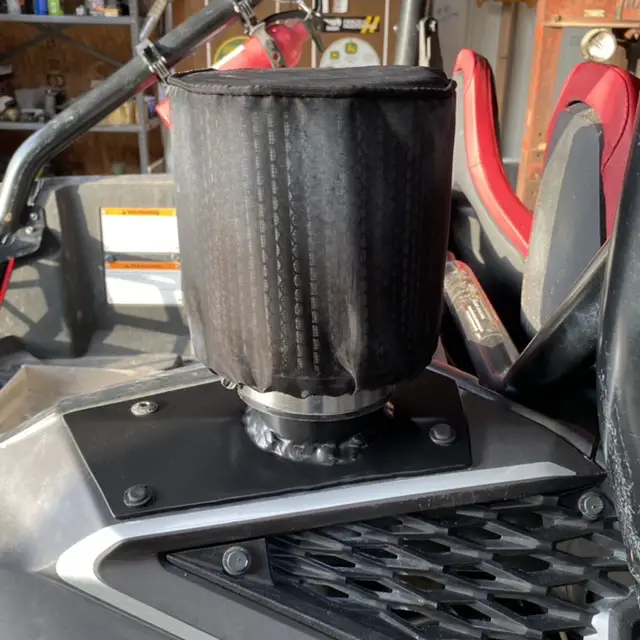

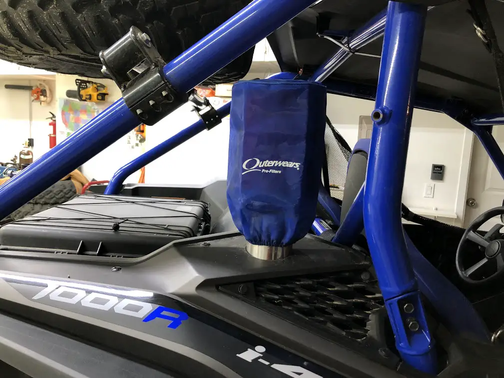

Back from powder coat today. This came out way better than I was expecting!!
That looks really nice, I had some 3 inch exhaust kit pieces left over so I made this out of stainless steel. I like these because being a performance car guy I know intake corners lower horsepower. I don't like all the ess turns it takes to go through the grill opening.
Making a template using the stock fastener holes makes getting the 3" hole in the right spot easy.

Restrictions upstream of the air filter are not as critical as those after the air filter. The air filter is like a huge dam in the flow.
You see what I went through with the tube design in that a straight 90 degree bend will not work.

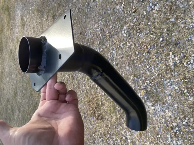

These early MIG welds were quite ugly. The aluminum was just too thin so I had to buy a new machine and learn how to TIG weld. I'm still no artistic welder but the pieces are solidly fused together. The cover plate in this picture was hand cut with a plasma torch and manually bent on a press. Since this prototype was proven to fit properly they have all been laser cut and CNC bent and TIG welded.
Glad to see you are continuing to refine your product but I hope it also makes production faster and easier for you. I bought mine in June of 22. I don't know your process then but I can tell you I'm happy with it and wouldn't want to ride the AZ desert without it. Keep up the great work and keep building stuff to make the Talon even better!!
