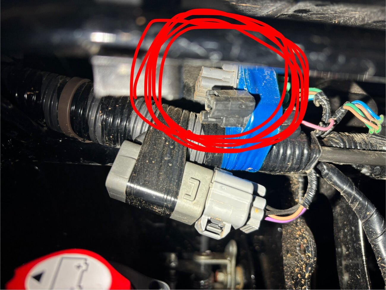

Hi, I’m brand new to this and haven’t had any real luck with the search function. I bought a second hand 2023 Pioneer 700-4 Deluxe. There seems to be a factory installed rocker switch which doesn’t do anything, and I cannot for the life of me find anything online that helps me navigate how to tap into it for a light bar. Can anyone provide any help? I’m very new to this. I do see that it goes into what looks to be the main wiring, but from there, I have no idea
Here are some photos.

Follow up question. Do you know what these are for?? There seems to be 2 which aren’t plugged into anything.
IMG 6159

Yep.
Single pink wire is key-on hot. We have a thingy for it.
The other... well one of the other 2.
Is the connector for upgrading to the LED headlights with high beams.
And don't bother. Not worth it. Just add a light bar and save $400 bucks.

This community is awesome. Omw to order the key-on switch.
