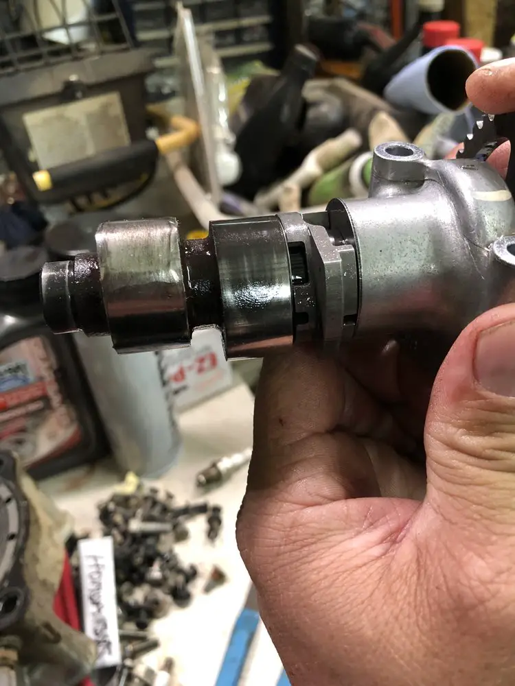

Thought I would add my experience. Looks like I have the exact issue as DavidGaud. Here are my photo. My Cam Follower looks identical to the picture above. My Honda is a 2014 purchased new and just started having the issue. I feel like this is a faulty part or someone at Honda tightened the valves too tight.

... faulty part or someone at Honda tightened the valves too tight.View attachment 93841
Interesting theory about the valves being too tight. I don't remember hearing that one. I do remember hearing of over tightened bolts thru out the early machines. There's a few of us that would like to see Honda publicly address this camshaft issue. My biggest problem with it all as the lack of reassurance that it won't happen with the replacement 2015 cam. I mean we had a 2016 owner surface with the same problem on a low miles machine. Somebody said that Honda is trying to get back to better quality control with the new Talon coming out. Hopefully the Pioneer factory picks up on that. I know one thing....that Yamaha Wolverine X2 has caught my eye.
But hey..... Welcome to the forum! It's a great and fair place with awesome members and it's not owned and run by robots.
Farmer, Thanks for the reply. Have you had to replace your camshaft on your Pioneer? What did you local dealer say or did you contact anybody. I feel like I've done everything right around maintenance and care for this not to happen. I don't ride the Pioneer hard, mostly around my 5 acres at low speeds. This could have been an issue for some time but I rarely open it up at full speed. I'm going to grip at my dealership where I purchased it and let them know I'm not happy. I'm sure nothing with come of it.

Thought I would add my experience. Looks like I have the exact issue as DavidGaud. Here are my photo. My Cam Follower looks identical to the picture above. My Honda is a 2014 purchased new and just started having the issue. I feel like this is a faulty part or someone at Honda tightened the valves too tight.View attachment 93841
How many miles are you showing on your rig when this happened? I've got about 4500 on my '15 and it seems to be going like the day I bought it.
B
Bobby_McIntire
Nov 5, 2018
Oklahoma City
I have around 2000 miles on mine. A lot of the riding in at low speeds around our 5 acres.
Yes. Same as you, but with low miles like many others. Under 700 miles. Small farm with lots of start and stop riding. Rarely does it see 30mph or even 20mph. If you read through the beginning of this thread or do a search of the forum you'll easily find that the common problem seems to be "golf cart" type use vs. long highway or trail type riding.
