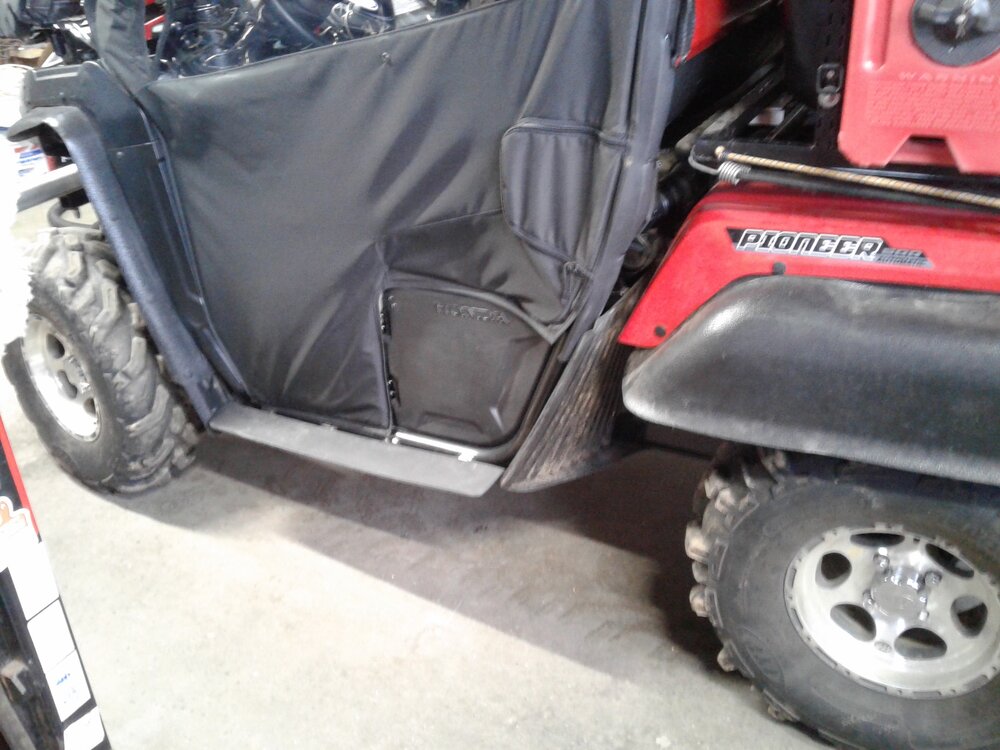

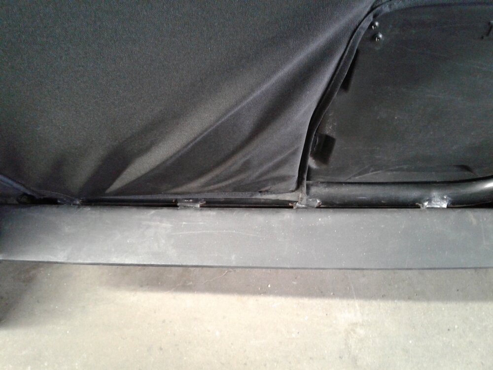

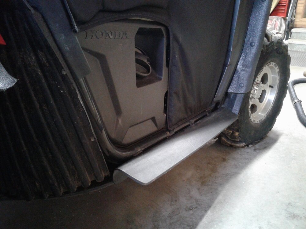

MUD - Deflector
Made out of Tailgate Protector ( top edge protector ) cut in 1/2.
Keeps most of what front tire kicks-up off side of P500 & you. ( New P520 DOORS too )

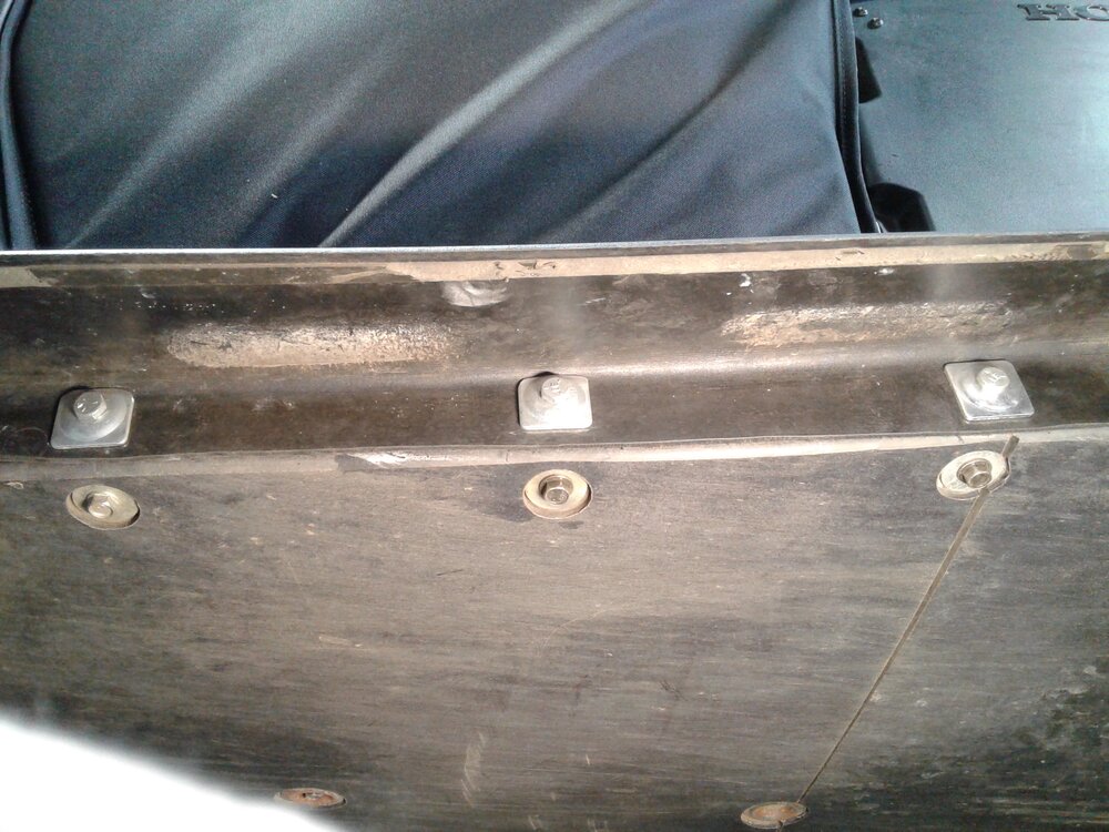

Cut 8 pieces of : 1/4in. thick -- 1x1 angle steel ---1-1/2 wide -- drilled & tapped 1/4x20 thread on all 16 -- 1x1-1/2 surfaces
WELDED : 4 Pieces on each side of P500 -- of the angle steel to the bottom of roll frame -- located where the full UHM skid attaches.
SSS recomends drilling holes & Put bolts through that frame ( felt holes would allow water in the frame ) went my own way no water in the frame.
The SSS SKID is bolted into bottom of the welded on angle & the Mud-guard bolts into the side of welded on angle using the 1/4x20 tapped holes.
The pictures should help.
3rd picture shows Welded pieces - 4th.picture is of bottom showing -- bolts holding Skid & Mud - Deflector

Only 3in. Wide/ front - & - 2-1/2in./rear - easy step right over.
Just wide enough to stop most of the spray.
If ankle comfort was aproblem - would have labeled them ( ankle clippers ) & trashed them.
