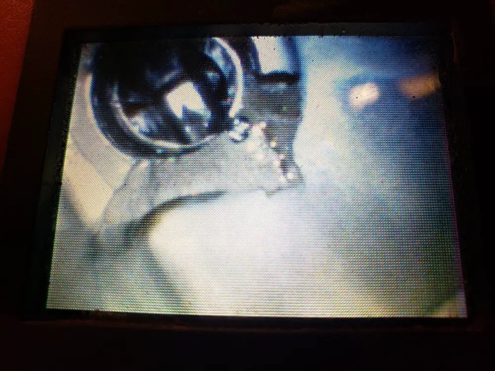

Found the culprit, not really a stripped thread, but broken block. Has anyone seen this happen. 20210913 193033

Actually I didn't over tighten, nor did I hit a rock, actually I think it was a faulty case.
