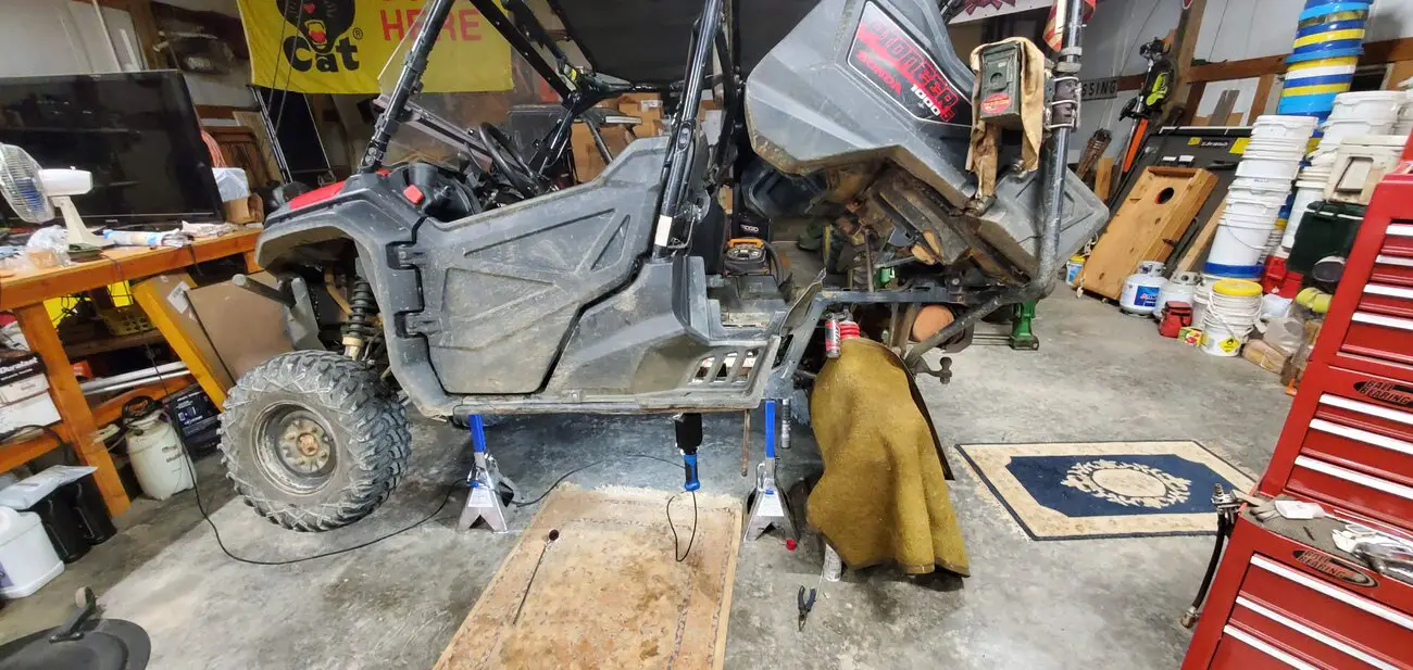

So, here is a picture of my baby on the operating room floor:

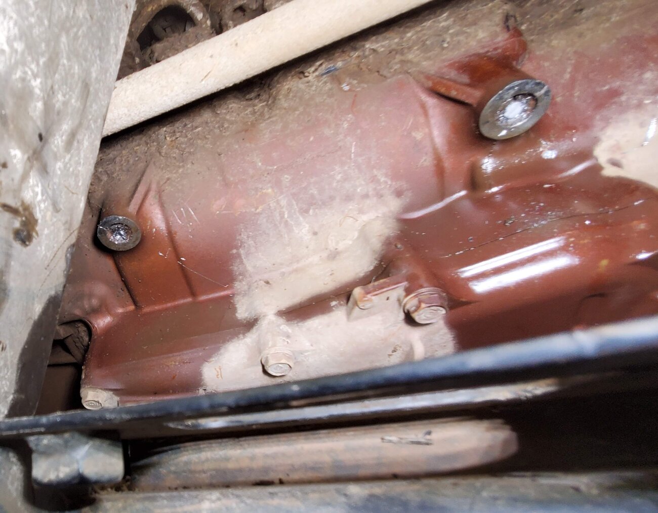

And here's a pic of the failed surgery:
The lighter color in the center of the bolts are actually the "easyout" that broke on BOTH of the bolts. Cheap crap. Anyone have any suggestions of where I can get a good quality/STRONG easyout?
I'm guess I'm going to have to re-drill and this time, now that I have read @snuffnwhisky comment, drill all the way through and re-soak with penetrating oil. But will that drain the oil? What's on the other side of the broken bolt?
Or I'm going to have to learn how to weld or find someone who can to do the nut trick for me.
As @Smitty335 said, don't even try to drill for another EZ-out attempt. That metal is hardened steel and you'll make a mess of things.
Welding a nut on is really the best solution at this point. Soak them real good, for now, with penetrating oil.
Its a blind hole. There will be air space behind the bolt when breaking through. But the easyouts are really hard and really hard to get out if broken. I would weld a nut to them.

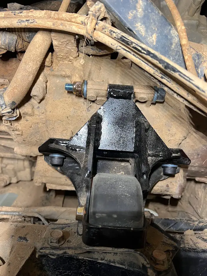

Hess makes a brace like this for Talons, I don't see why it wouldn't fit pioneers as well.
I was wondering about that too. But I would still have to get the two broken bolts out in order to bolt on the brace. Unless I just used the single bolt at the top of the brace and just left the bottom two bolts completely off. But I'm afraid that single bolt would break the engine case at some point.

I meant for future prevention. I wouldn't run without those two bolts, its just gonna break something else

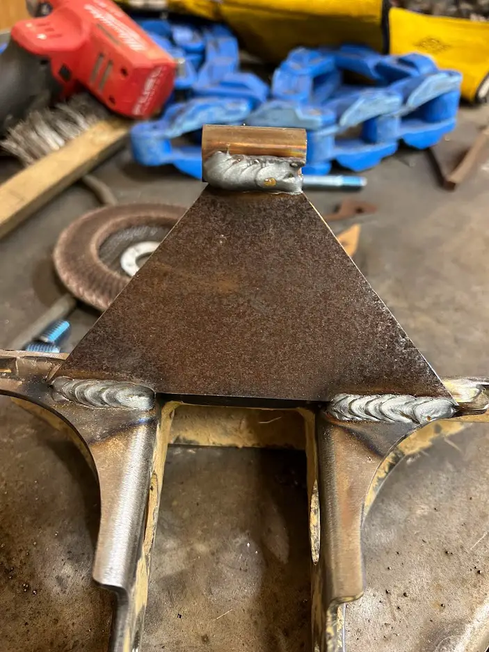

the Hess Mount would fit the engine, but it won’t fit the bracket that mounts to the frame without some custom fabrication. So my thought is that if I was doing custom fabrication, it was a lot easier to modify the factory pioneer mount.
