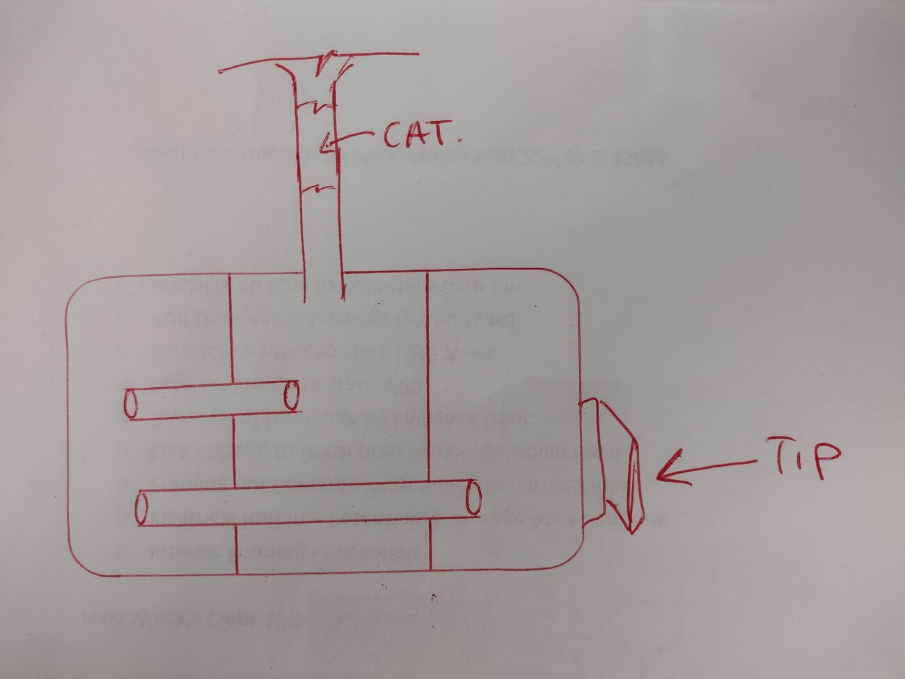

If you cut off both ends of the muffler, can you tell me what is on the other end of the muffler? The end without the outlet.

There's nothing at the other end. And believe it or not I didn't think to take any pics of when I actually opened both ends. I actually ended up swapping the ends on the muffler........ exhaust tip is on the driver side now......🤷‍♂️ I was bored 😂.
Here's a crude sketch of what I noticed inside.
IMG 20230921 124659773
By moving the tip over to the opposite side it does sound just a bit 🤏 louder but nothing crazy. I think it'll flow a little better too especially in addition to having the cat removed. Haven't noticed any loss of back pressure either sooooo 🤷‍♂️
Perfect, Thank You!
