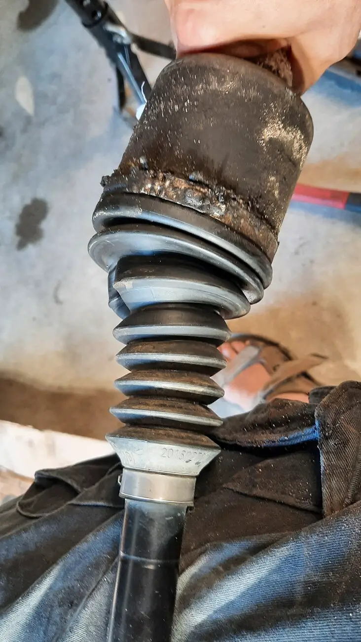

I had a Rhino 2.0 axle fail on the RR after a little over 1000 miles.
It started making some grinding noises 3-4 rides ago, then I articulated the rear end thru a rut and it found a happy place where it made no more noise since...
I went to take it off tonight, and when I gave it a tug to pop it out of the diff, the inner joint was free! 😬 I was stretching the boot trying to pull it out!
Fortunately it popped out with a pry bar between the CV and diff. Even more fortunately, I still had my old stock RR axle that I was able to install. It's Labor Day weekend and I have visitors ready to ride.
20220901 183905
In the pic, I couldn't get the CV back to straight. It's jacked.
I’ve always wondered what the maximum angles that those CV’s can take for prolonged periods would be. Especially with the modified suspension.
They're supposed to articulate 30-40% more than stock, if I recall the right numbers. SATV warranties them for 18 months even with lift and all, so for the most part, they're built for it.
First one I've had issues with of the 4. The two fronts have been on a lot longer than these rears.
I haven't broken a stock axle shaft since I put SuperATV arms on, that's saying something for a machine that broke a front axle shaft at 7 miles.

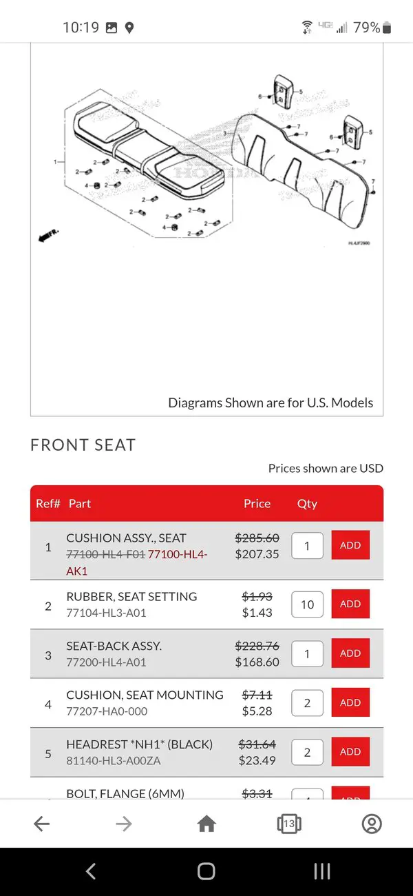

I've also noticed that my seat is starting to come apart all around the driver's side. It's only going to get worse.
From what I've seen here on the forum, no one has come up with a successful repair of a P1000 seat with various adhesives.
I'm wondering if it's worth my time to take it to an auto upholstery pro and see if they can improve on it...
Honda changed the way the seat material attaches to the base for 2022. Your best bet would probably be ordering a new seat
Oh, cool. Thanks! I was just looking at the cost of a seat, and I went in under the 2018 path. You can see that they've got a replacement part number, so it looks like everyone gets the revised version.
For that price it's probably worth just buying new. I see some guys put a cover over it. I repaired the one on my 700 and it lasted for the 6 months I had it till I sold it. Idk how much longer it lasted. I had 3 or 4 hours of time repairing it. My 1000 is starting to come apart so I'll be interested in what route you go. I was thinking camo seat cover
I just ordered. I was gonna order one last year but didn't because my machine was gone in the winter months. I'm glad I waited so i will get the 22 version. No doubt it will be on backorder.
I'll probably be buying a new one next year. I figure this one will hold out for a while.
