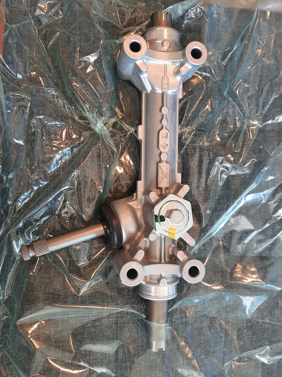

Man, I think I'm starting to see the negative effects of all this lift, tires and spacers. I don't think the infrastructure of this machine handles it well.
I go through ball joints and tie rod ends like water (partly because I think TTC made a bad choice for upper ball joints.) Now my steering box appears to be worn out. My rear knuckle bushings were trashed.
I'm having all kinds of trouble trying to get the front end tight and straight with my new $1K worth of tires so I don't trash them. I thought I had camber and alignment dialed in perfectly just 1000 miles ago, now everything appears to be $hit.
Having a horrible time with the LF tires camber that (for some unknown reason) went way top-in. May be related to the steering box slop, I don't know. Dropped more coin and ordered a new one.
I think the front 1.5" spacers are going on the chopping block, for starters...
Make sure to check your frame tab at the front upper arm on that LF.
8,326
63,026
I will, thanks. But do recall that I have the two-bolt uppers from TTC so I don't have as much problem there. I'll be going thru everything in the front end when I replace the steering rack next week.
Ah forgot you had the duals. My RF had weird camber and that's how I found the torn frame tab. Let us know what you find

Big Brown Truck came by, looks like I've got my work cut out for me...
About 30-45 minutes but you'll need a second set of hands to hold the nuts for the rack. I was pleasantly surprised how easy it was once the bolts were out. I took the little shield off the back of the front diff for extra room. Put a dab of red lock tite on the inner tie rod threads while you're in there

Did you have to drop your skid plate to get to it?
I'm going through the entire front end while I'm in there, so it'll be a bit longer than that. But good to hear that the steering box isn't all that bad!

Got the new steering box in. @ToddACimer I have no idea how you did that in 30-45 min, lol.
Those two nuts on the passenger side were quite a pain to get back on. We managed to get them off okay, but trying to hold them to get it back together was a pain. After stuffing myself into the floor well for an hour, and about five magnet‐fishing adventures for the nut and wrench, it finally came together.
Glad you got it done. I was super impressed how easily mine came out and the new one dropped right in. Half the battle is having the right wrench for the inner tie rods, right @BrophyCreek

You can actually take the steering box out with the tie rod ends still attached, and remove them on the bench. You can also install your new ones before putting your steering box back in. I got that idea watching @DDDonkey's video. I may have to check out that tool you linked, though, for regular tie rod end changes. So far I've been able to get them with a big adjustable wrench, but that looks like it could make it easier.
