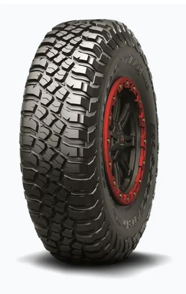

KM3s I chose to go with

Frontline ACPs I decided to skip. I may still try a set after the KM3s, depending on how I like them. That ACP tread design just appeals to me.

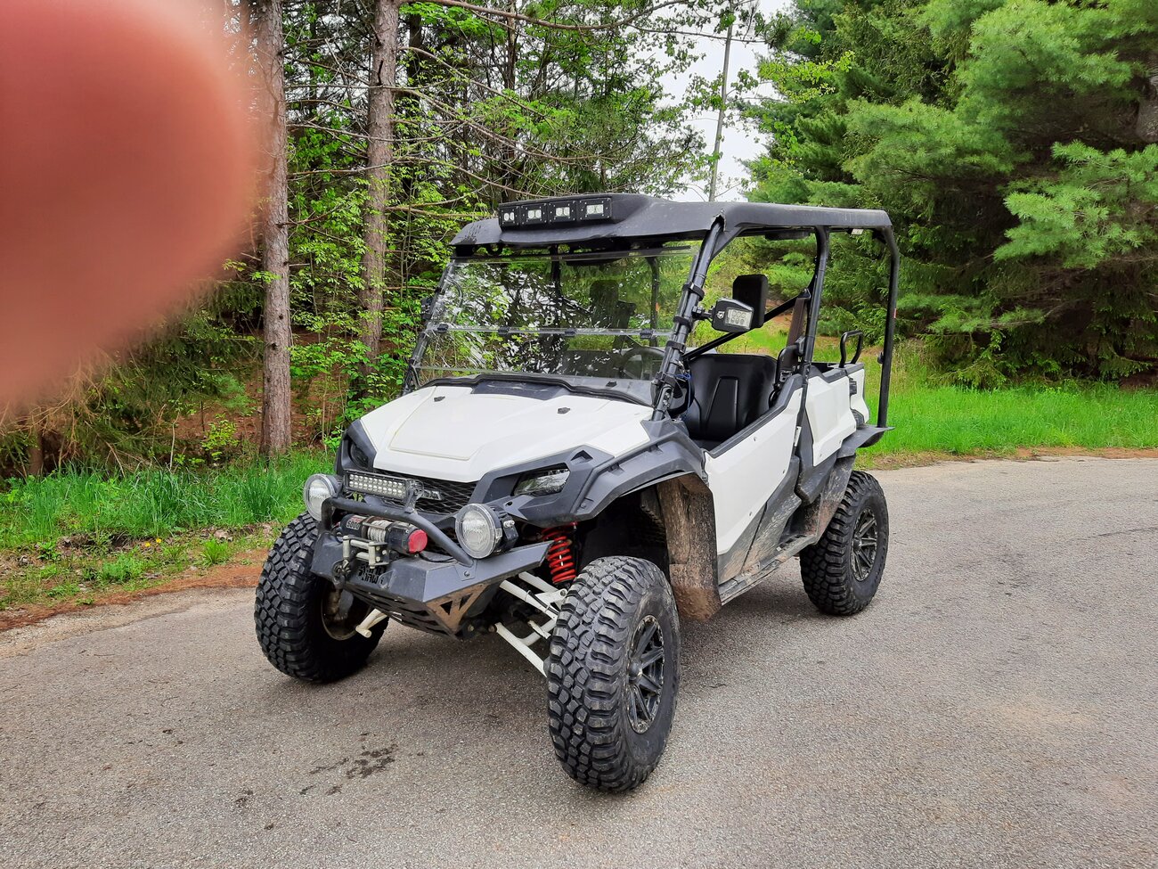

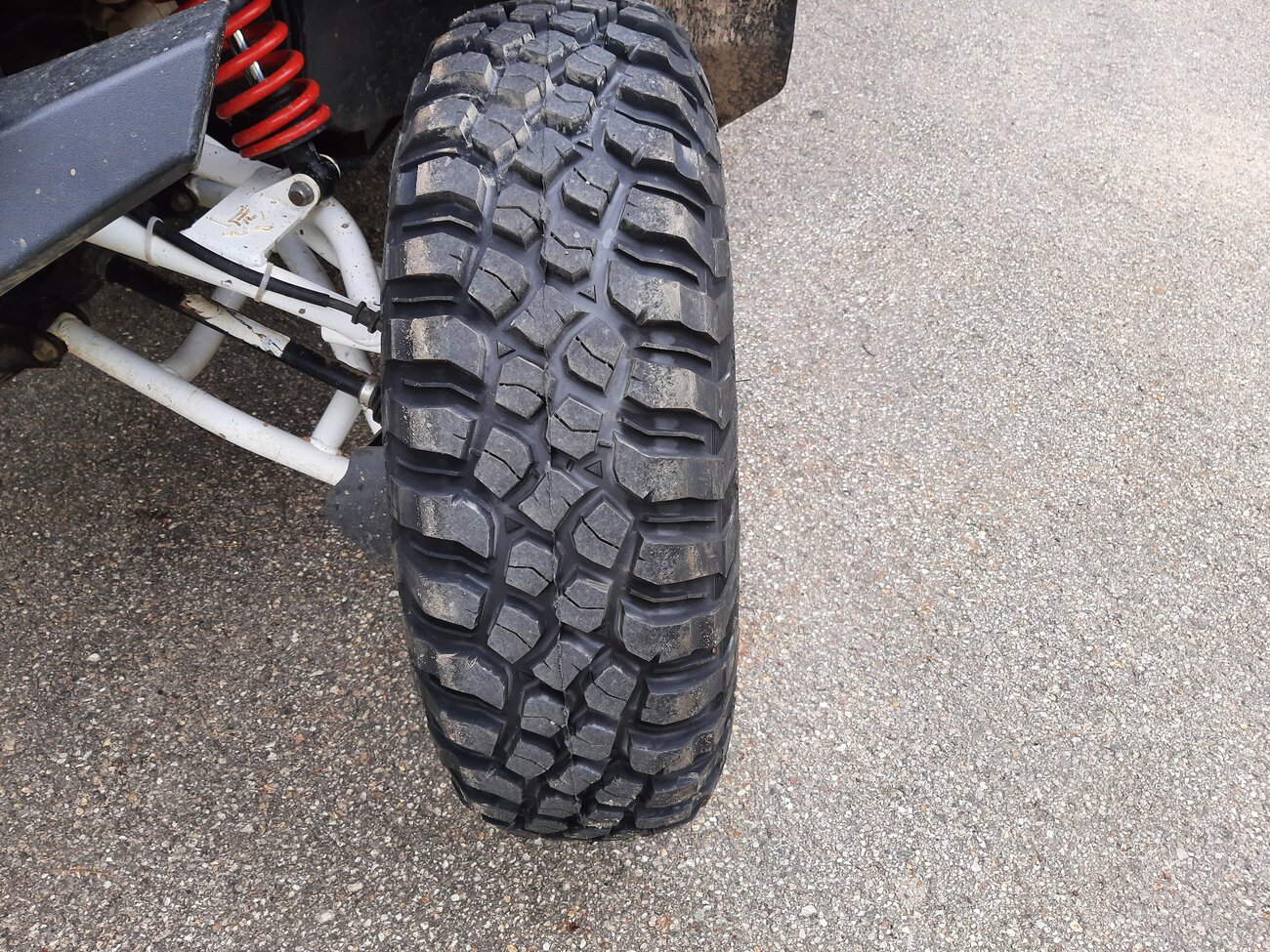

@Blownzuki KM3s, is that the tire you were running on the 1st MOM ride?
You've got me wondering TripleB - was it a good report or a bad report?
Anyway, baby did get her new pair of shoes today. I need to straighten out a few things in camber and alignment before the weekend rides and I'll report back then.
20220526 185144 20220526 185151
21,106
183,549
View attachment 336164 View attachment 336165
I'm not Sure if those are the same tire as @Blownzuki . But his filled with mud and became slicks. It became a rough day for the old Talon.
