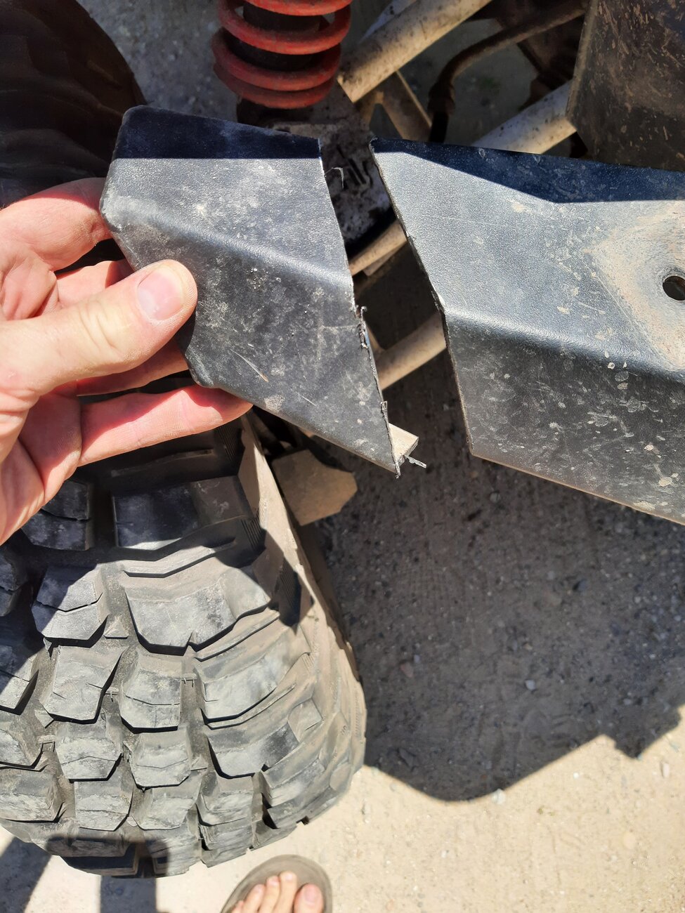

I chopped my Bad Dawg bumper today.
When I went to the KM3s I also took out the 1.5" spacers from the front wheels (decided my front-end chassis parts were taking too much beating, trying to scale it back.)
I was rubbing the bumper occasionally at full lock and compression with the previous tires and spacers. Now I've been rubbing constantly on hard turns. Something to consider for anyone looking at running the Bad Dawg bumper with forward arms and 30s.
Anyhoo, I was reluctant to cut the bumper for aesthetics. It turns out, I think it looks better chopped! I always did think the Bad Dawg sat too low under the headlights, now with the ends cut off it's getting closer to the Warn bumper look.
I may cut it more, definitely if I still hear any rubbing.
20220709 132730
Before:
20220510 211228
After:
20220709 134248
20220709 193400

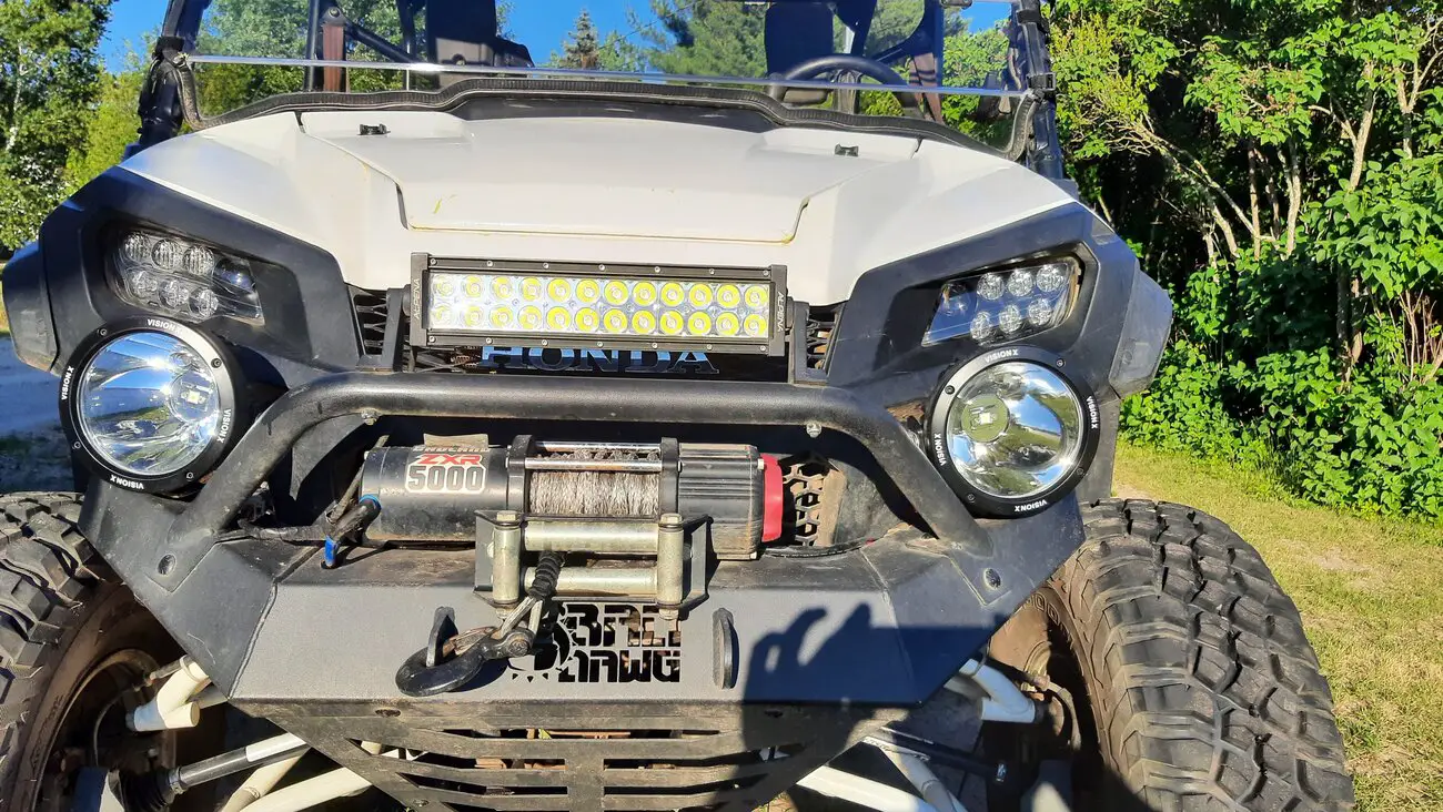

Here's a zoom on that 15". Based on this, I
think you're going to have some difficulty mounting a 20", at least on the flat stretch of the bar.
