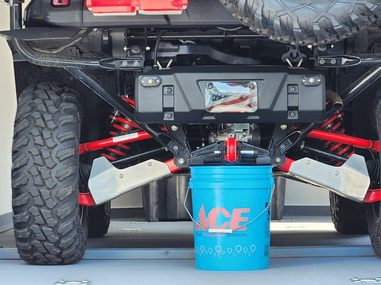

Rear clears bucket by 1" now (1" clear w/skid at .855)

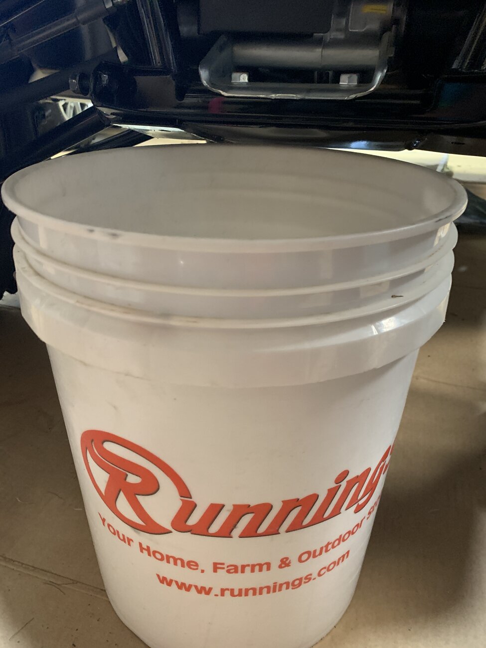

I guess you ain't doing oil changes into a 5 gallon bucket, eh, @P1K5Dave? :D
5,192
20,539
I do clear a bucket by an inch in the rear and 1-3/4" in the front. Still haven't found one on the trails yet, though...
Do you have a lift? I have more preload on my Fox's with the Viper springs and barely clear the bucket.
Yeah, as I said, I could probably add some more preload and height, but haven't gotten around to it (or tried it to see if I'd like more...)
You don't have *that* much more preload on your Foxes than I do, but I have a 3" lift in my arms. That's what's interesting about preload and lift, is not a linear scale. As you add preload, the rate of increase in height is progressively higher.

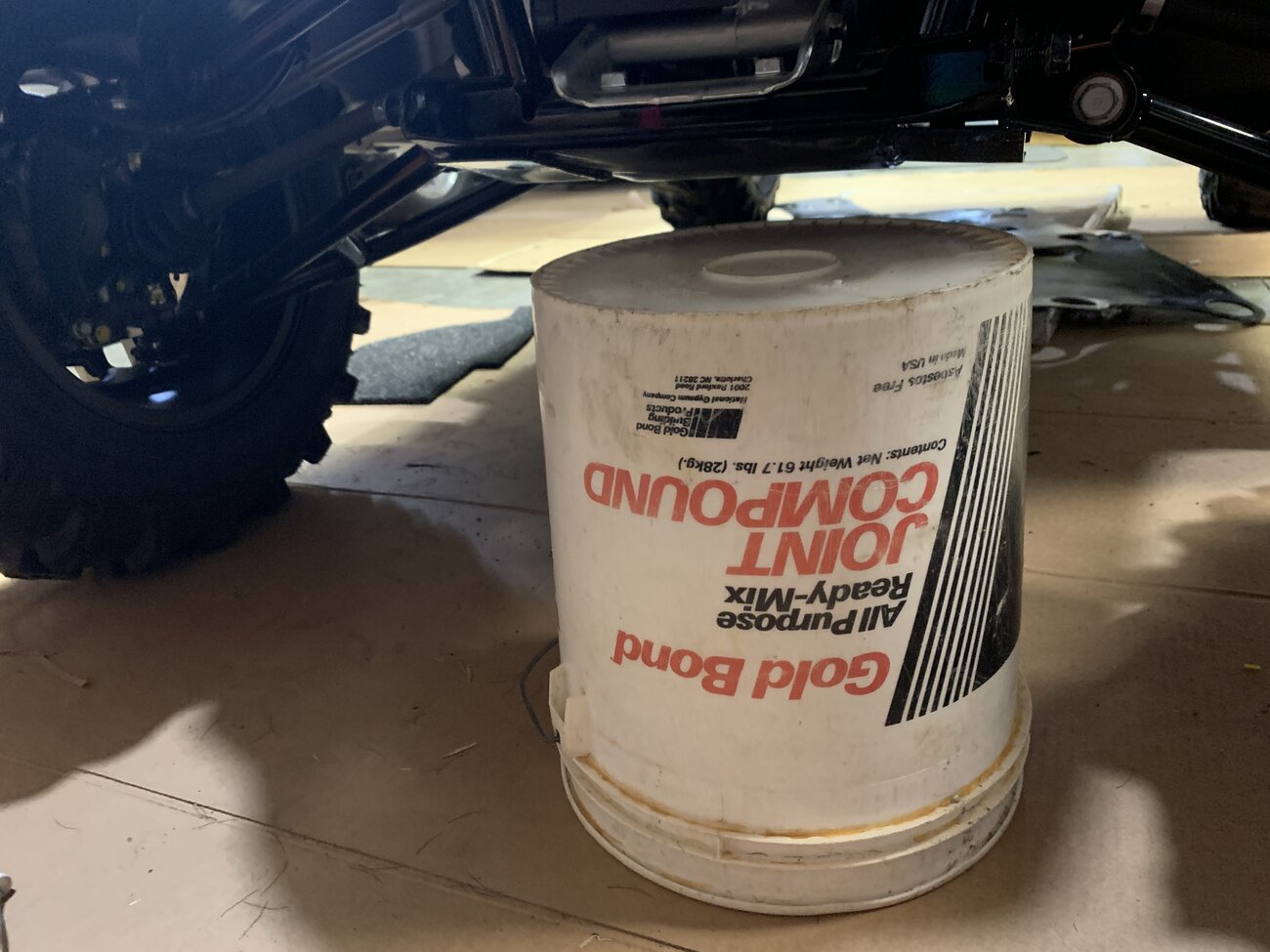

Factory Deluxe shocks on pure stock ‘22 1000-5. Maybe 3” clearance in front. A little less in rear.
