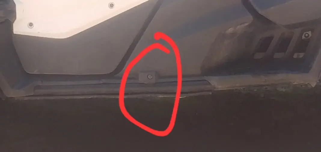

Which bolt are you referring to under the front doors?
Vehicle HeightBeforeAfter
Bottom of front bumper13 3/4"18"
Bolt below front doors17 1/2"20 3/4"
Bottom of rear hitch16 1/2"19"
Bottom of Honda "N" on tailgate43 3/4"45 7/8"

Robobrainiac
Robobrainiac
Jul 15, 2020
2,706
9,361
This one. Those numbers were kind of jacked, though, as they were when I had the 814s and a bunch of preload.
