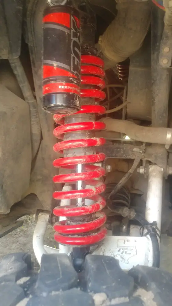

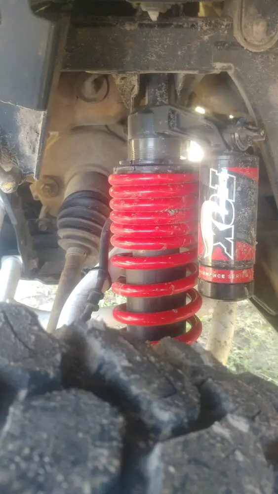

Tell me what you see here:
I've got 1.5" of preload on the front shocks. Looks pretty normal and it was pretty easy to do, as I was able to just take the load off and turn the whole spring and spinner with my hands.
0820211741a
The rear shocks have .87" of preload on them, and they were really hard to get to this point, the spinner turned really hard.
The top of the spring is most all compressed. I don't remember how it looked before I preloaded it, but .86" shouldn't be so much that I lost all the spring, should it?
I'm actually still a little lower than I'd like to be in the rear, but it doesn't look like I can add any more with these Fox's. I guess the key will be going to new springs?
0820211741
I just cranked it on down until I got the ride height I wanted. The compressed upper spring is why I changed mine. But I run them like that for over a year. Still way better than stock shocks.
