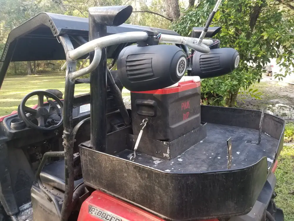

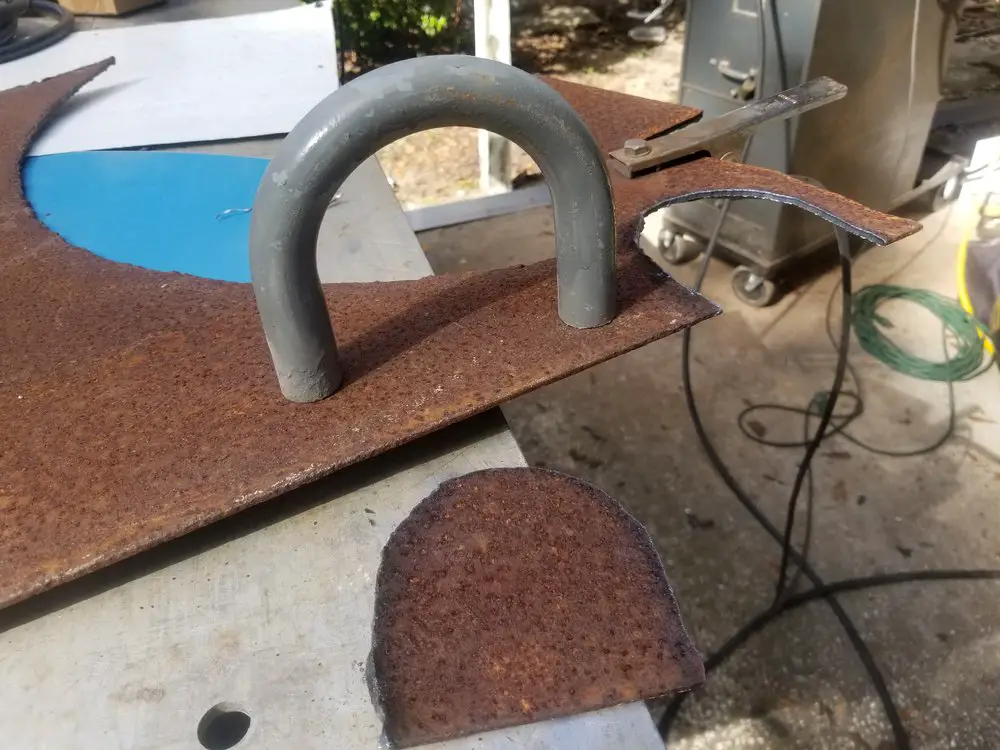

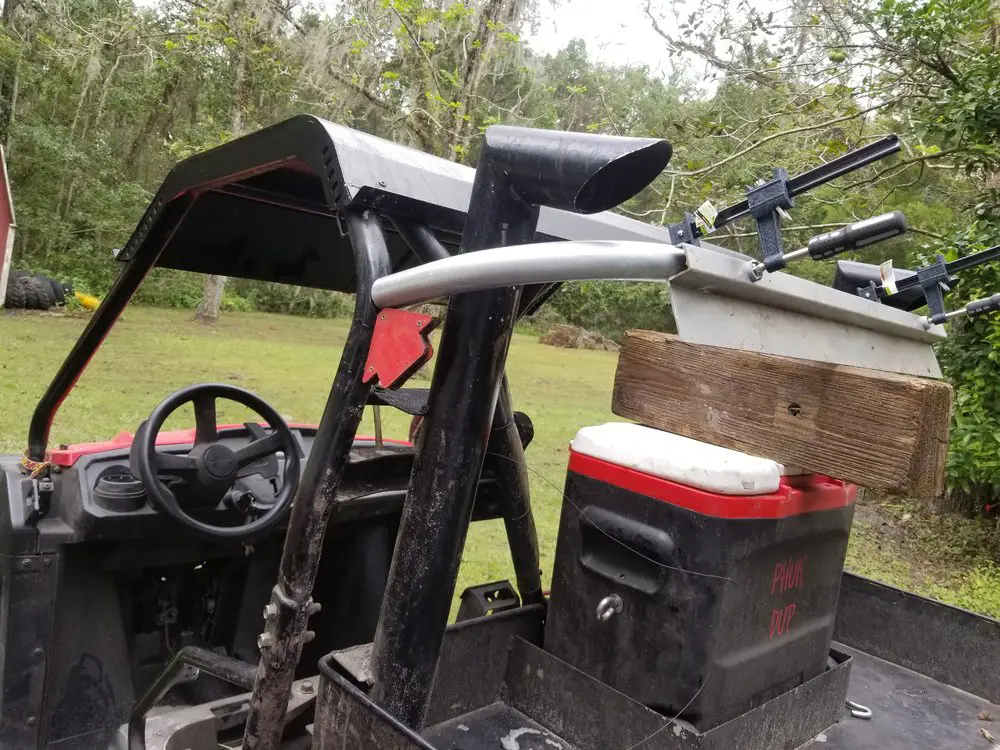

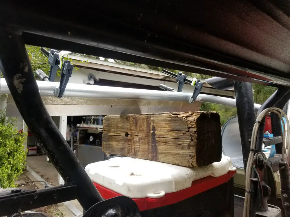

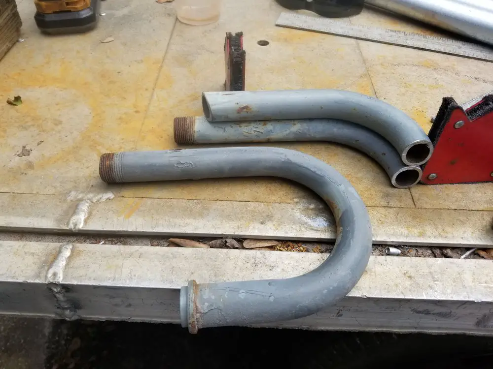

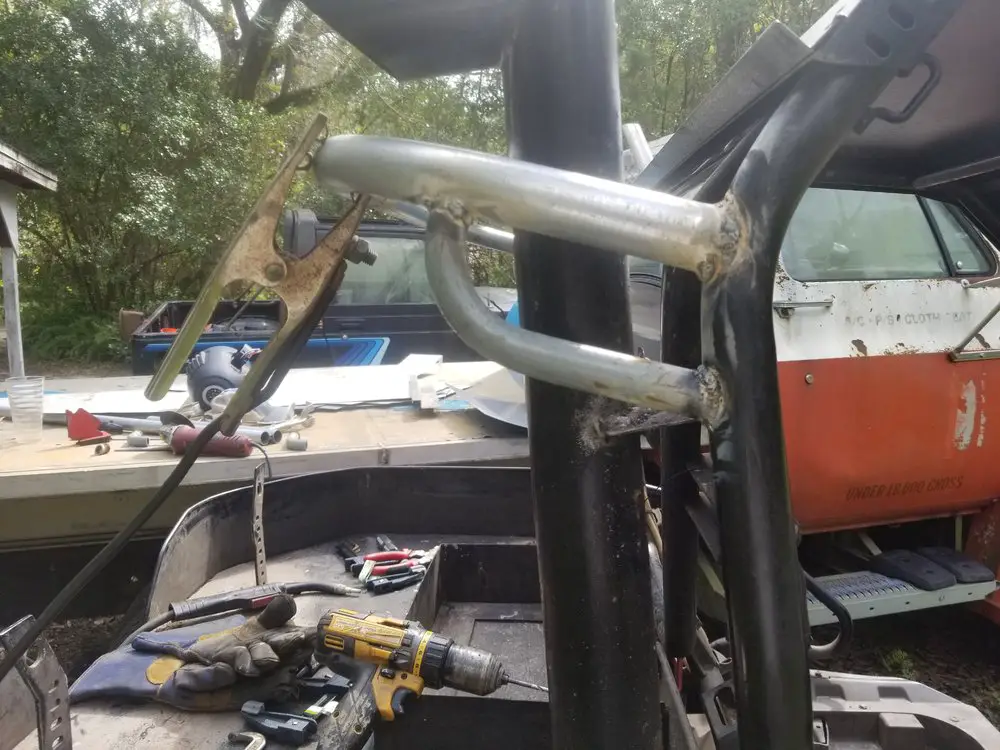

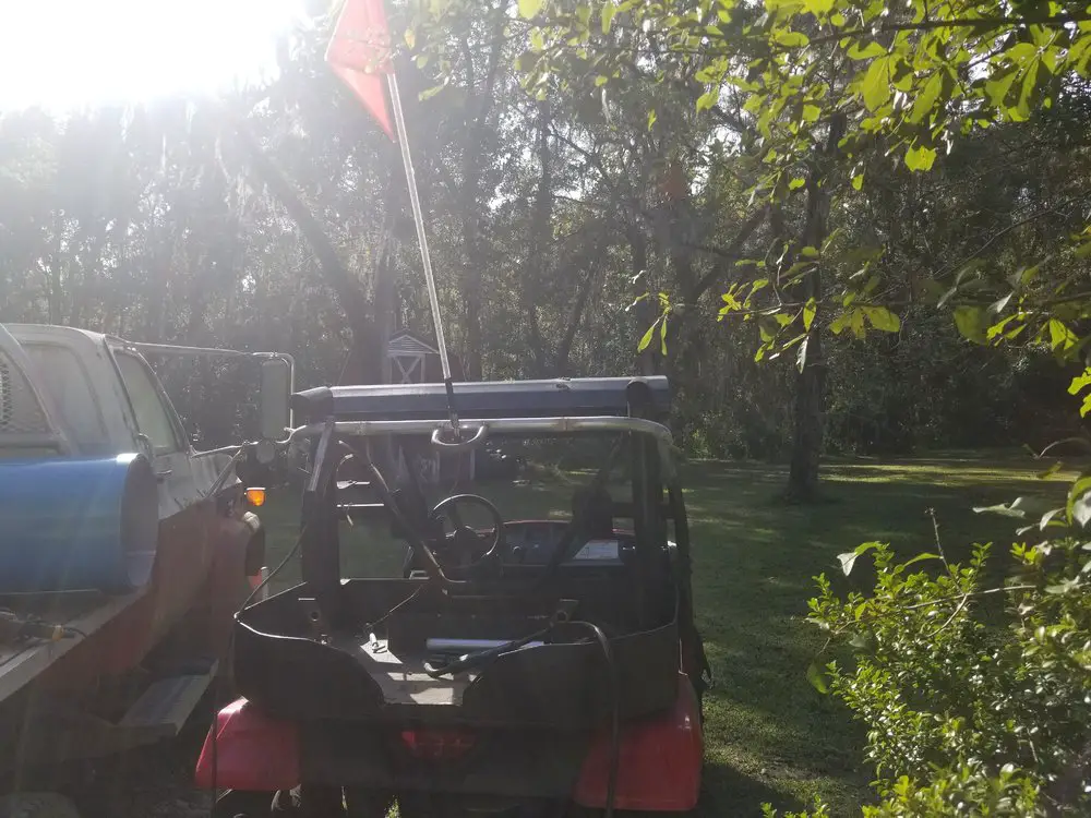

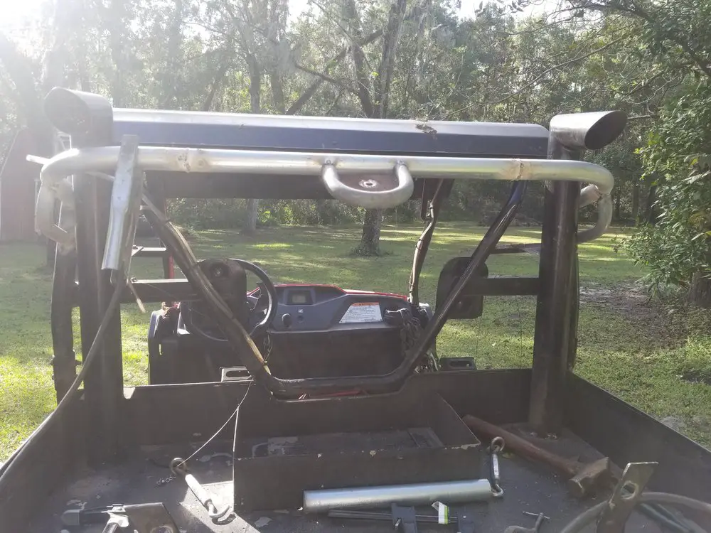

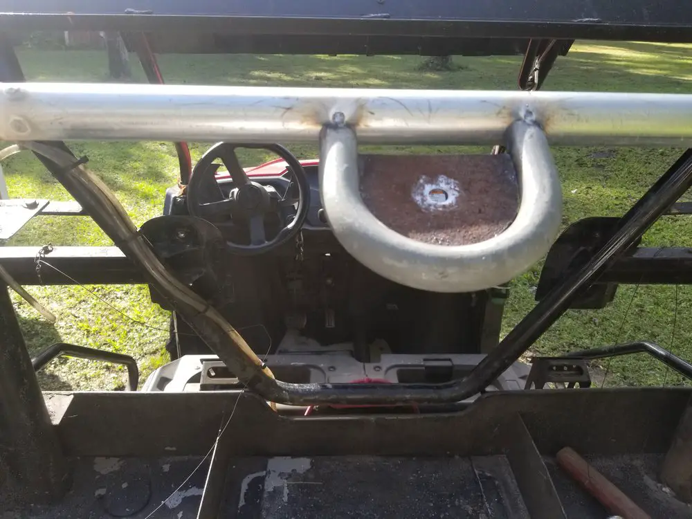

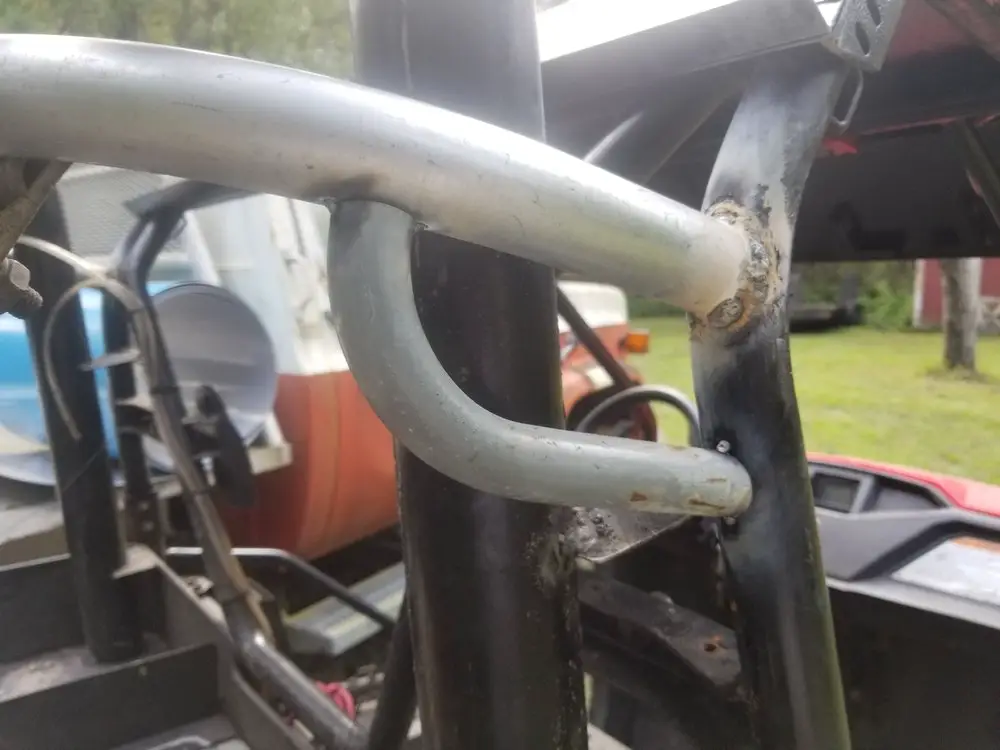

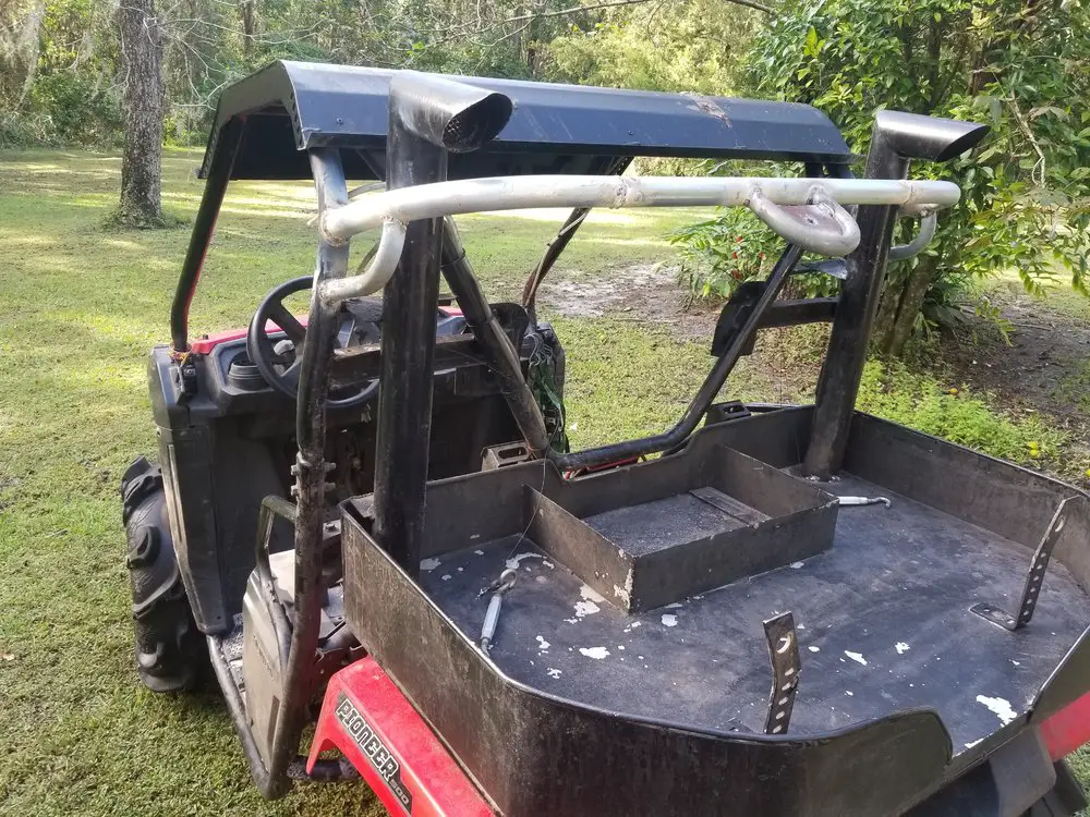

So its been a while since ive posted anything on here. We went riding this past weekend and ive had a little free time this week so i started a speaker rack build. Ive been collecting stuff to do the build for a while. I bought two 8" Hyphonics wakeboard tower speakers and a 500w bluetooth amp. I bought some 1-1/4" fence type pipe with a couple 1-1/4" 90° elbows. Its in no way, shape, or form, rollbar material. If i rolled it, it would probably all bend up and be garbage lol. I just roughed it all together today. Tomorrow ill smooth everyrhing out and paint it. I had to design it where my speakers would kinda be out of the water when im floating. They may dunk partially under sometimes but i aint worried. Also, most importantly, they dont hinder me when i reach into the cooler from the drivers seat for a frosty adult beverage lol. The amp will be mounted on a metal plate and brackets that will be welded to the rollcage behind my head. I aint got to that part yet though. Everybody likes pics so here is some from the beginning up to where ive got the speakers and l.e.d. whip mocked up on it. I hope yall enjoy!

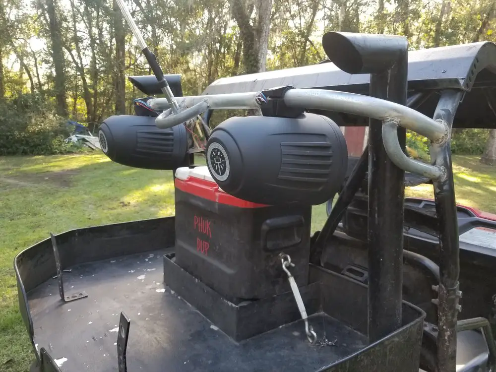

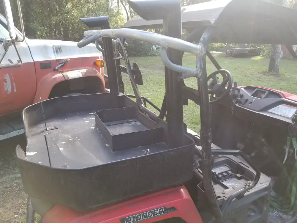

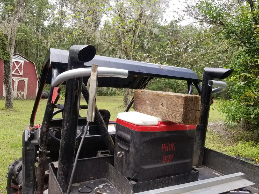

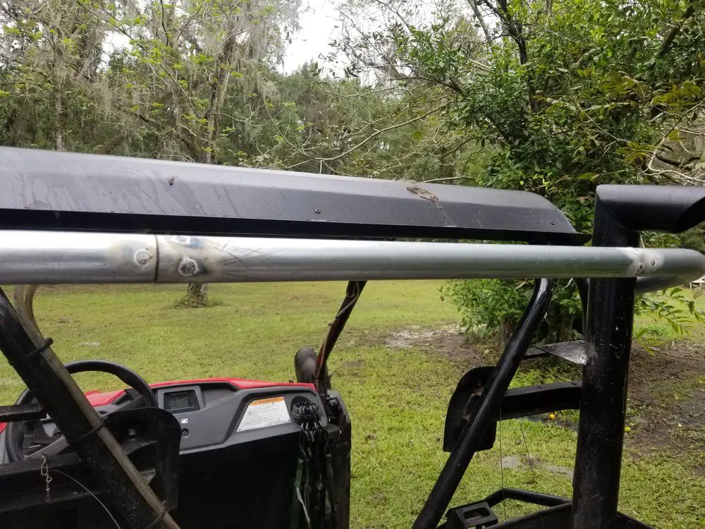

So i messed with it a little more today. I sanded and smoothed it. I painted it gloss black but the paint is turning out crappy. Lots of orange peel. I dont know if its technique or the fact that it was an old can of paint i found in the shed. I think im gonna let it dry and sand down the orange peel and wipe it down with paint thinner or mineral spirits and try again another day. I didnt do any primer though or prep work, that could be the problem too lol. It does look decent though. I decided against welding brackets on the rollcage up behind my head to mount the amp to. Instead im mounting it behind the seat and in front of my frosty adult beverage cooler in a black and white tupperware container that will be siliconed water tight, Flux Capacitor style!! Whaaaat?!! Lol I think im even gonna get a red vinyl sticker made that says, ' Flux Capacitor' and put it on the tupperware lid. Hehehe Well heres some pics. I hope everybody is doing good.

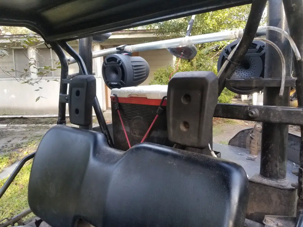

I sanded the speaker tower bar thingy down today and cleaned it with acetone. Sprayed it again and theres no big difference. Its a little less orange peel i guess. I welded in a couple more pieces of flat stock in front of the frosty adult beverage cooler where im mounting the amp. Drilled mounting holes through the rubbermade box and through the flatstock. Mounted the amp in the box. Put the wakeboard speakers on. Put the l.e.d. whip on. Blah, blah, blah. I didnt wire anything. I gotta pick up some speaker wire sometime this week. Anyway, heres some pics.
