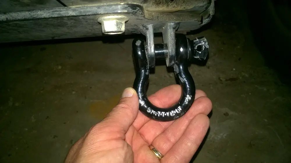

Here they are and they're a little too small.
WP 20170616 18 47 56 Pro

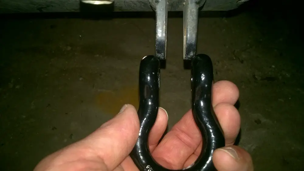

If I had the ability to apply heat this could have been better. I pried and beat the s*** out of it instead. It bends pretty easily.
WP 20170616 18 59 31 Pro

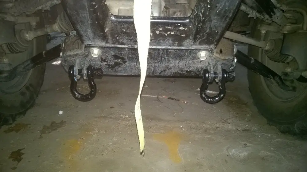

It's important to keep the hole with the threads aligned with the hole without the threads. I wasn't able to get them aligned but I got them close enough to get the bolt back in there. One problem with mounting them in this location is you can't torque the bolt down because you'll squeeze the plow mount tabs together. I put loctite blue on the threads and torqued them enough so they still swing freely.

Now that I'm looking at this pic, if you were to get one like @Remington 's you could bolt it in the middle of the mounting plate.
That's what I was thinking. But you still did a nice job my friend! You improvised adapted on that idea. Looks good
The right to keep and bear arms shall not be infringed
Thanks. I may still add your style to the plate. I can use these for something else.
