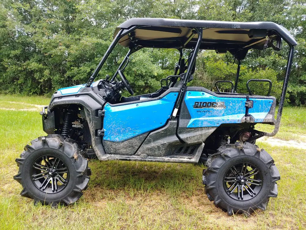

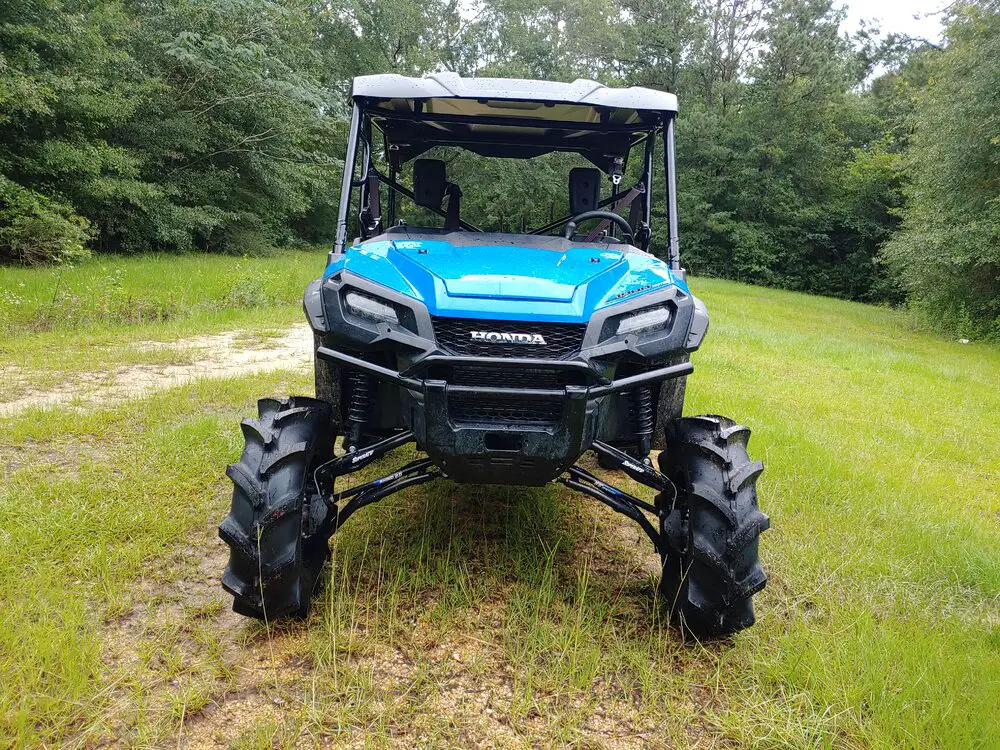

Yep I understand that. And where we ride non portal machines ALWAYS get stuck and we spend most of our time pulling them out. Again I’m not campaigning for portals over IGR but this guy that asked runs BKT’s and was playing in the mud so I doubt he is setting up to ride mountain trails. My Honda will probably never see the mountains. I used to want to go to the takeover but I have built my machine the way I needed it local for what we do. I would have to build another trail Pioneer to go ride with you guys

I love everything about the bike i just want to know what I can do to get more torque out of it to turn the tires in low range before something happens to it
View attachment 207862 View attachment 207863
Honestly if I was you I would do a tune first. The tune itself gave a tremendous amount of low end torque to my machine. Then you do t go into you trans case and grind off and don’t have the expense of portals.

We trail ride and mud ride but I’d say 75% is mudding. We also use it to ride dirt roads around family land and to ride the 500 acres around the lake. I haven’t had a portal related failure yet. Have I upgraded stuff? Of course I have but all of it I probably would have upgraded anyway without the portals because half the fun of owning the Pioneer is modding it. Around me the portal setup is common but on here it’s like I’m riding a Polaris or something 😂
