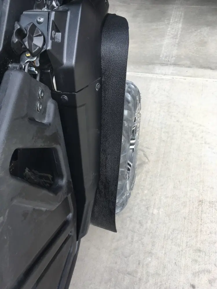

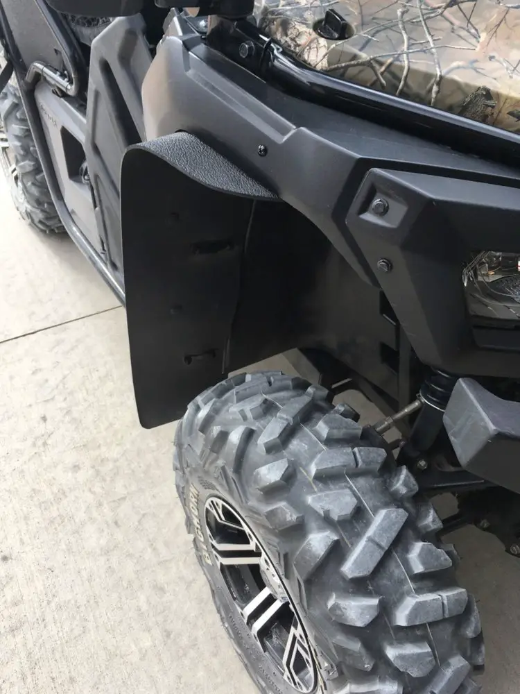

Bought this stuff at a True Value store in Florence. It is 3/16" thick, comes on a roll 4 ft wide and is sold by the foot. Don't know the brand but it is often used on the inside walls of horse trailers. Tough stuff.

This stuff will definitely not wilt in the heat. It takes some pressure to get it to flex. Can't be re-molded with heat. It will flex but I doubt that it could be ripped from the u-bolts attaching it to the frame.
