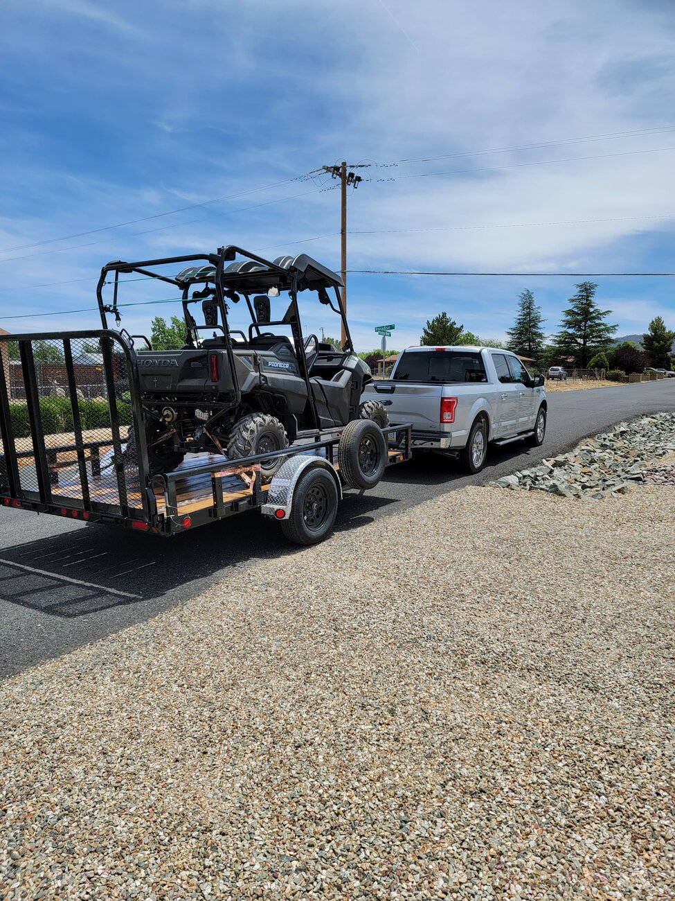

What is the GVWR of a tiny 5' by 10' trailer? It might be overloaded with a Honda 700.
Depends on the axle. Most 14 and 15 inch wheels will have a 3500 or 3000 lb. rating. This weight includes the trailer as well. So if the trailer is 600 lbs. that leaves you with 2400 lbs. of hauling capacity.
Buggyman
Buggyman
Jan 3, 2020
47,551
373,722
ne. ohio
I went with a 6x12 which has plenty of room for my 700 plus some extra gear if needed. my deciding factors were storage space and I needed to be able to move it around by myself. the trailer has 3500# axel and weight is 545# so max load of 2955# is no problem for sxs.
IMG 20180606 194042
