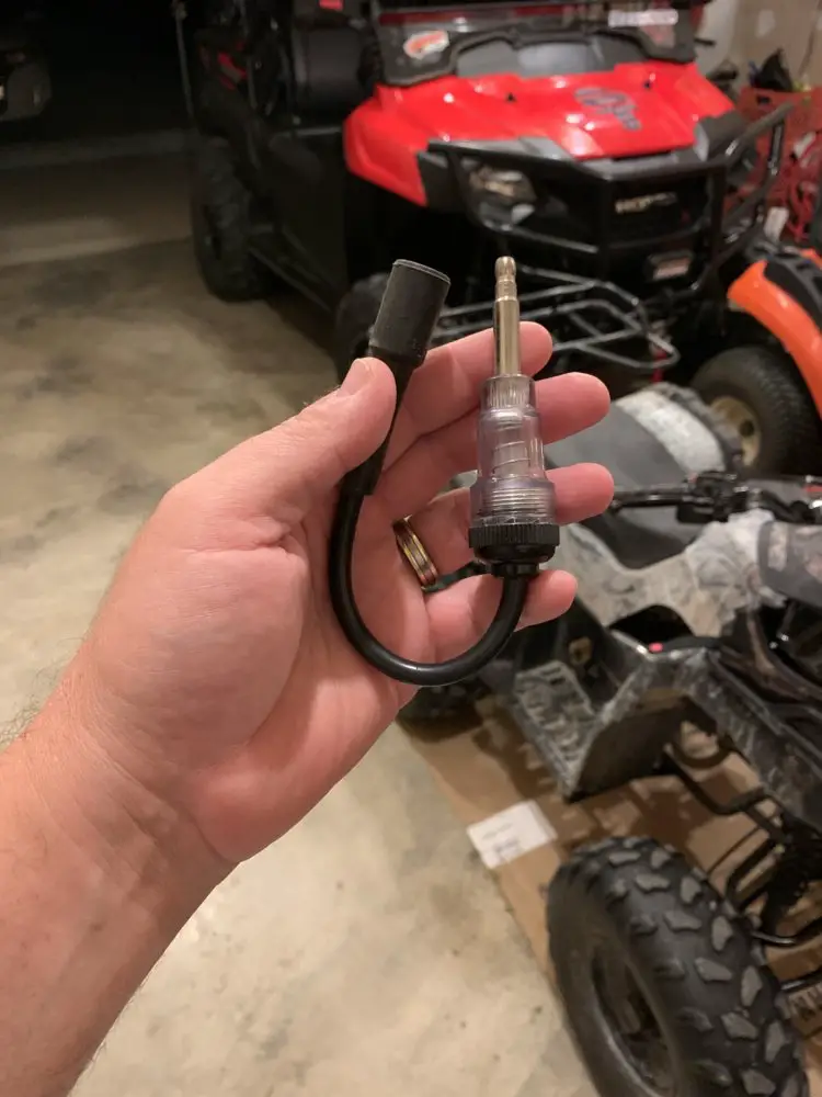

Also, one way to rule out no spark is to put a new spark plug in the socket and see if you can see the spark or go to your local auto parts store and pick up a coil tester, sometimes it can be hard to tell when you’re trying to hold the plug and turn the key. You can also try to duplicate your test in the dark as well. I keep a coil tester in the tool chest for occasions like this.

I used a spark tester to confirm, the problem was the coil.
I replaced it and now works perfect.
Thanks for your help
