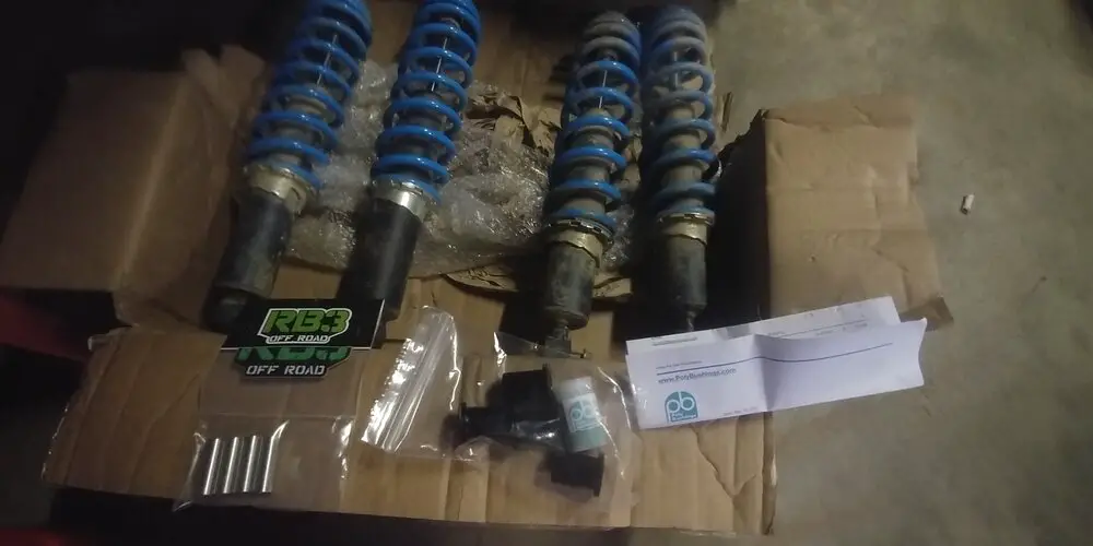

0919200034
Nessie's getting new legs! Can't wait to feel the difference.
