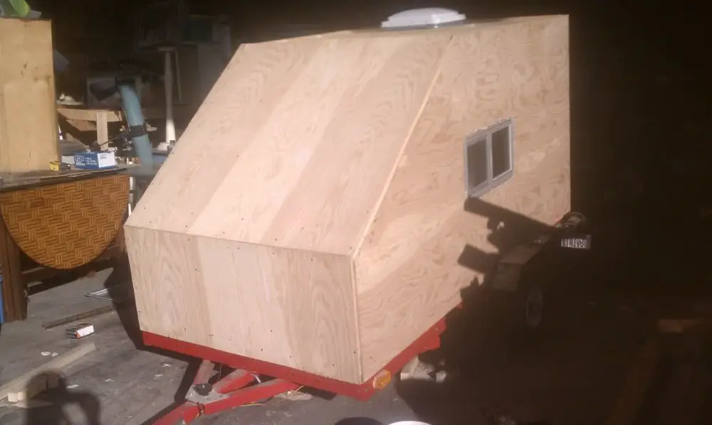

What are you skinning the box with mopar?
I'll be sanding it and priming it then painting it with rustoleum industrial enamel. It's oil based and thick enough to fill in the wood grain. A couple coats and sanding in between it will look just like fiberglass. The bottom side will be some kind of oil based sealer then undercoating.

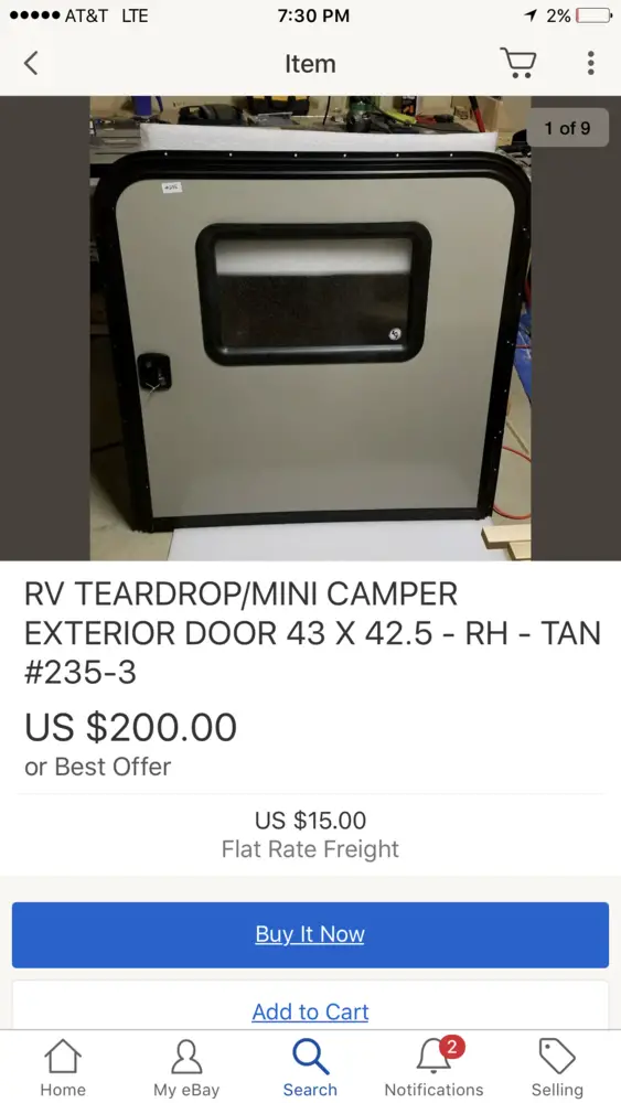

322,956
Mopar I got windows for the bus on eBay and it was under a grand shipped for 10 and they are big double pane. If you really watch they will be cheap

322,956
IMG 7605
@Shadesmn ill really suggest staying away from Rv dealers. Everything I tried to buy through them was 5-10 times in price and I bought a lot! It wasn't funny and no selection. If it can't be found on eBay it's being typed in wrong.
34,174
Wow, that's a great price. Looks like you need to charge your device.

Well, mama talked me into leaving it a box, it's 1 inch shorter than the Pioneer is at its current height, leaving me a little more storage space. I think it's going to shape up nicely. I should have a roof and front/rear on it this week sometime. I need to source windows so I can get them cut in. Let's hear opinions guys

Aerodynamic too! Have you come up with a plan?
Still looking in to roof top type camper, trying to keep the weight down as much as possible, when the kids were little we had an Apache fold out camper, instead of canvas they had fold out plastic sides, worked great against wind and rain and now I'm thinking keeping out the critters.
