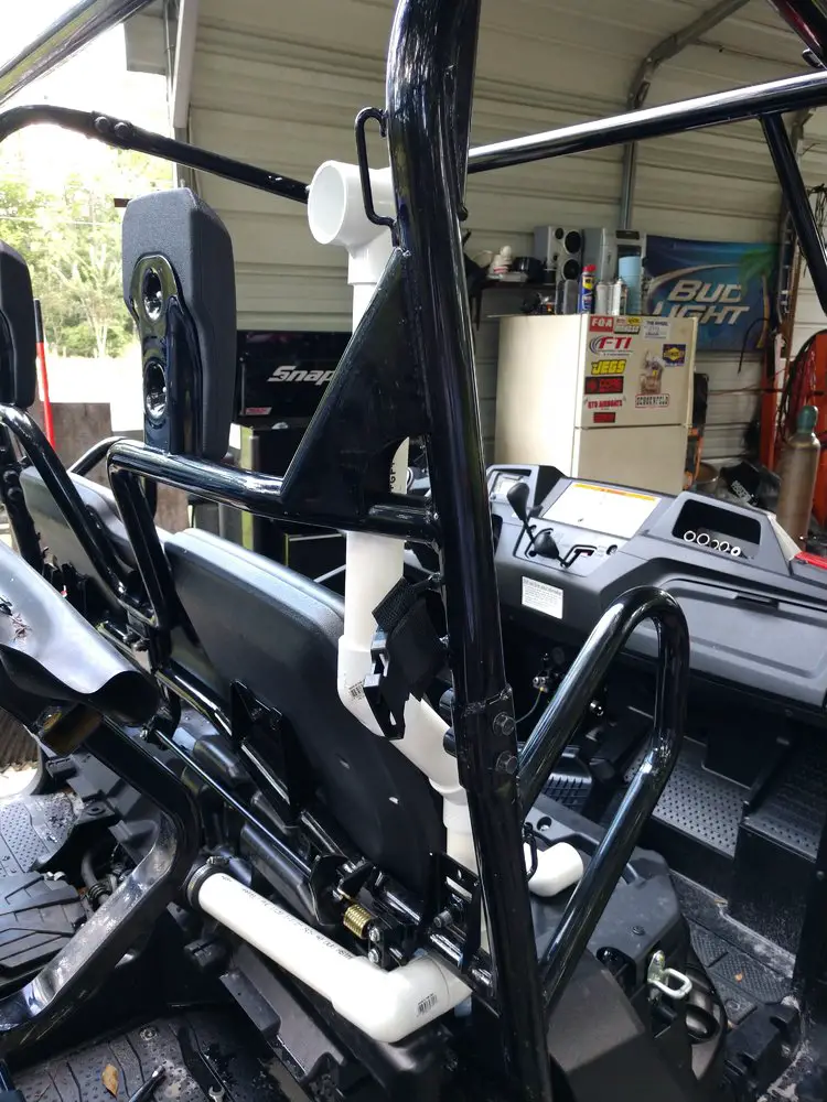

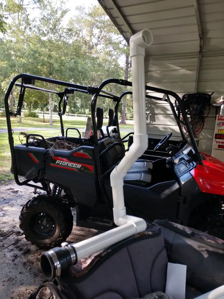

Just moved mocked up a snorkel using 1 1/2 PVC people are thinking it's two small and I should use 2". Just wanted to confirm the 1 1/2 is still working ok for you

Just moved mocked up a snorkel using 1 1/2 PVC people are thinking it's two small and I should use 2". Just wanted to confirm the 1 1/2 is still working ok for youView attachment 78091 View attachment 78092
Yes it did. Never had any issues with it who whole time I ran it. (Maybe like 1/2 a year). I ended up taking it off and routing a new one under my hood to cut down on the intake noise.
