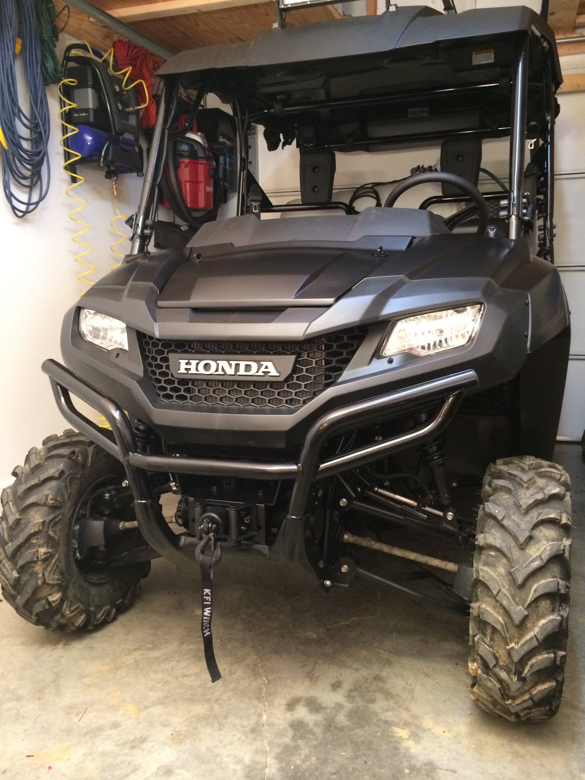

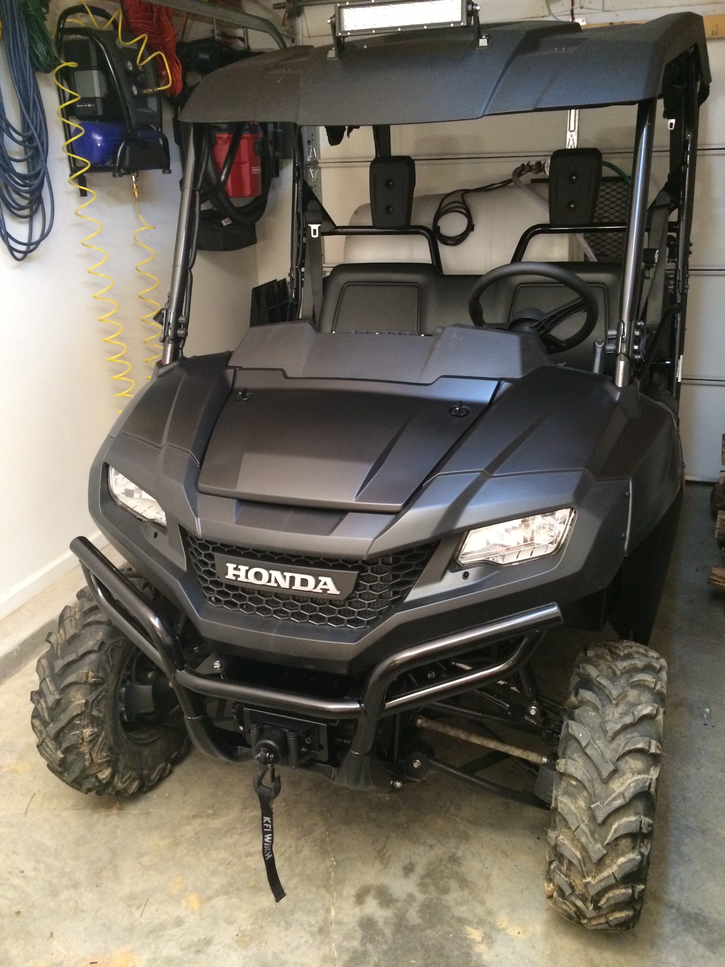

Well the Lift is on
ImageUploadedByTapatalk1432438765523632
Red is temp, powdercoater was on vacation last week and I wanted my lift for Memorial Day.
ImageUploadedByTapatalk1432438838796240
Real clearance with settled suspension after I dropped it off the Jack.
ImageUploadedByTapatalk1432438874117245
Unsettled suspension so I can say I have more clearance online and sound cooler. Didn't have a bucket or I would have lifted it up and sat it on the bucket.
ImageUploadedByTapatalk1432439324141928
Original settled suspension clearance with 2.5" StrongMade lift.

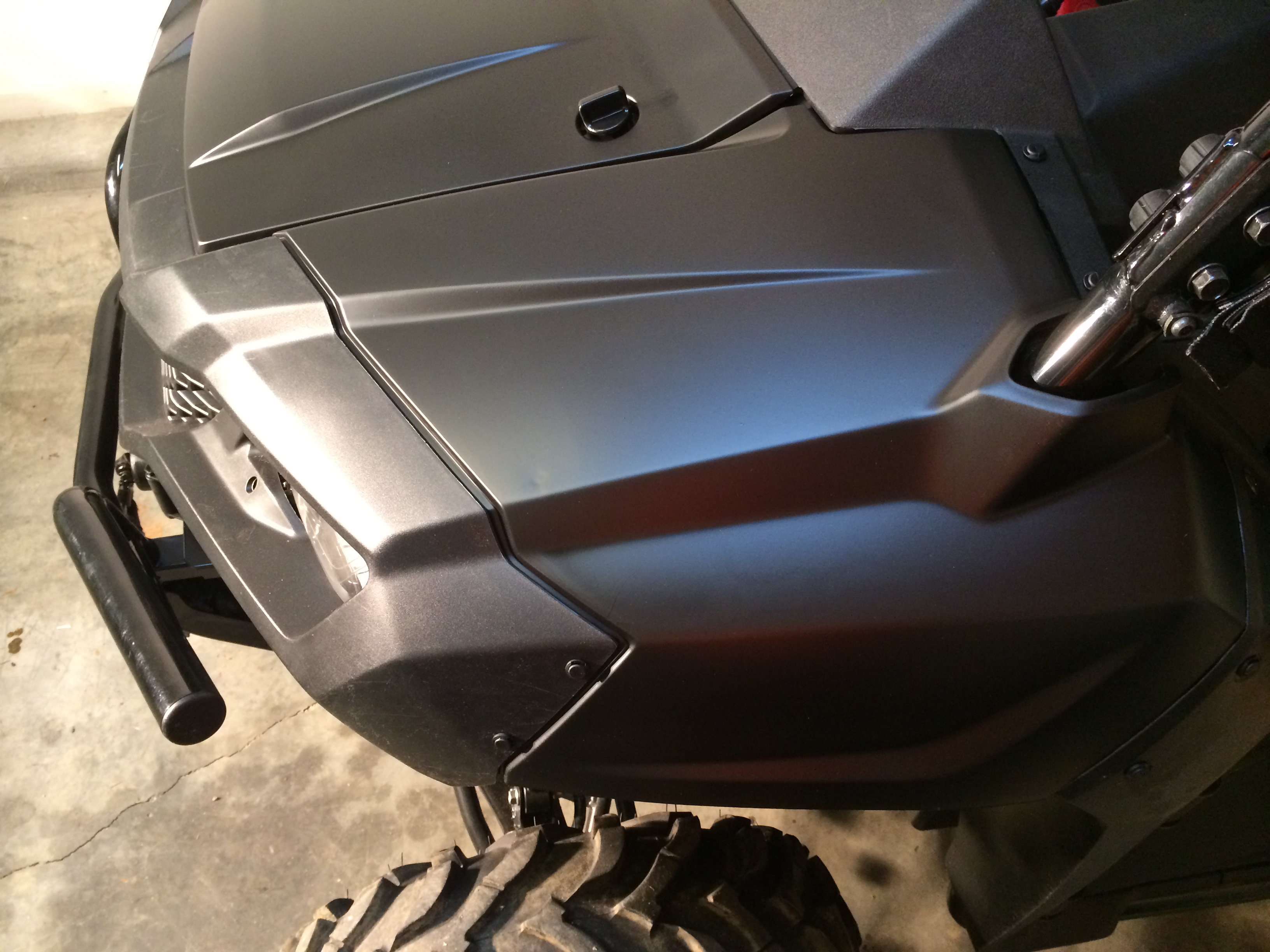

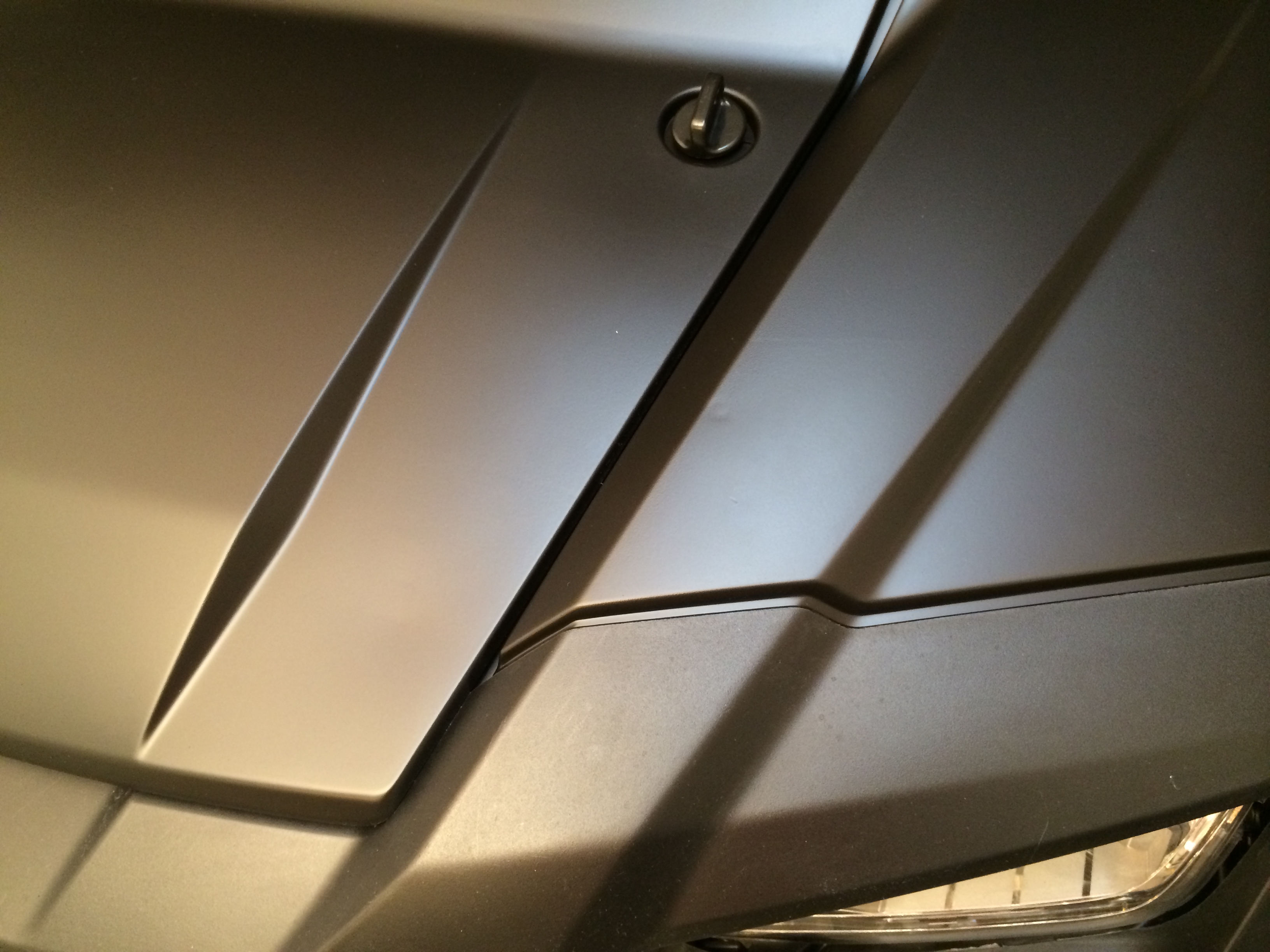

Ya, Dont do Rhino liner. I did my racks one time. Through it made for a good texture it faded over time was more a dark gray when I sold it. Plus it was a *itch to redo.
They make a product called Engine black that I use to detail Harley's and other custom motorcycles that works well to re-blacken engine parts that start to get grey over time. I used it on my trucks bed liner before I sold it and they thought the liner was new.
32,051
hey man how is the plastidip holding up after so long? have the trees pretty well ate it? im gonna do mine this weekend if it is still going good. let me know! thanks boss
Sold it a little over a year ago, saw it pop up on the HondaSxs Facebook page a week or two ago.
Still looks pretty good. You HAVE TO DO several coats to get a good thickness or it will get shredded.
