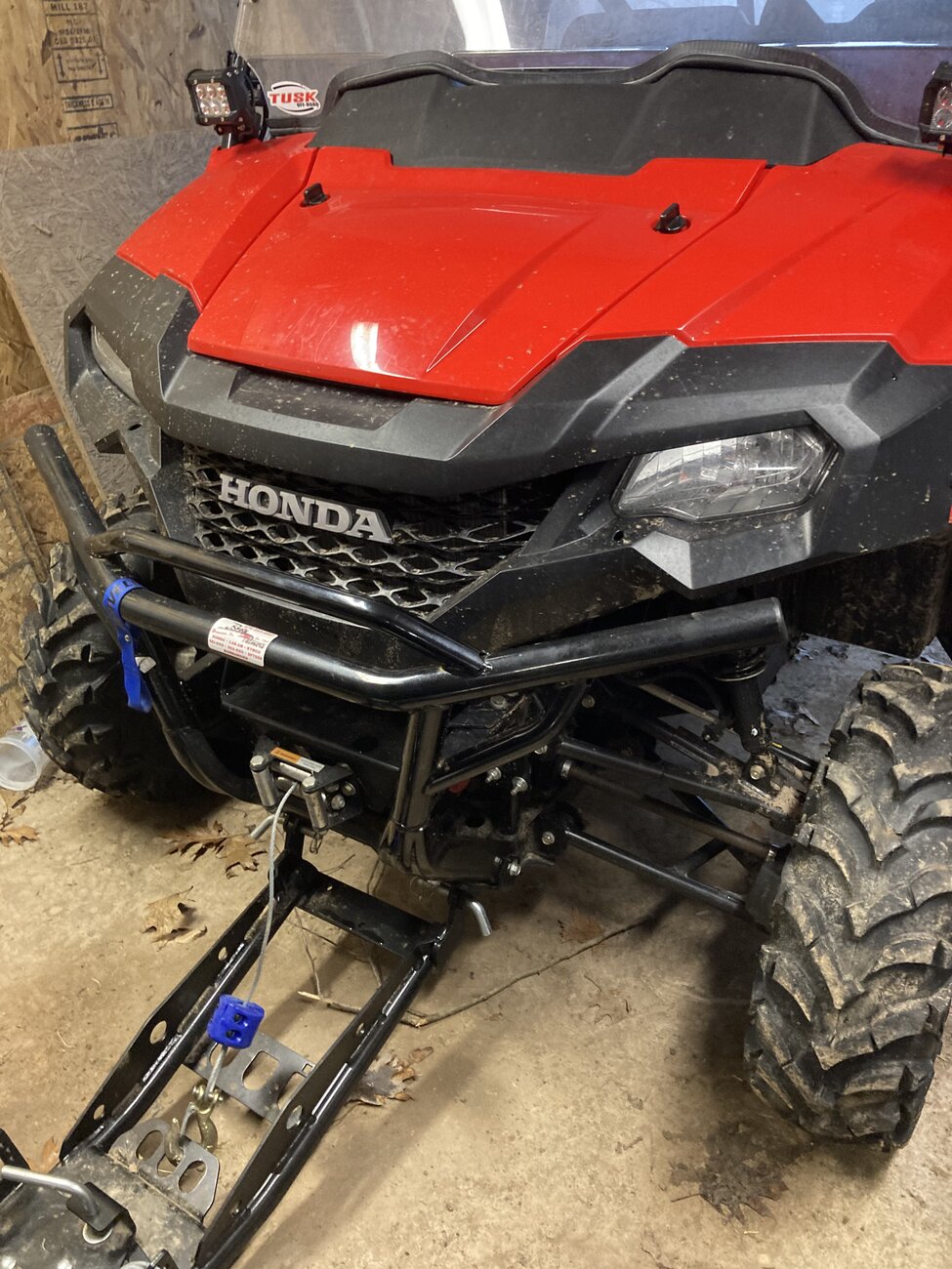

I have a 2018 pioneer 700 with 72 inch KFI plow and I have issues with it digging in changed angles even purchased different frame from KFI tried setting feet lower is 72 too big I also have 08 rhino 450 has a 66 inch plows great. Plus this UTV shifts very hard like your going to break handle and low battery love Honda's also have rubicon and rancher any advice

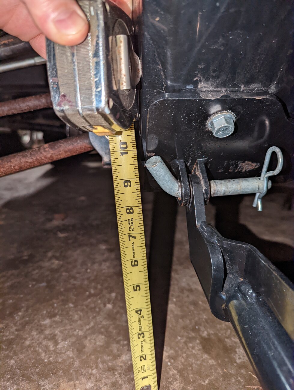

a picture of your set up may help especially from the side between the blade and the pioneer.

I don't have a lot of tension on mine, and it take a lot to trip the blade. I'm thinking the push frame is at a steep angle instead of parallel with the ground. I also do not use the skids but mostly concrete. hope he post a pic. to get a better idea

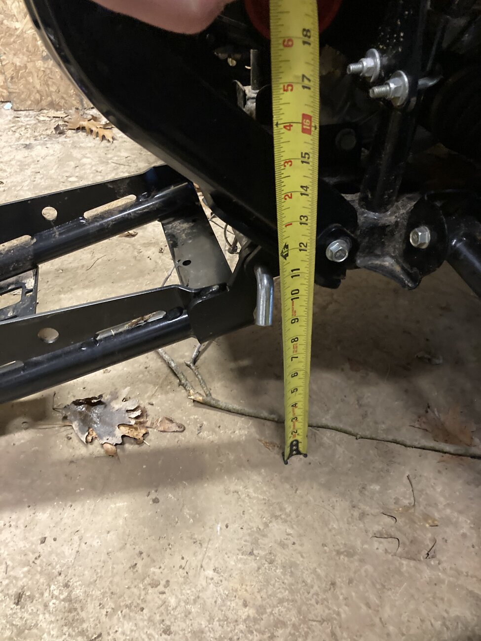

30A2AF9D 5591 45FA 81D3 A4701E4D9173 B8895646 24DA 4CB1 BF99 06F4A05AE14C 598DAD8E 6BEE 453F 89DE 878DE75A5E9A

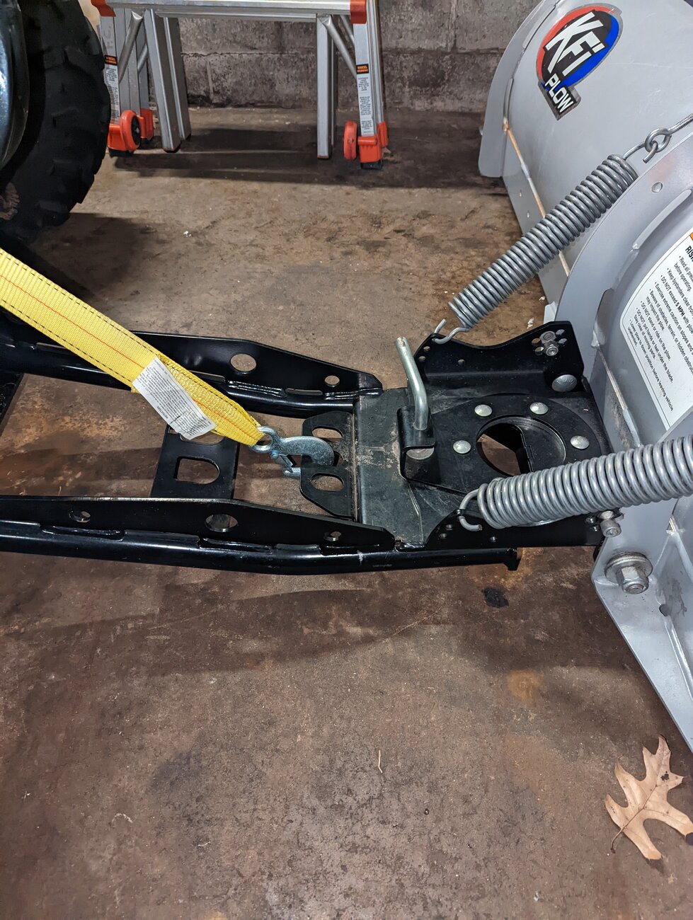

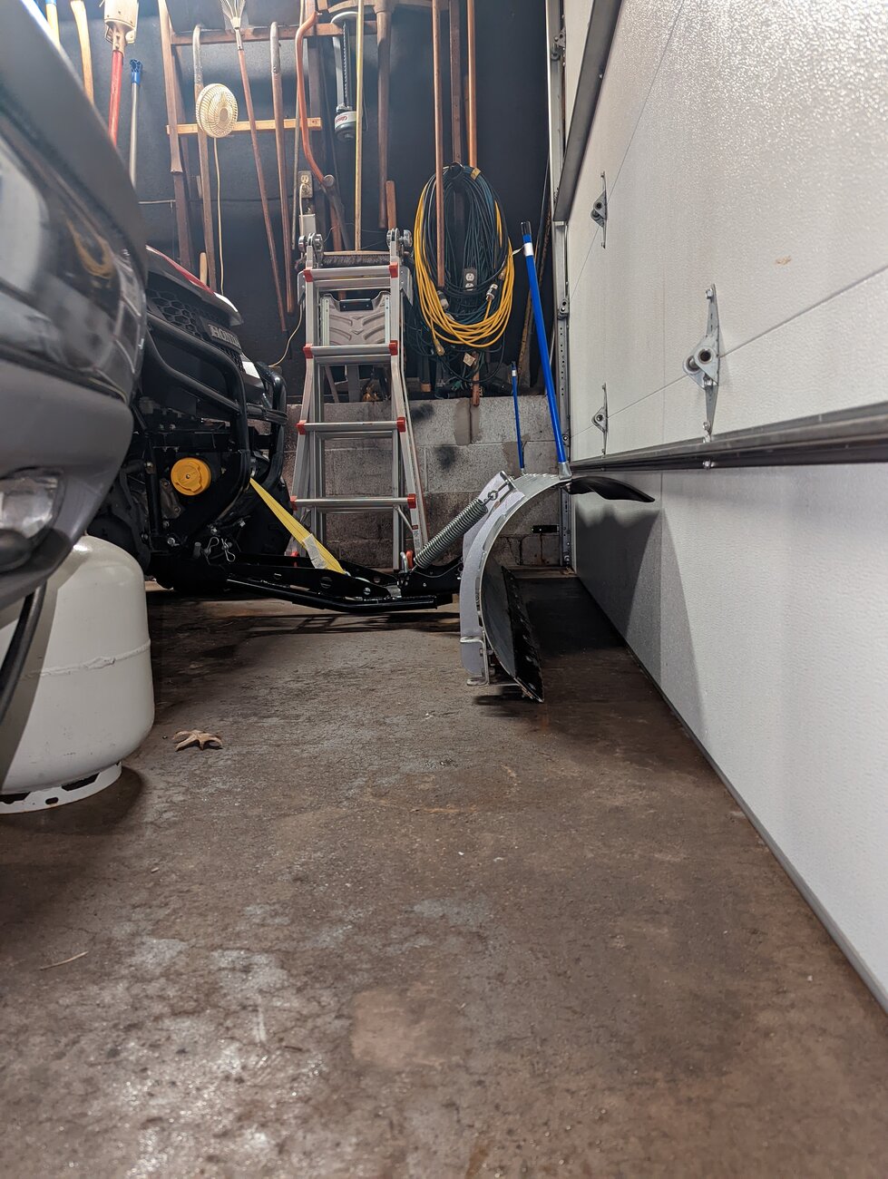

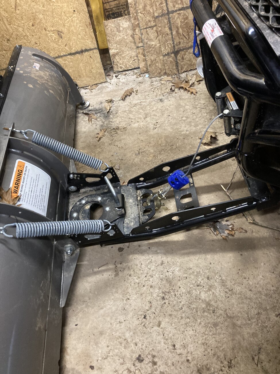

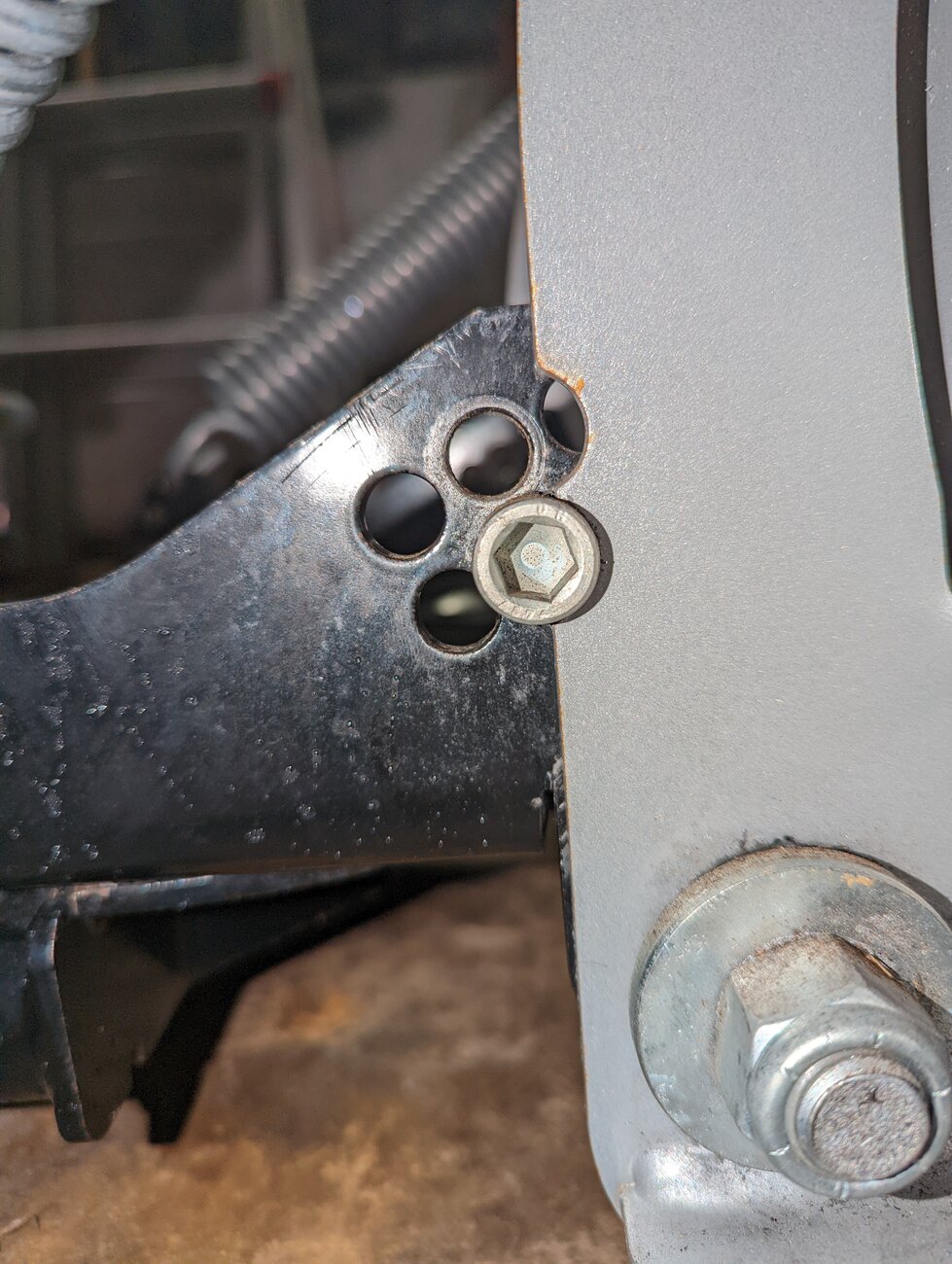

Looks like you have the same setup I do. Only thing I see different is your push frame is higher than mine. But it looks like your plow is leaning forward to much. There are 4 holes where the plow attaches to the push frame and yours is in the forward most position which I think is the problem. Pull the 2 bolts and rock the blade back so it's more vertical.View attachment 320636View attachment 320637 View attachment 320638 View attachment 320639
Sorry looks like 5 holes
Reactions: Smitty335 and ChadD

the blade is leaning to far forward which is why it trips so easy. mine will almost stop the sxs if going slow before it will trip. I'm sure after you relocate that to a more vertical position you will be happy with your plow. keep me posted.

I would probably go 1 hole farther back than where mine is set for a starting point because your mount point is a little higher than mine

Looks to me your attack angle is way off.Your blade should be back more at the top your feet should be almost flat to the surface with the blade down.But if you get the blade to stand up more looks like your springs are going to be to long.Are they stock for the blade.As for the shifting i have no idea.
