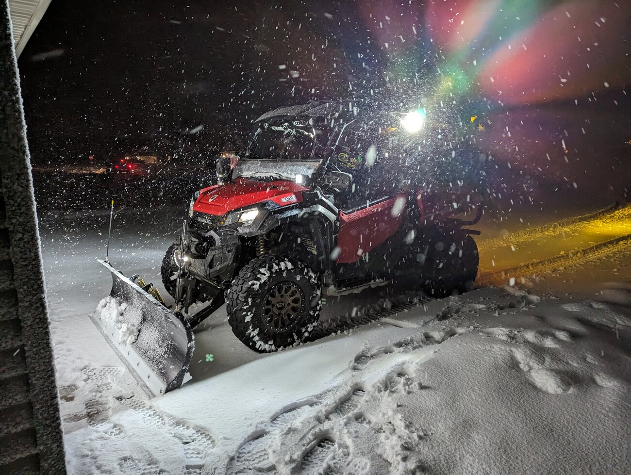

Does anyone else run carbide cutting edges

Actually I'm thinking of going the other direction and adding some rubber matting to the bottom of my snowplow.

The only pavement I have is the seal coat road I push snow across everything else is gravel grass pasture corn fields
The original cut edge was almost wore out in in under 2 years

I use 1/2" UHMW. It gets down to bare concrete and it way quieter.
I also have powered down force with my linear actuator set up and the UHMW pulls while backing very well.

The local plastic supply place sold me a 3"x72"x1/2" UHMW drop for $25. That was way cheaper than the steel replacement blade edge
