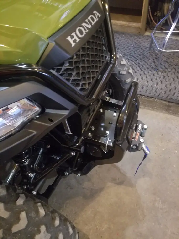

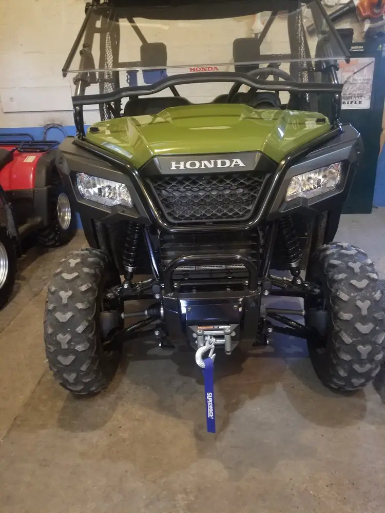

P500 Post your front bumper/winch mount pics.
Do any of you guys with the Strong Made front bumper have any issues with it running hot?I live in a very rugged and steep terrain so I'm going slow most of the time..Im worried about how much air flow I will have with that bumper and winch.Looking at some of the pics it looks like it blocks a lot of the radiator. Any feed back would be appreciated. Thanks!
I’ve had no problems with mine and it’s been on for 4 years. Love it.
Ga summer heat hits 100, no overheating due to strongmade and top winch mount in 3 yrs. Only overheat was due to soupy mud during Takeover ride, (now have the 12 v sprayer for long rides).

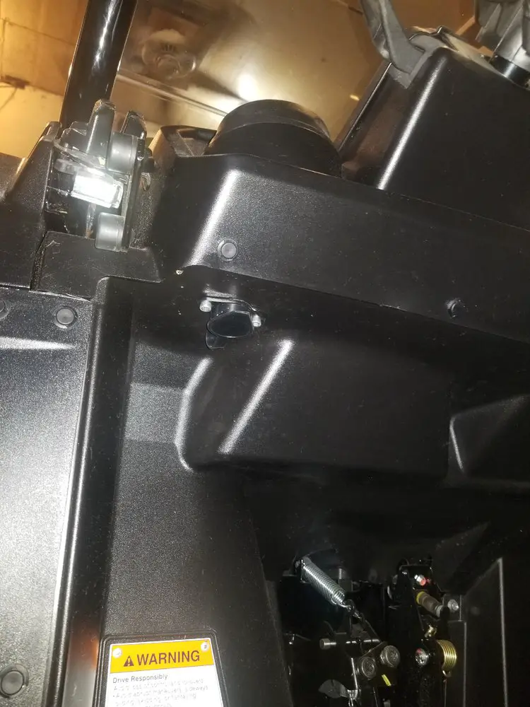

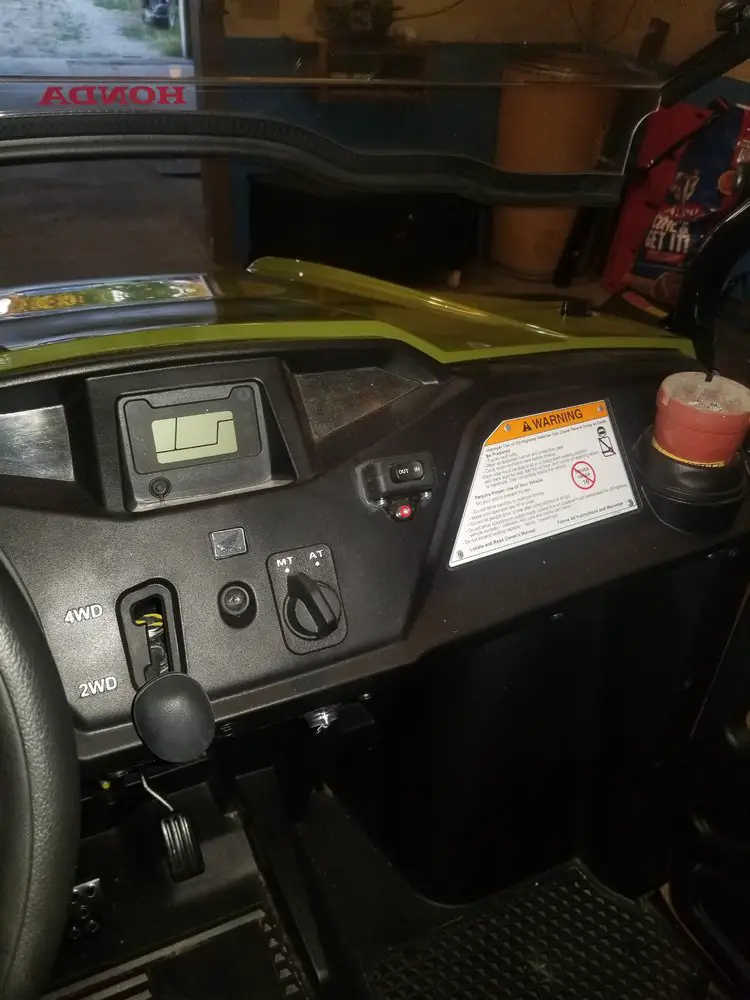

How did you secure the rocker switch to the dash?
The toggle switch that came with the superwinch has two mounting holes through it. Remove cup holder, with the hood off you will be able to reach behind cup holder location to get to nuts on back of machine screws.
WinchToggle
This would also be a great time to upgrade your cup holders to a more useable size like those sold for boats. There are several posts on this forum for the how toos, but basically remove old cup holder, enlarge the hole to fit the new larger cup hole and press in place, I used a clear silicone caulk when I reinstalled cup holder to help hold the boat cup holder in place.
