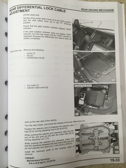

There is an adjustment under the bed on the drivers side.

I copied this pic from an earlier post. Let me see if it can link it.

I've seen that posted before, but can't find any causation regarding Park being related to mode selector?
If you have the cable adjustment box open, you can see that moving the drive selector will move those cables. Mine did the same thing and I adjusted the cables to fix it.
Of coarse moving the mode selector will also move those cables. I'm not sure why they are together, but they are.
Reactions: DGann
39,129
Another thing that I need to check to be sure, but I think the only sensor for the rear diff is actually in the rear diff. I don't believe there is another switch or sensor anywhere else.

I think the purpose of the cable adjustment box behind the drivers seat is to make the rear diff lock engage when in park.
@Hondasxs posted a patent a while ago that says this (just because a patent exists doesn't mean those parts are on the vehicle but it dose look like it in this case).
This box has cables from both levers on the dash coming in to it.
When it is adjusted correctly either cable can engage the diff lock.
The springs in the box allow for both cables to try and engage the lock at the same time with out problems.
Link to that post:
Arrangement of a vehicle assembly member - Patent 9346352
FYI, the rear lock mechanism is a spring loaded lost motion device - when you pull the cable a spring is trying to engage the lock.
The lock may not engage right away, the parts need to align correctly then it will snap in.
Apparently when you have a brake on the prop shaft the wheels might counter rotate threw the differential.
This arrangement should prevent that from happening.
The P500 and P700 have a single brake disk / parking brake on the prop shaft but no differential.

Ya. just went out and played around with the P1, and it engages no problem. Issue I have figured out is it is not releasing unless I turn hard in reverse both Left and Right at a slow speed. When it finally does release, it pops pretty loud - which is obviously the collar sliding back. I am going to adjust in accordance with the manual and see if this quiets down the pop when the collar releases back to turf mode. I realize you are supposed to shift mode selector at 0mph, which I do, but it requires mechanical force to release the collar or sleeve by reversing and turning on mine at the moment.
