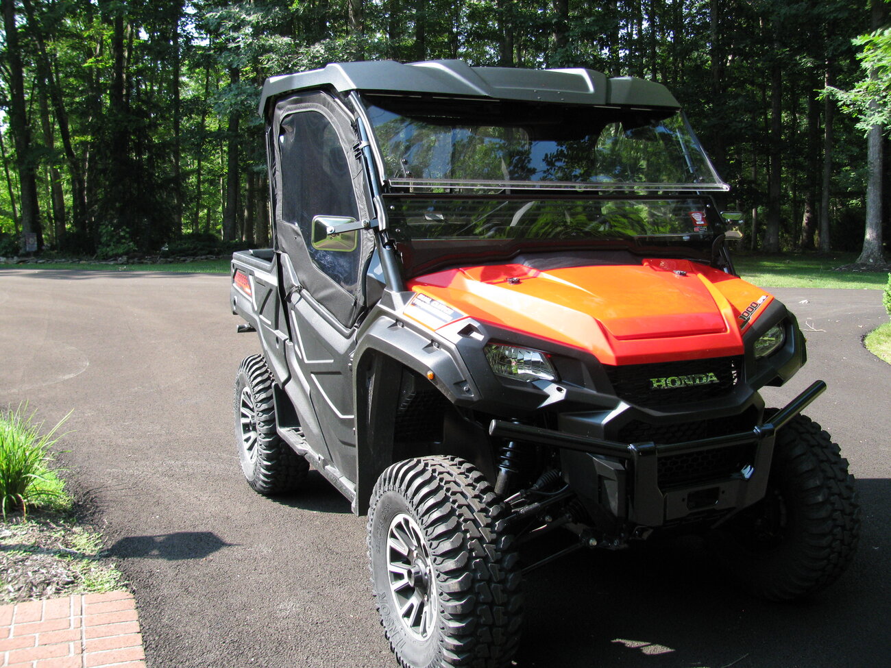

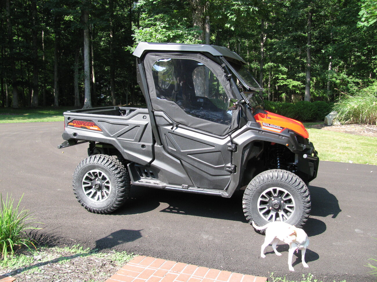

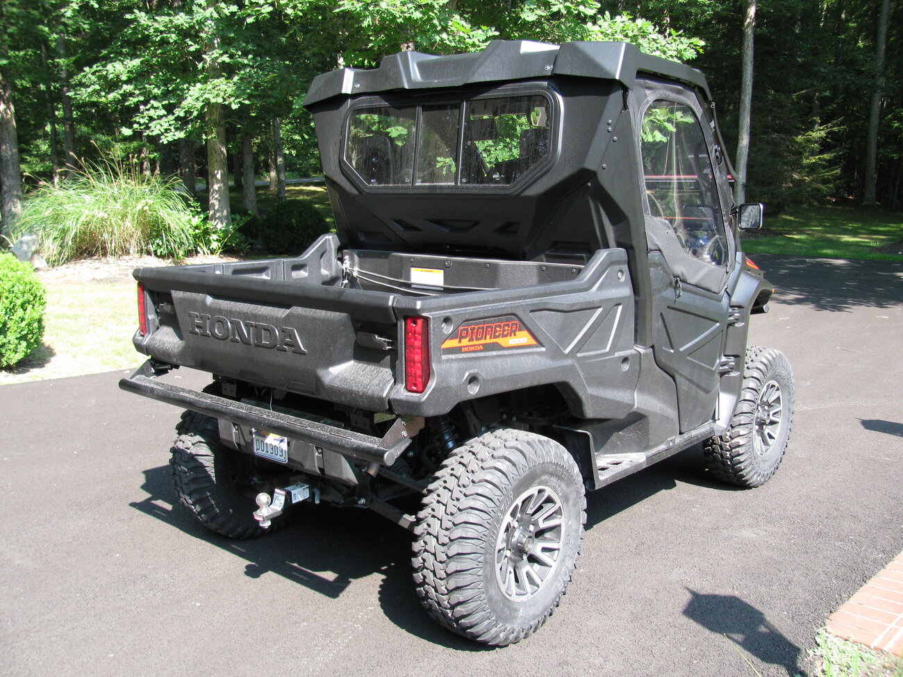

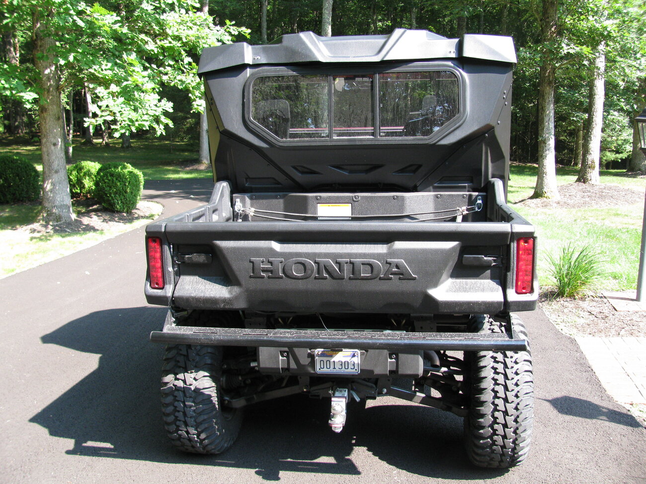

I have a set of four 28" x 10" x 14" Tensor Regulators on my Pioneer 1000-3 mounted on a set of Honda Pioneer LE 14" aluminum wheels. I use a pair of 1" spacers on the rear.
I take no credit for deciding on the combo I'm using. My choices were based on the advice of a dozen or more members and reading 100 or more posts on the subject.
The tires fit without interference with any body part, are quiet compared to the terrible OEM 12" tires, and the gearing change caused by the tires is not perceptible to the driver.
In summary - the tires and wheels are exactly what I wanted with no negative consequences.

Thanks for the info HBarlow, good to hear that fitting 28" tires shouldn't be an issue. Also, great looking machine.
