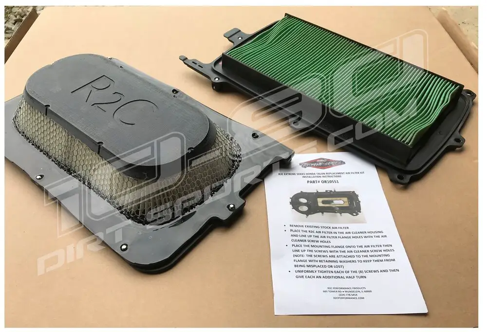

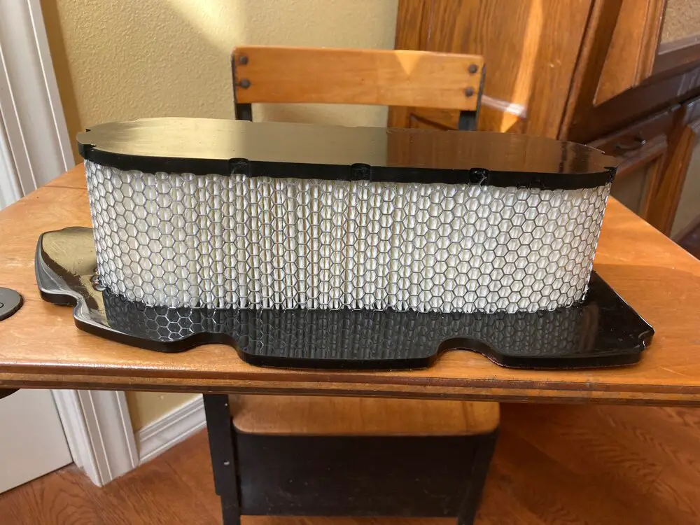

Why does this look physically different? Is that one for the Pioneer?
The Talon and Pioneer 1000 use 2 totally different filters. The attached picture here a comparison of the R2C and OEM filters for the Talon.
The pic that Smitty posted is the brand new Pionner 1000 filter.
The pic that Smitty posted is the brand new Pioneer 1000 filter.

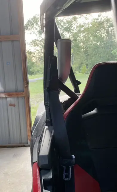

I have an aluminum snorkel pipe prototype nearly complete on my talon. Waiting on the air filter to finalize the height and trim pipe and also to set a bracing bracket location. The good news is I've been able to successfully make the entire snorkel a one piece welded pipe. And it can be easily installed through the grate opening with the OEM grate removed. A coworker and I are working on a replacement grate also. We are trying to make a 2 piece grate that will wrap around the pipe penetration after the pipe is in place.
The prototype pipe has 6 welds! Now that I have the routing figured out, I may be able to reduce that to 4 welds, maybe 3 if I'm very creative on fitting use.
Once I get the filter and brace in place I'll post some pics. I think it looks great because it closely follows the lines of the roll cage. Once painted black the pipe will almost disappear. I'll attach one sneak peak pic for now.

It may work with the windshield. It will be close though! I'll send more photos once I have the filter mounted.
This would be a good time to make adjustments, I'd bet 1/3 of us have a rear window. Otherwise you'll need two models.

The good thing is that since I didn't have the filter yet, the top part of the intake is only tacked up right now. Does the rear window fit flush wit the back of the roll cage like SuperATV pics show? If so then that's not bad. If it sticks out any they I'll need some pics and measurements from someone.
