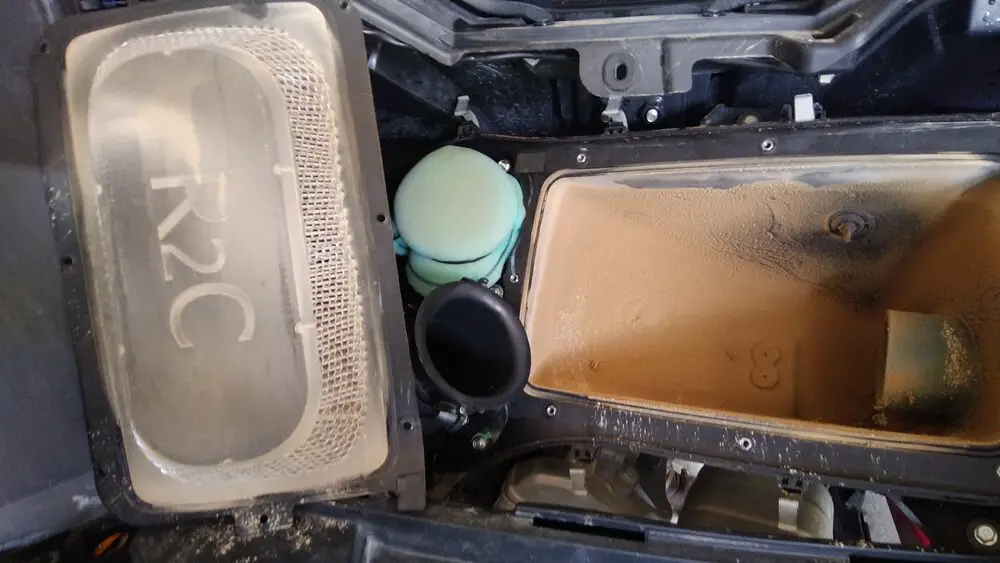

And the result is supreme filtration to say the least. I rode in the the most dusty ride I ever had ridden in and some of the freshly graded surface was like a powder, only place worse would maybe the desert. My intake tubes were squeaky clean as compared to the dirt filled air box as seen in the pic. I covered the intake tubes with the green UNI filter foam (lightly oiled) to catch any thing that got past the filter. After I cleaned the filter foam I could not find any evidence that anything got past. I cleaned the foam in a small clear glass container so I could see any debris. As always I oiled the inside of the air box to collect dirt and aid in extending the run time of the filter,

I found it easy to get it squeaky clean. First I blew it out from the inside with low pressure air, there was a lot of dust in it and I took my time till I saw no more dust blowing out of the fiber. I then sprayed mild soap inside and out soaking it down good and let it sit for a few. I rinsed it well with water from the inside out at first until I saw no dark water then I rinsed all over and both sides. I fiddled with it for maybe 20 minutes or so and I gave it 24 hours dry time. I think putting it in a dish washer would work really well also.

With the r2c filter it sets down low in the air box unlike the OEM filter that lays flat leaving a open area for the uni. The r2c leaves little gap for the uni to mount I doubt it will fit in there with the r2c.
Here is a install tip: You set the filter in the box and then the hold down plate goes on top of the filter and you struggle to align the screw holes up thru the plate and the rubber sealing flange to get a screw started. I always oil the sealing surface where the filter mates up with the box for a good dust proof seal and that makes the thing slippery and even more of a hassle to get a screw started and or not cross threaded. Go and get 6 5mm screws the same thread pitch about a inch long minimum and cut the heads off. Screw the screws (now alignment studs) in the mounting holes just a little ways and now you can set the filter in place and put the hold down plate in place without fumbling around with it to align up the holes. What you now have are alignment studs that you made. Just remove one stud and install the hold down screw and do the others the same way one at a time no fuss no muss. You dont need a alignment screw in each hole just space them out evenly thus you only need 6.

My Honda dealer ordered the green uni filter foam for me. It comes in one piece about 18 inches square and you cut it to fit. I just ran a wire tie around the outside of the intake tube and snugged it up but not killer tight. I had to put two ties together to make the length I needed. Any air restriction from the foam is a non issue

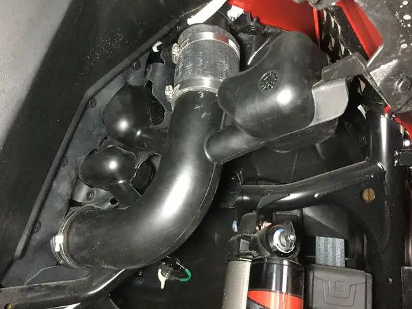

Installed the S&B Particulate Seperator and a R2C filter, Big difference in filtration. This is after 1900 miles

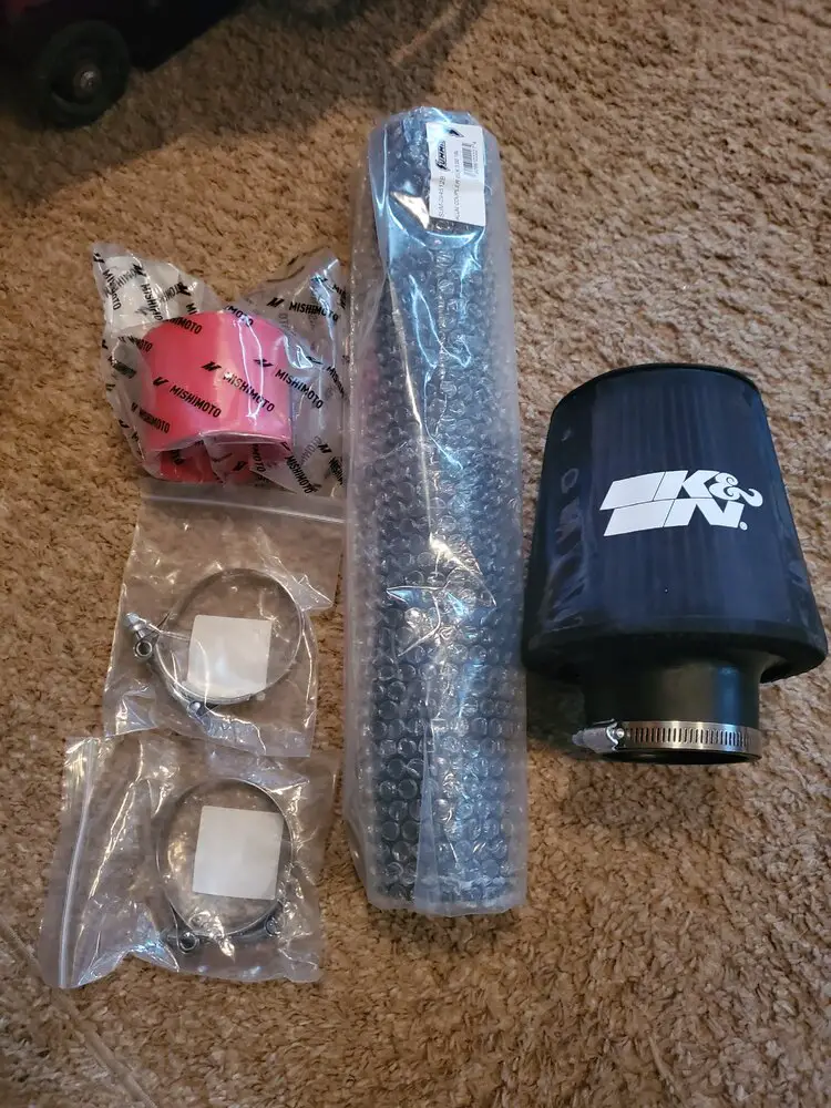

Could we have the part #s for the red and black tubes? What's the O.D. of the black tube?
Black 3" aluminum tube is just Summit brand turbo pipe. It was $16.99.
Red silicone 3" coupler and 3" band clamps are Misimoto, also from Summit Racing. Less than $25 for all 3 pieces if i remember correctly.
The only other piece I bought besides the filter was the outer cover.
One thing to note.... Im running the PwrTune intake tube on my airbox. Its aluminum and 3" diameter. I cant say if the plastic s*** I took off is the same 3" size. I didn't bother measuring it and that tube is long gone.

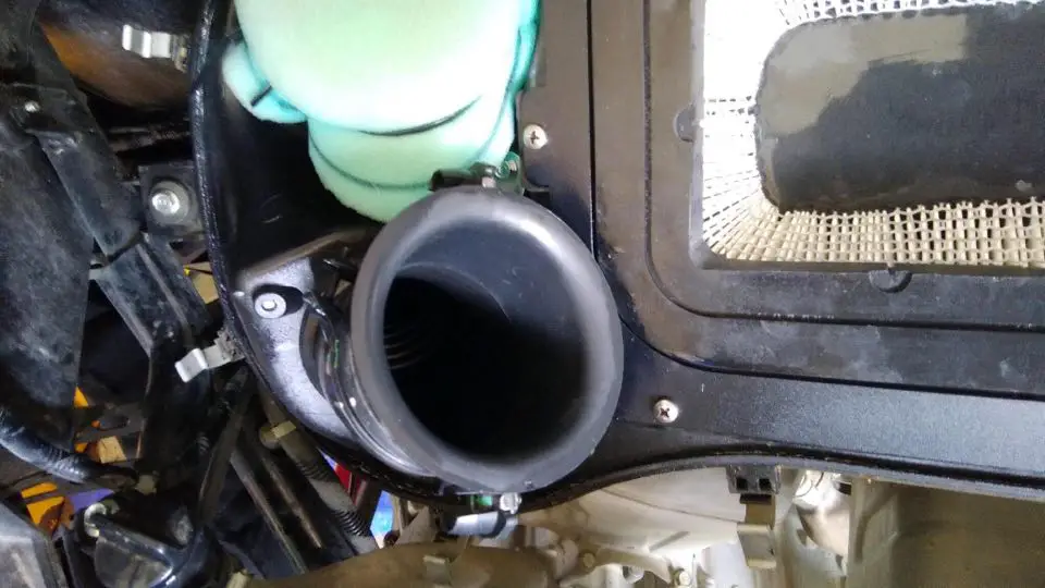

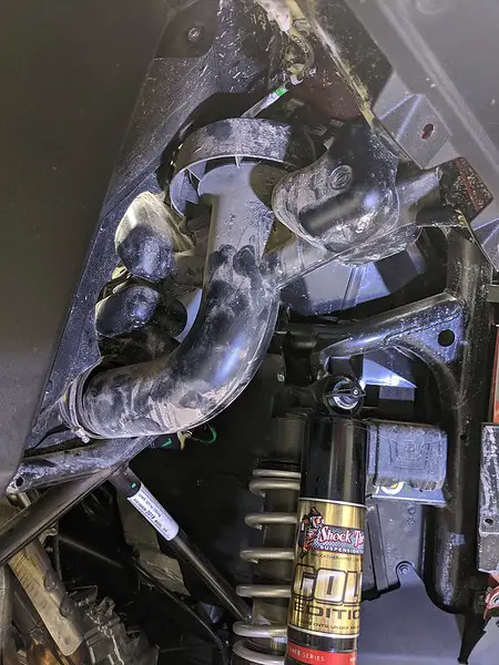

Are you going to use HondaBob's idea and keep the stock intake chamber? It's very close to 3" O.D. once the intake air horn is trimmed down (right under the 'hat').
The air horn is visible here - (photo thx to Lil_Steve)
I JxZSRKM L
Trimmed results in this -
I 7HPhcsr M
